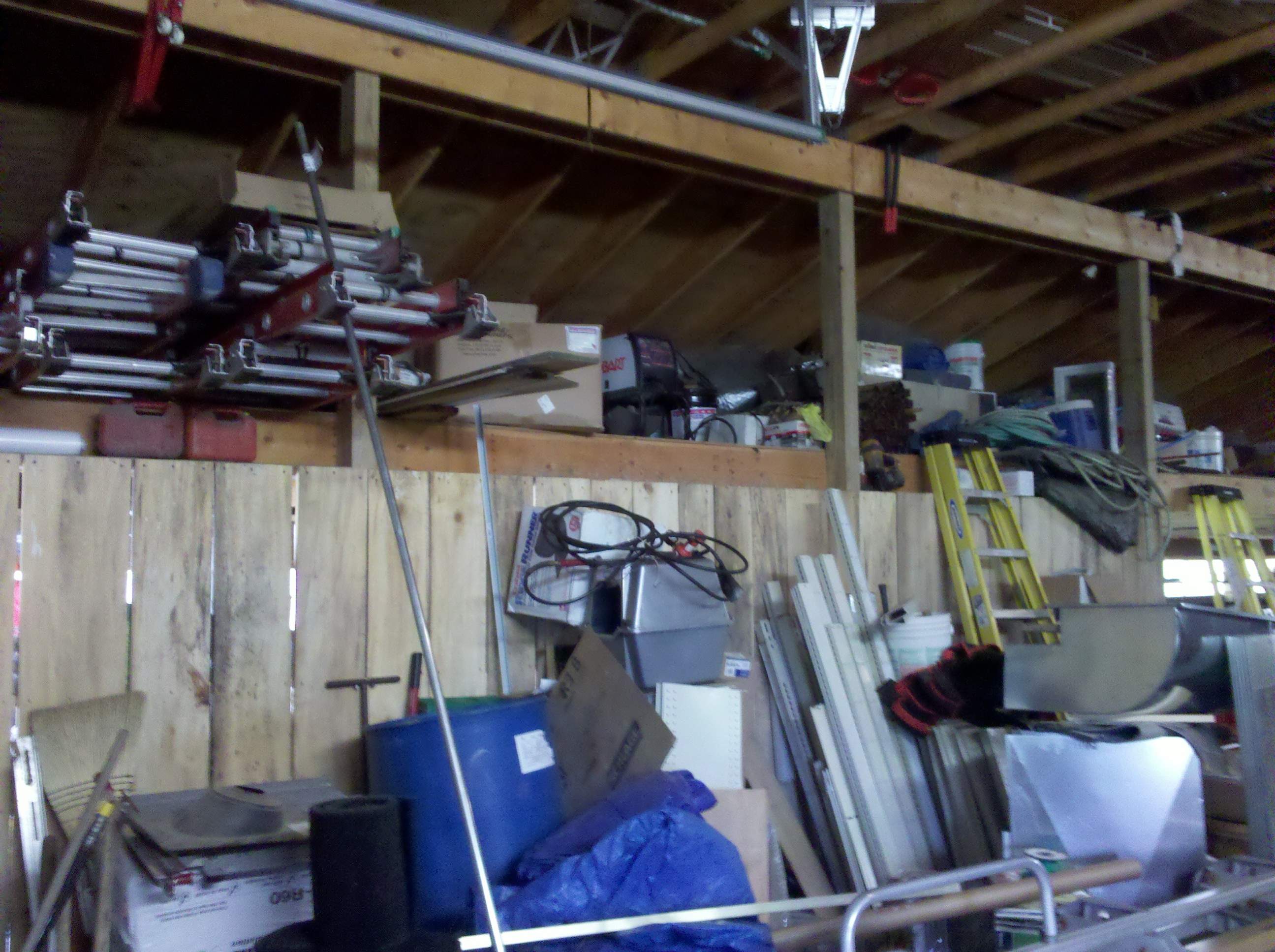

We built a loft in our barn, its a two tier barn because of the amount of slope in the ground. The top section is 24wide by 64 long, the bottom section is around 30" lower and is 16' wide by 64' long. The low side dropping down allowed us to build a loft that is easily accessed by the upper side. Its 8' off the floor on the upper section and just attaches to the 4x6 posts that run the length of the interior wall seperating the two sections. The 4x6 is plenty strong enough and we used 2x8's for the loft joists with 3/4" plywood for the deck. We store all the ladders and all our long stock up there as well as anything else we don't need very often. The 4x6's are set every 8' and not only support the loft but also support the 24' and 16' sections roof as from the outside the roof line ties together seamlessly. Just put concrete in the hole first to give a pad for the post to sit on so it can't sink.
   / Building a hay loft inside the pole barn #4
Here are some pics of the loft we built. One is from the upper side, another from the low side under the loft and the other is from the outside showing the change in elevation.
