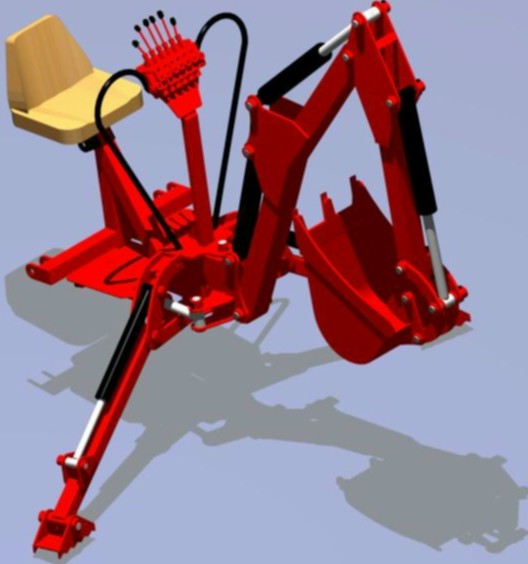

I am currently building a backhoe for the front of my PT-1445. The people that cut out most of the parts in the kit recommend 1/4 inch thick wall tubing, but I am going to use 3/16 seamless steel tubing. I also extended the reach on both legs for more reach. but now I have to get the cylinders to match the extra length. I bought one 12" bucket from Ebay, and made the 6" and the 12" from the kit. The kit is very useful if you don't have access to a precision cutter , either plasma or laser for the smaller parts. They have the swing cylinder pushing and pulling from the back, and therefore, the swing is limited to 150 degrees either side. I am trying to figure out how to get the full 180 degree swing. I will post some pictures soon.
see cdp-backhoe.com

I would highly recommend that you use 1 inch grade 8 bolts, or 15/16 pin stock inside of thick wall bushings on all your pivot points. This will give you more support and surface area for wear, plus you can also put a grease fitting in the bushing.
bottom swing arm 28.5 in
next arm up 26.5 in
boom extension 29.0 in
