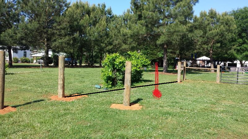

I am fencing in about an acre and I have a slightly irregular shape. I have set 54in telephone poles minimum of 9inches wide 3 feet deep in each corner. Each corner has 3 poles set in standard configuration with an 8ft 4-5in brace connecting the brace poles to the corner post. I have one corner post as marked in the picture that is about 30 feet from another corner that makes a quick 8 foot jump over (that I simply is wrapping around the corner to follow the contour) and then travels about 200 feet before the next major corner. Question is on the on the circled corner. I have the standard 3 post setup. do I need to add a 4th post and 8ft brace for that short 30 ft run or will the run be short enough to not add all that much pressure on the end post? I drew a blue line to show what I was wondering if I need to make.
Second question, the longer 500ft run (give or take) do I need to put in a H-brace of telephone poles somewhere along that run in the middle? I am using 6ft t-posts (goal is 18inches deep) to support the woven wire (4x4 sheep/goat mesh, 48in high) around the perimeter.

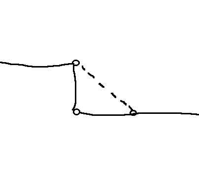

I have seen posts braced like this:
The dashed line is a tension wire between post tops. Put "X" tension wire between the two posts on the long run, as they can be pulled either way.

The fence will be containing lamancha goats. Below is the actual pic/landscape with my drawn in "do I need this post".

I would have done something like this (black line) instead of a corner:
   / building a fence, question on a tricky corner...
bcp, would have been easier and preferred, but then the goats might have been tempted to climb the fence and reach over to nibble on the grape vine that is growing there. That is why we did it the way we did with an 8 foot "lane". I also need to make sure that I could get between the fence and the vine to move with the tractor.

for the 30 foot I most likely would not worry about real corners, but you all ready have one in, might as well finish the other end too, it will not hurt you much, $25 probably at the most,
a lot just depends on how tight one stretches that fence section, if you basically just hold it up most likely no need, but if your going to have a stringed instrument when done you will need corners,
   / building a fence, question on a tricky corner... #8
I would add the post, no point worrying about it if you have to really stretch the wire. Do it and be done with it. I would also most certainly add an "H" brace in the middle of the 500' run, it will strengthen the run and shorten the repair "chain" if the fence gets damaged.
