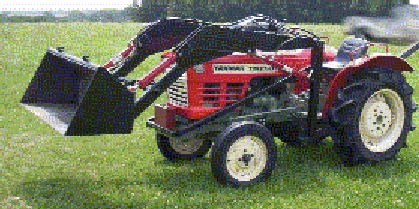

Just completed the CadPlan 501 model last fall. Super! I hadn't done any welding in many years, yet the finished product can handle stacking 1500# hay bales to the 2nd level on a trailer. I recommend CadPlans. Purchased the hyd. cyl. from Northern Tools, and the controls from MetKit.
Equipment required: loved the little mig welder for tacking, but the stick welder is a must for the heavy welds. By the time you are finished you'll know a lot more about running a bead. Used both 6011 and 7014. Need the metal cutting band saw, drill press, ½" drill (and bits) and at least 1 hand held grinder. I had both a 4½" & a 7" and both had their place.
MetKit can send you every thing you need all cut out. But to save a little money, and really feel like it is your project find a metal supplier that will work with you. A lot of them will help you out just because they think you are nuts!
If I were doing it over, I'd use standard 7/8" pins that you can buy at a farm supply instead of trying to make the 1" pins as proposed. Turned out to be a real pain.
Good Luck!

Hey, Adron nice loader. Pic is a little blurry though. I plan on making a new bucket for mine in the near future.
By the way what model is your tractor?

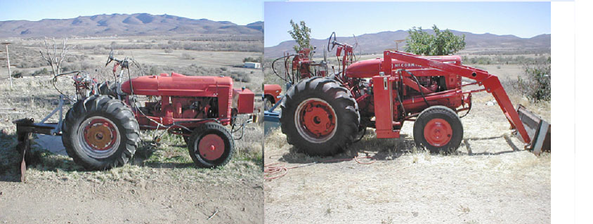

I built one and for me, it was a very satisfying project. I would also add I wouldn't want to do again very soon. Economically, it didn't save me any money but your situation may depend on availability of parts. I would also agree with those who recommend a kit, or consider modifications to a good used unit.
A few general things to consider if you get or fabricate a FEL: 1. Make sure it attaches to several points on your tractor to distribute the wear and tear inherent with loader use. 2. I added power steering to mine and you may regret not having it if you add a loader. And finally, 3. make sure the weight transfer does not make your tractor rear end so light, you can't move any kind of load in the bucket (it happens even on factory set ups). Good luck, be careful and have fun.

Sorry about the blurry pic. I was trying to stay under the size limitation on picture uploads. Anyway, it is a Yanmar YM2500 tractor, and a 1007 loader (not a 501 as I stated..whatever was I thinking). Thanks
