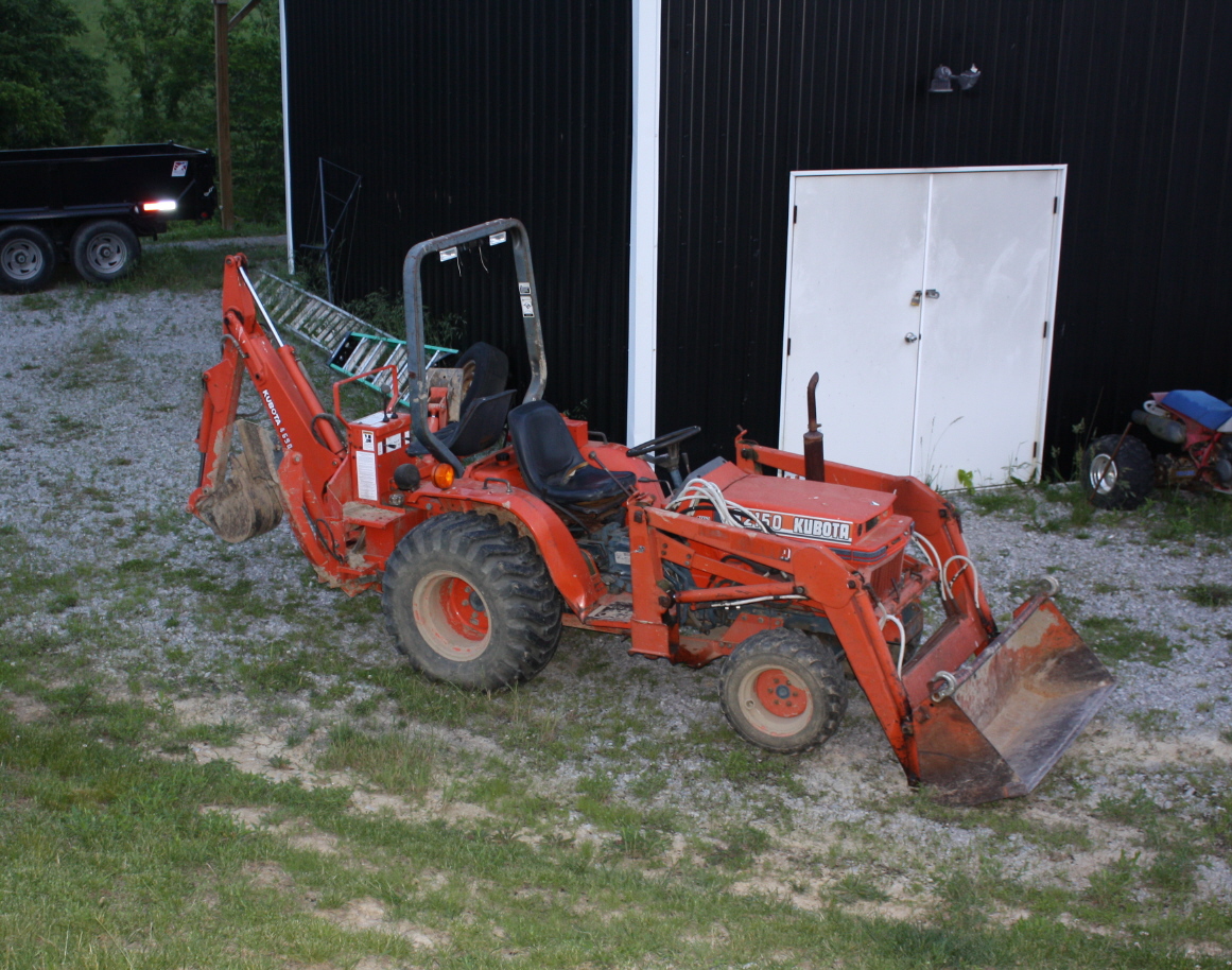

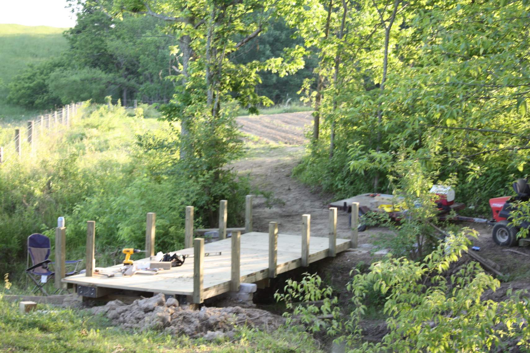

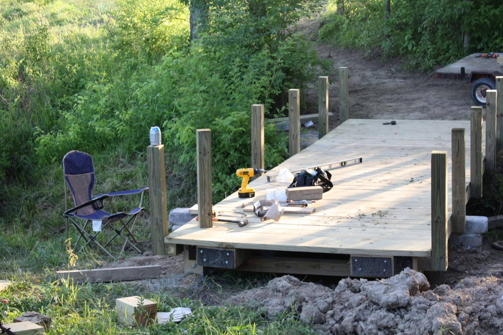

I'm in the process of building a wooden bridge to cross a small creek. The main goal was to make it strong enough to cross with my Kubota B-2150 with the backhoe attached. This is prob. overkill, but... it has 125, 60# bags of concrete in the main footers, plus two other beam supports. I used 2x6's for the slats, and four 6x6's for the main beams. It's 20 feet long, and 6 feet wide.

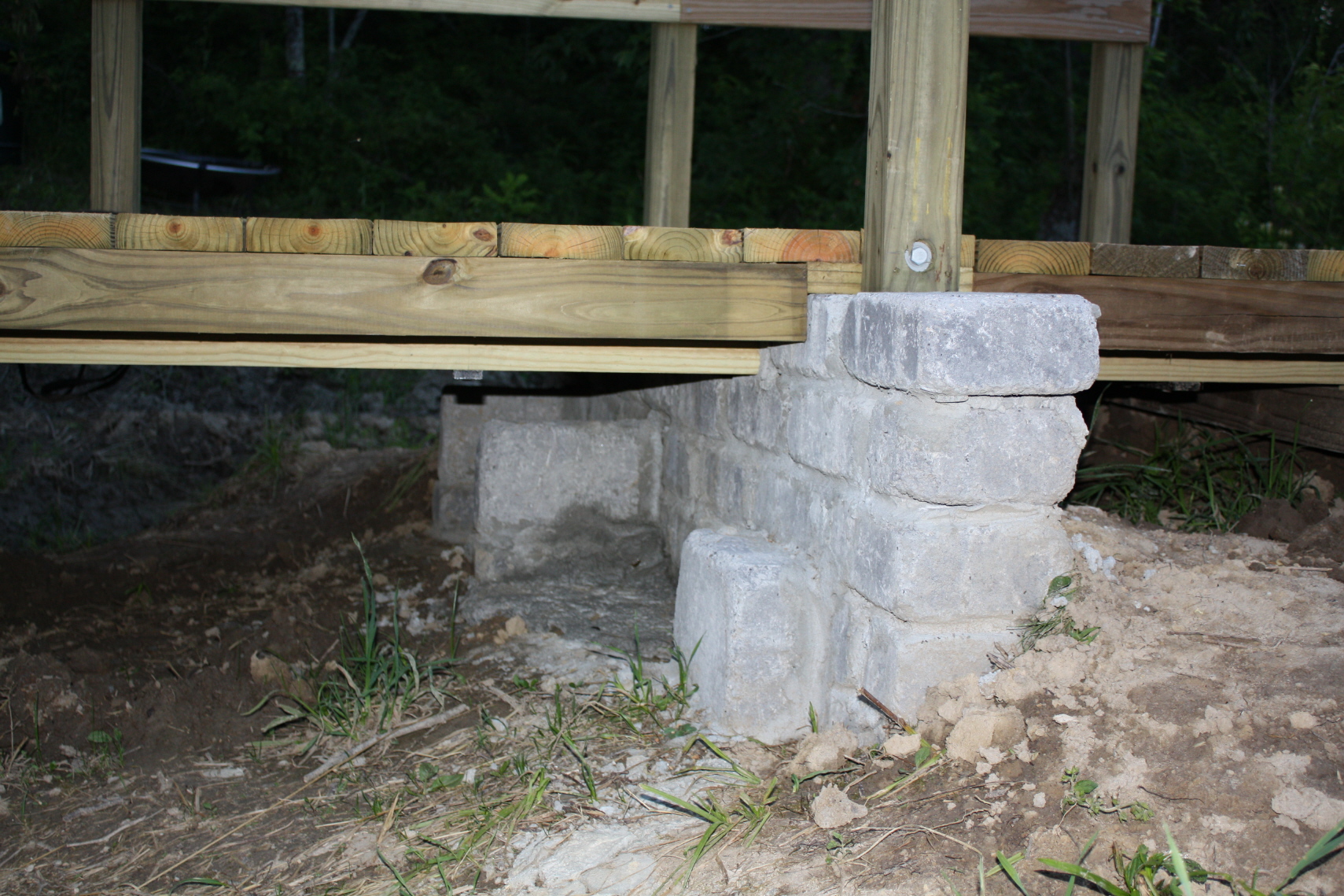

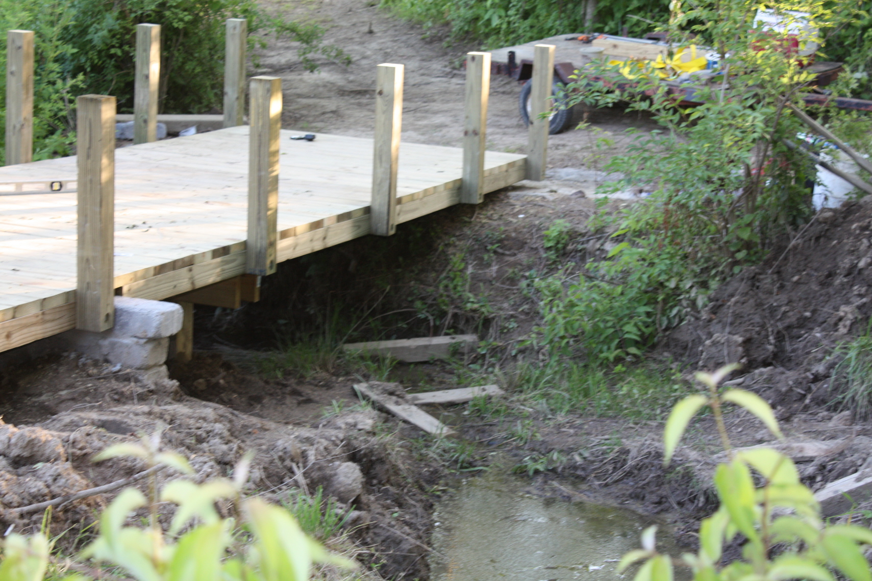

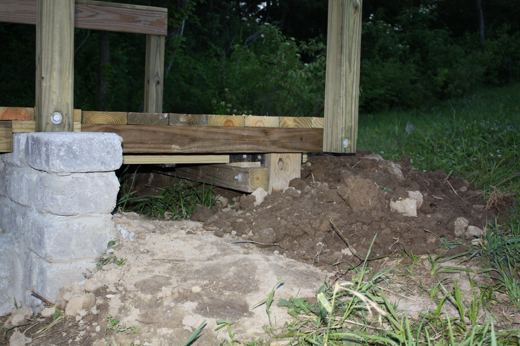

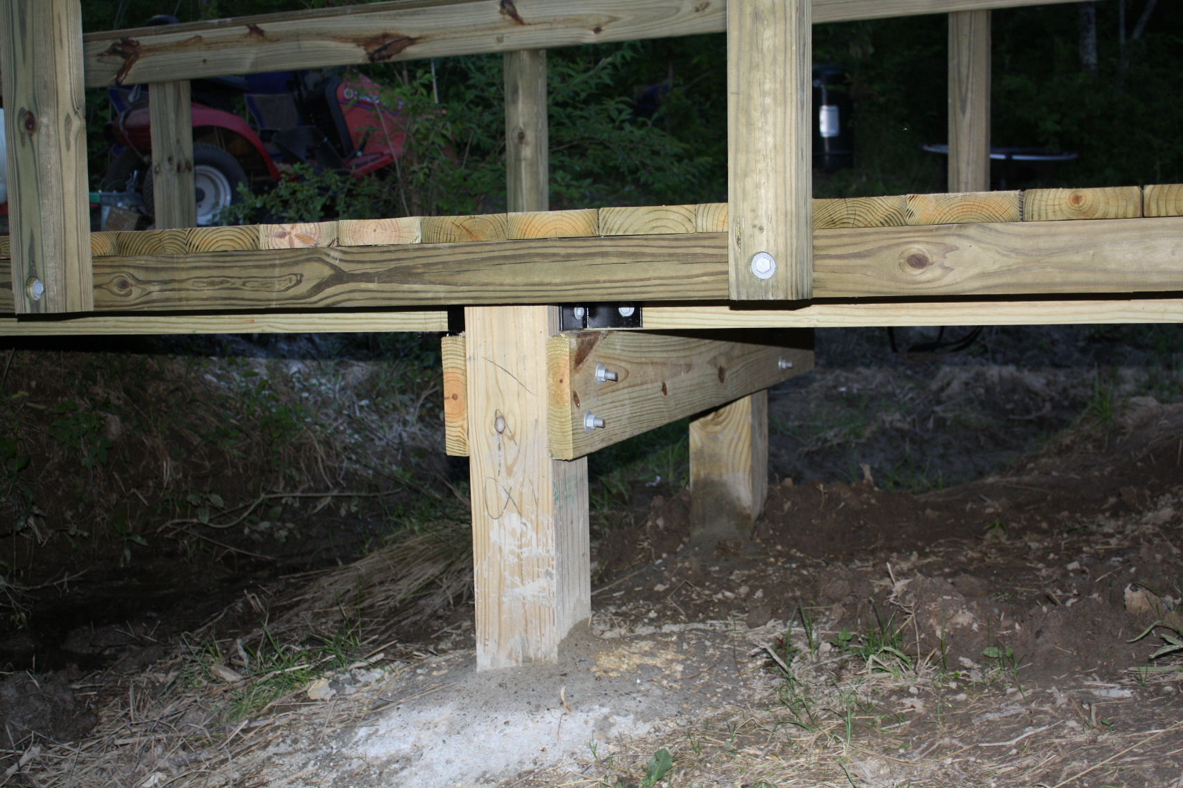

I got the tractor stuck digging the footers, as I had to back right in the creek to get close enough to dig. I built a concrete block wall (solid block) to build one side up even with the other. I bolted two 6x6 beams together on each side of the tracking with 1/4 inch thick steel brackets i made. The other footer is even with the ground, and is bolted right to the 6x6's.

No its 4 6x6's 20 feet long...2 bolted together.,on each side..the longest span between supports is about 7 feet
   / Building a bridge
It has 2 more supports under it (4 in all) the other 2 are 6x6 posts with cross beams.

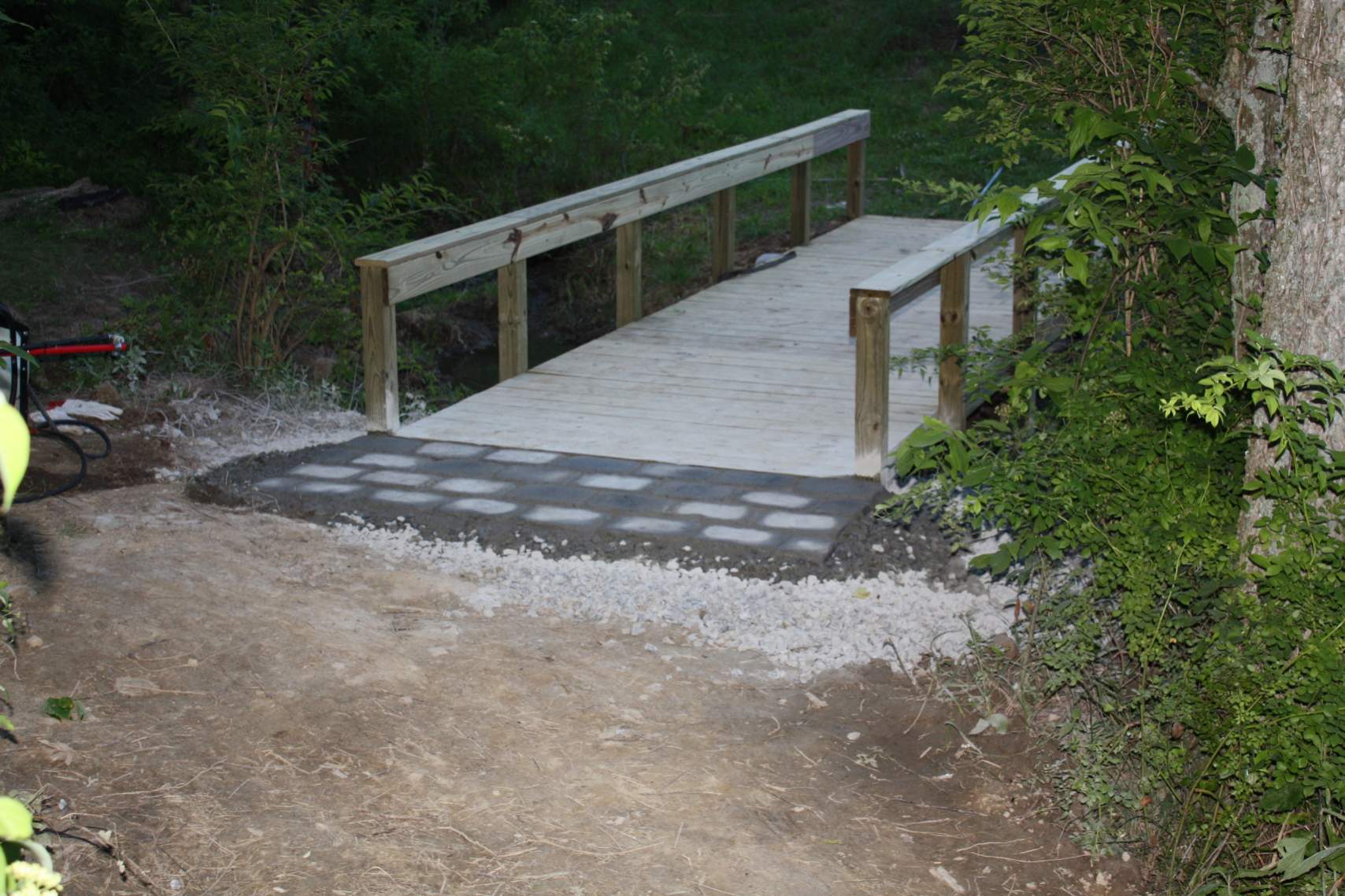

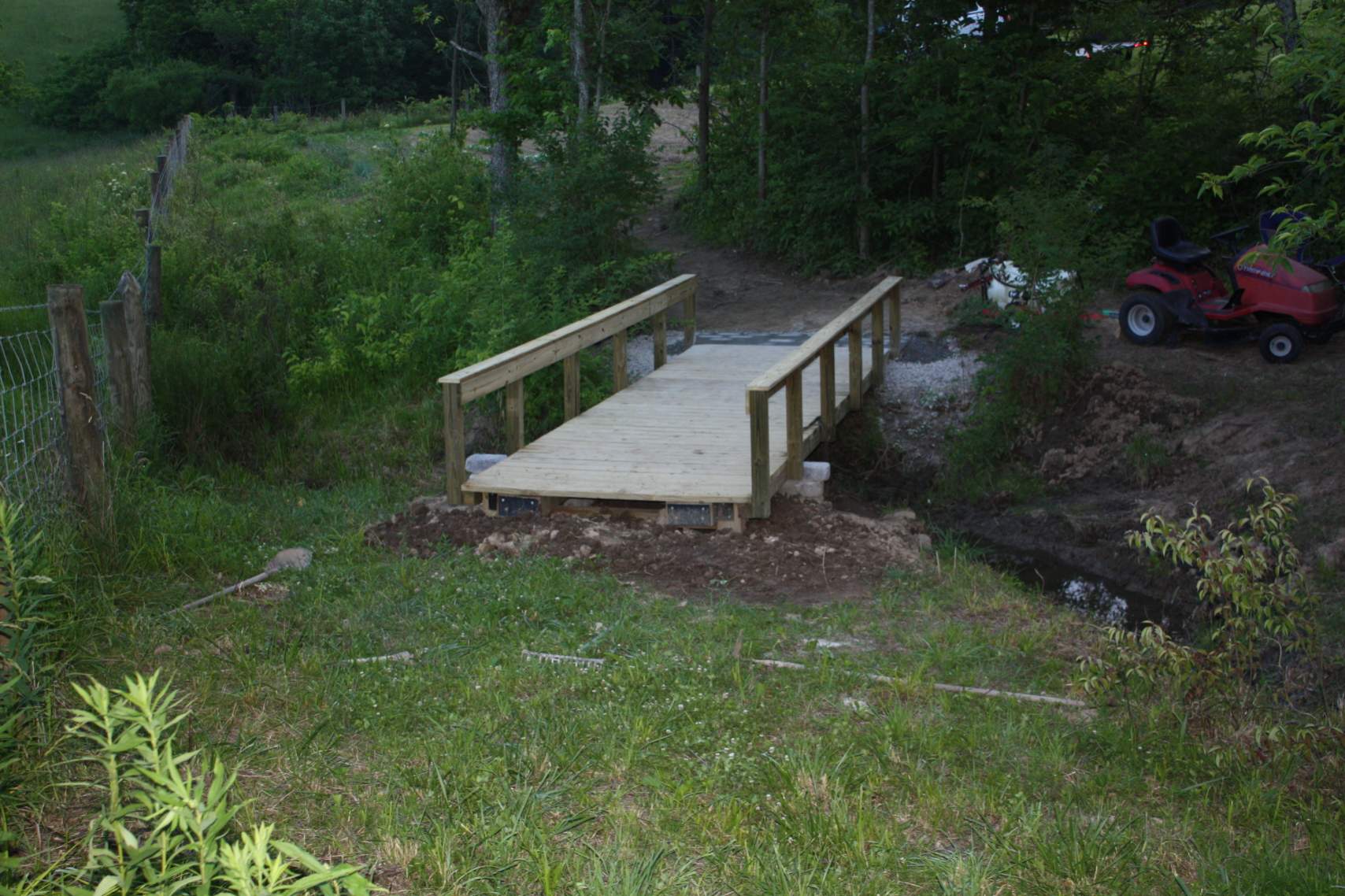

Heres some pics of the sides and one end finished. I really like how the end with the pavers turned-out (my girlfriend's idea). I'm planning on doing the other end as well. I did drive the tractor on it, but couldn't go all the way across because of the unfinished end, and I was a little nervous (scared to death, outriggers down ready to jump eagle eyes on any wood moving the first popping sound...bail scared)....no drama thank God.

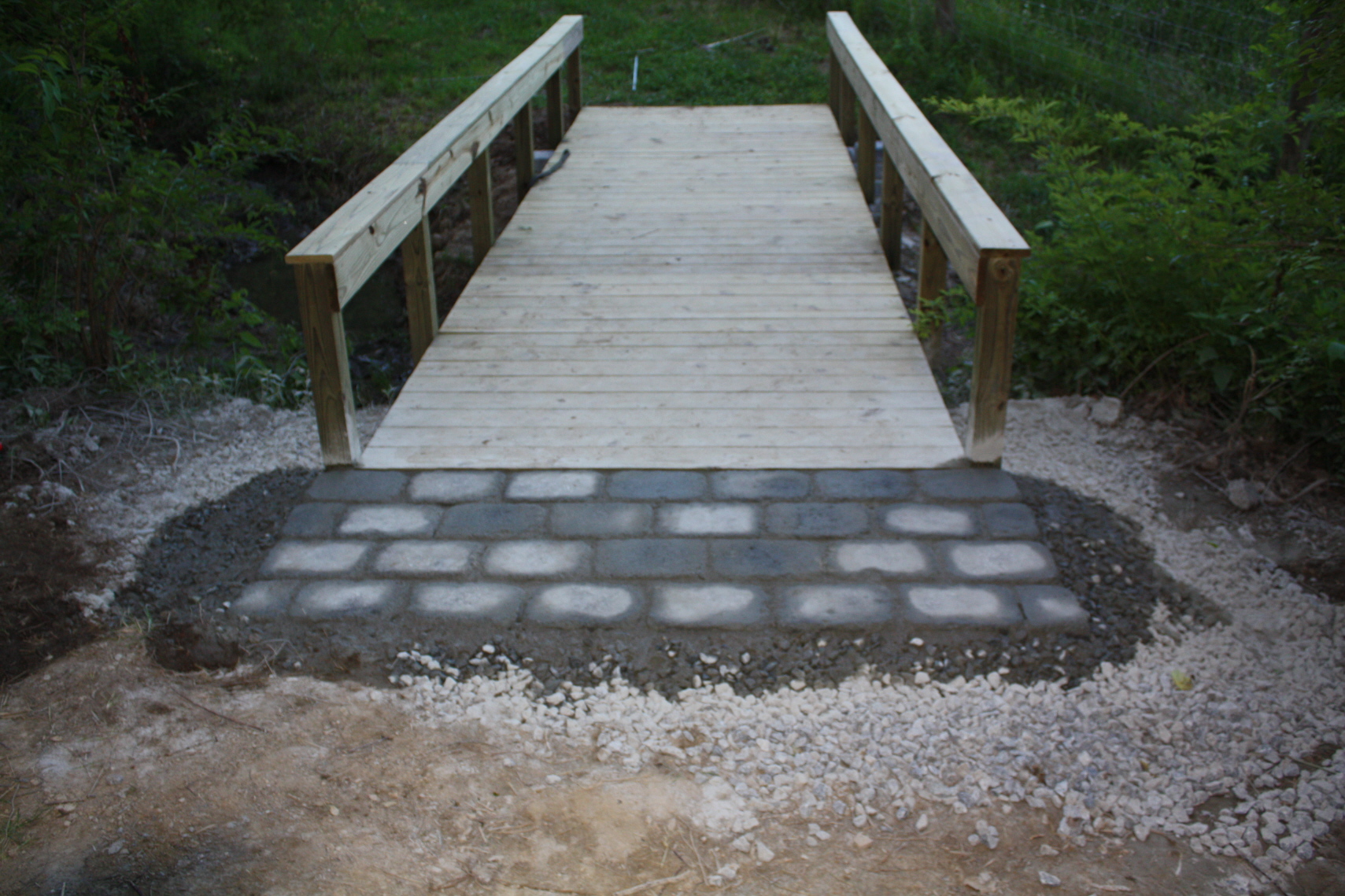

The pavers are 4 inches thick. I tamped the ground, then put 6 inches of gravel, tamped again, then a layer of sand (about 2 inches) a thin layer of mortar, then the pavers, dry laid. I then poured dry mortar over the top of the pavers and worked it in, and sweap off the excess with a broom. I then sprayed water on it after i let it set overnight. I plan on repeating it (the mortar) at least once more.

Your bridge looks good.
