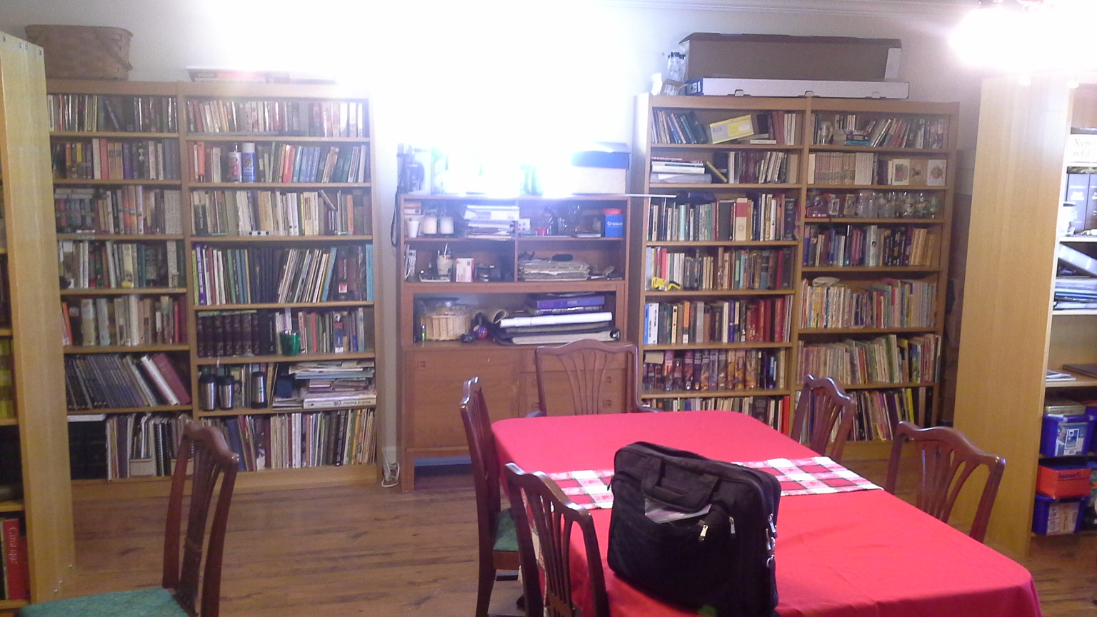

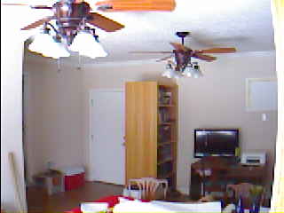

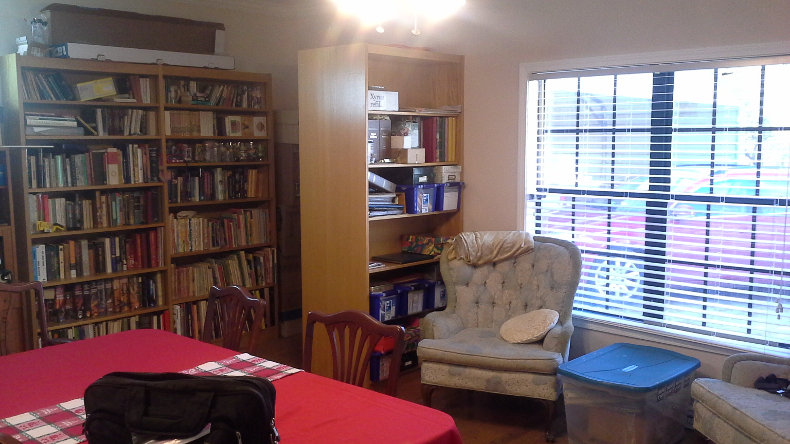

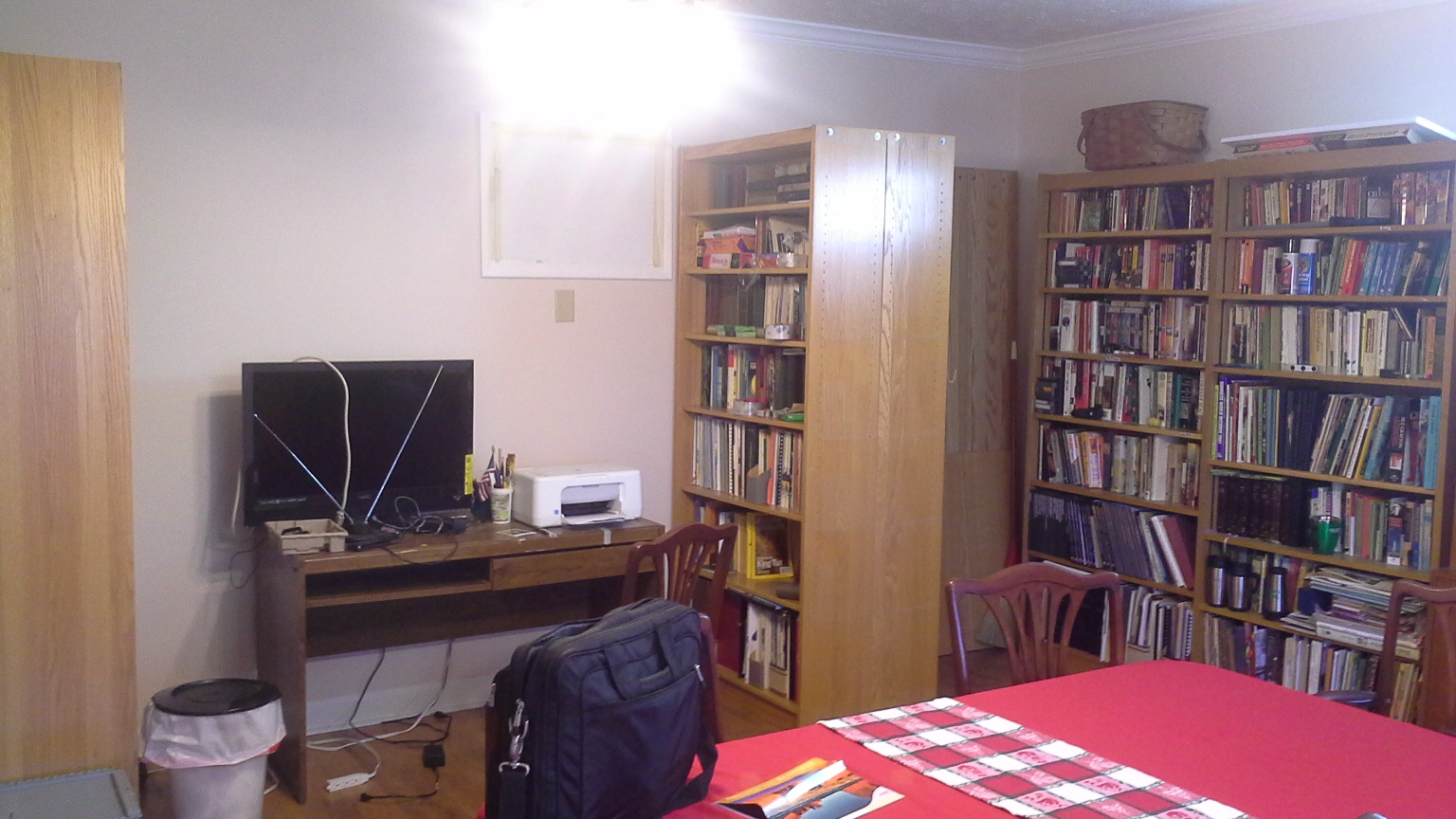

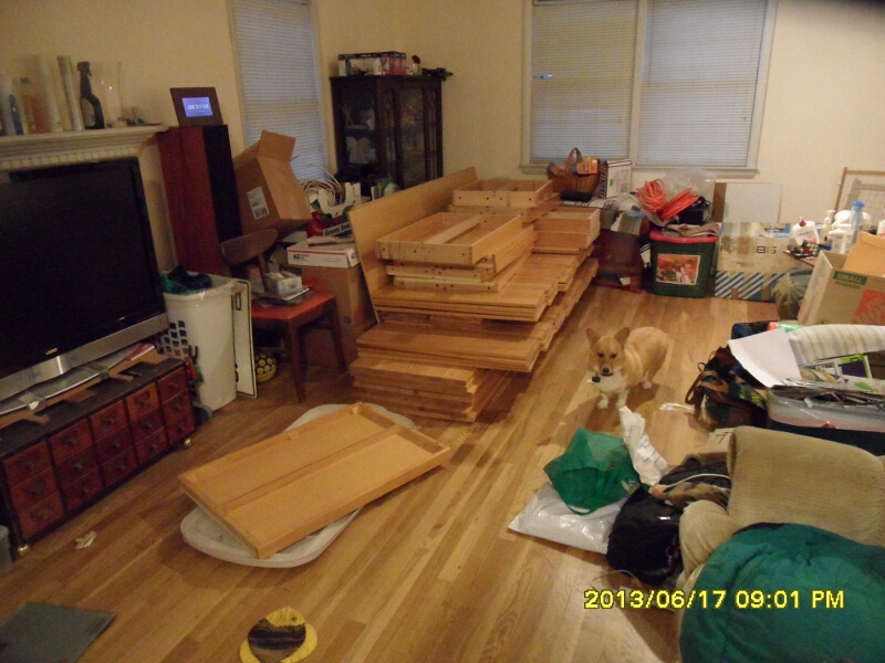

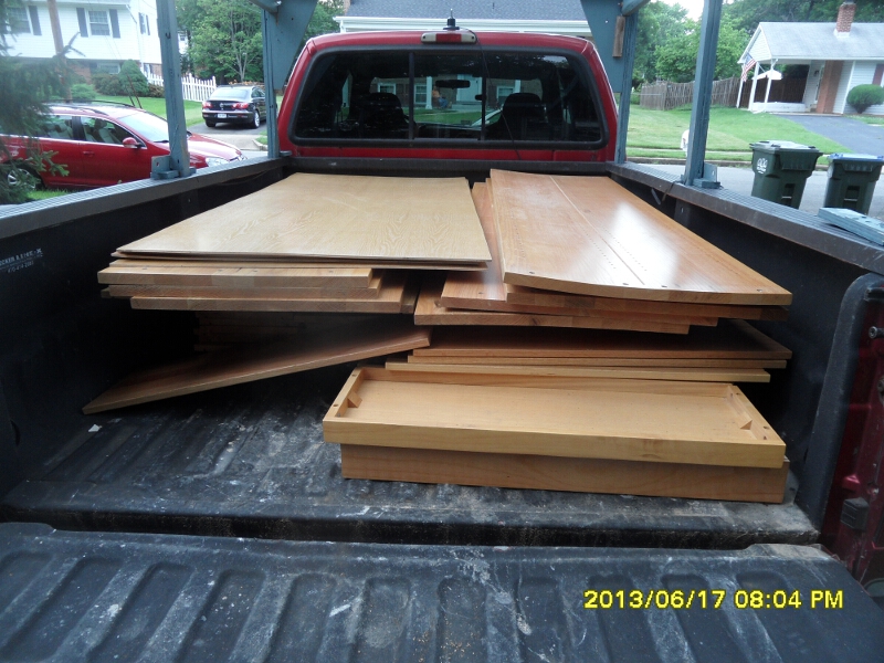

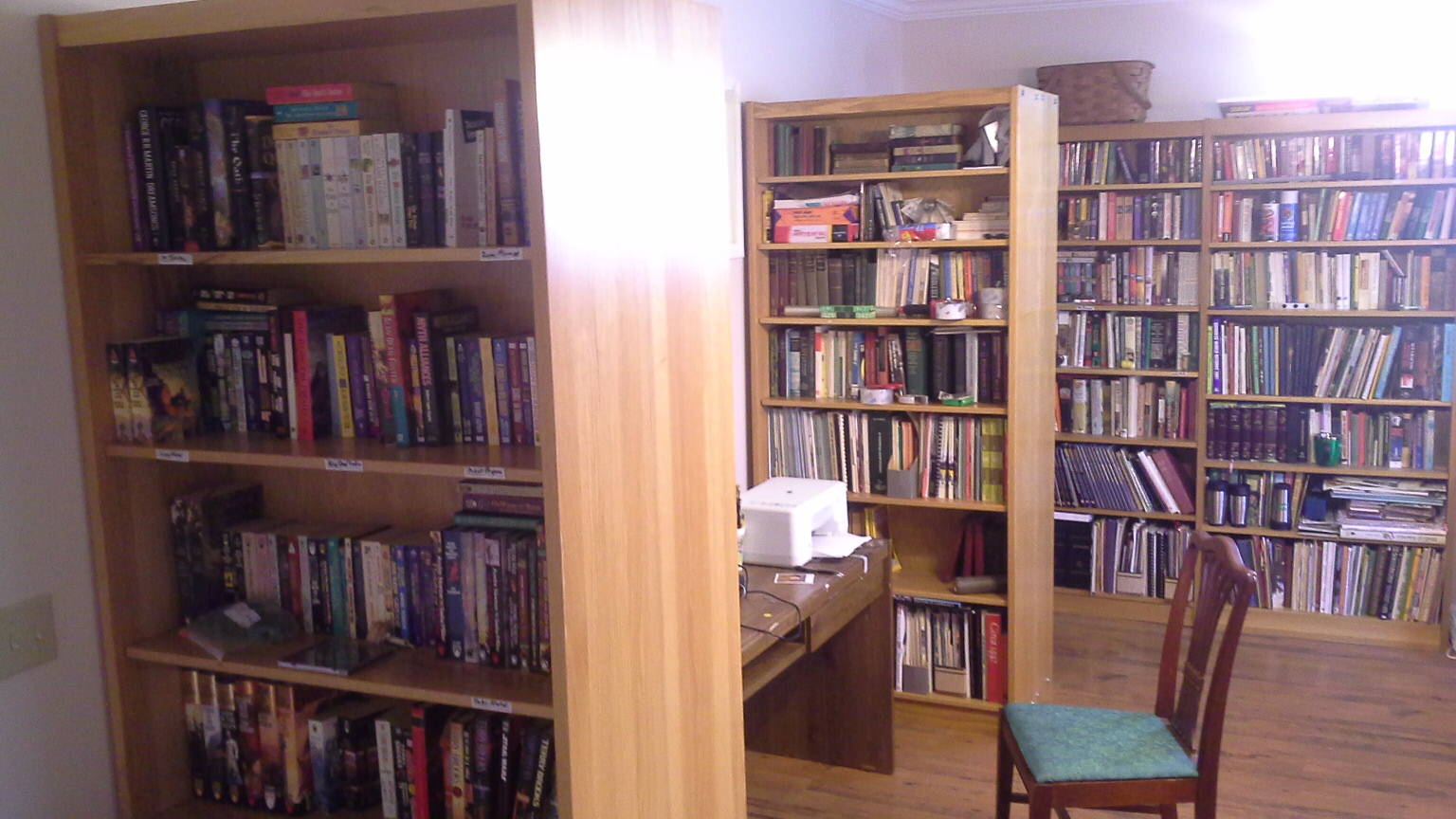

I bought SWMBO's bookcases for about $350.
/edit the couple of pictures on the right show them when I got them.
20140117_093602.jpg20140117_093610.jpg20140117_093617.jpg20140117_093638.jpg0522203458.jpg8x6SAM_0919.jpg8x6SAM_0918.jpg
Similar is on sale Public Surplus: Auction #1223876 presently bid up to $28.00, that's twenty and eight dollars.
Trouble is that there is about 200 foot of double sided bookcases, about 180 feet more than I need :)
/edit2 - and it's all solid oak, except for the partition for between the double sides. A single unit now starts at over $1,500 Gaylord® Bookcraft® 82"H Double-Faced Wood Shelving (Starter) | Book Shelving | Shelving | Furniture | Gaylord.

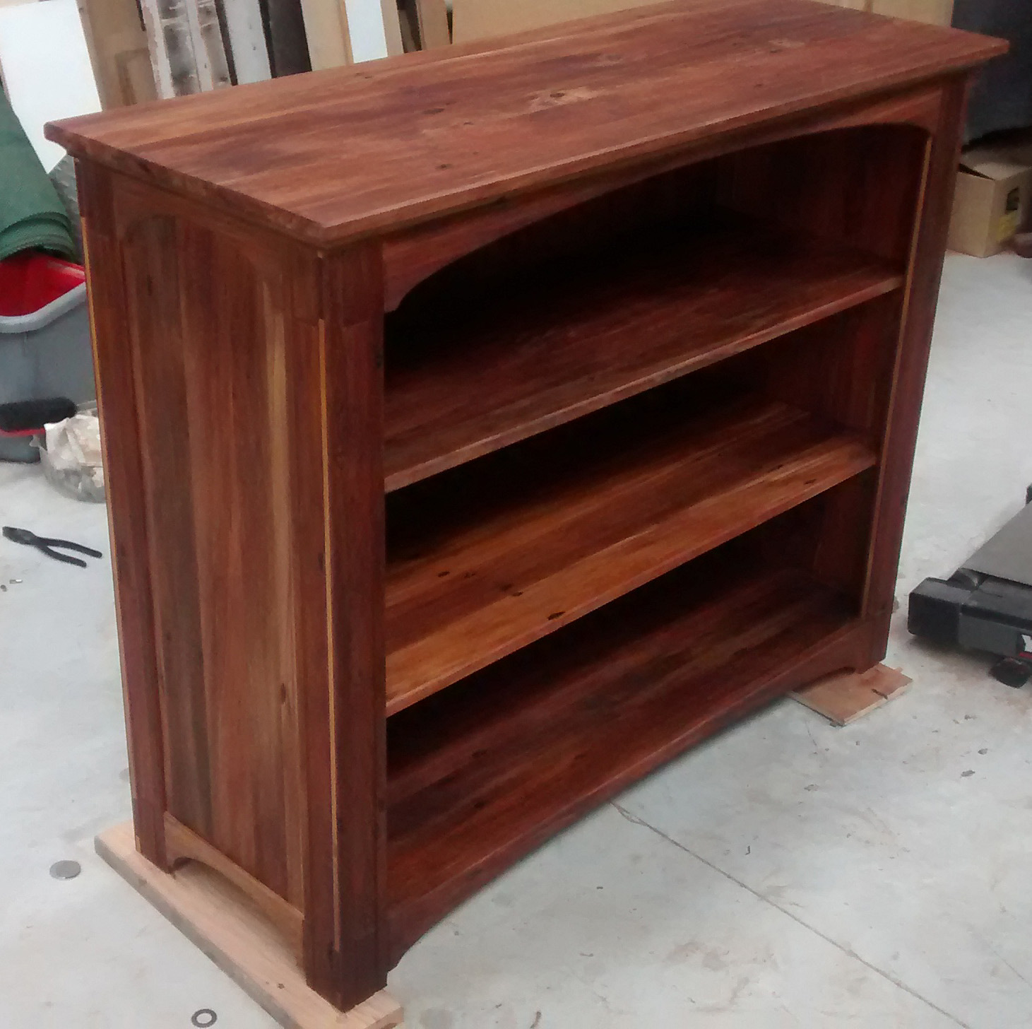

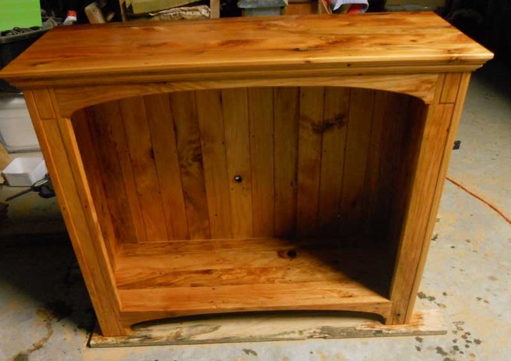

It would depend on the design of the bookcase and your experience/machinery. I've seen some wonderful bookcases made from plywood, and I am partial to solid wood, mainly reclaimed. Here's a few I've made. The lighter one from decking that I had to replace as much of it was rotting away. The darker one from the flooring of a house that burned down.
