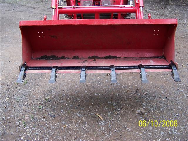

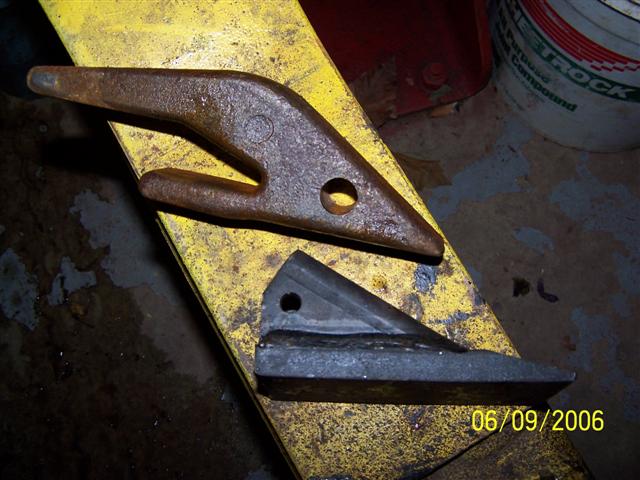

I made my own toothbar. Used 1/4" thick by 3" wide flat steel obtained from the scrap local yard for the base plus scrap I had laying around. I bought the teeth from a local dealer that works on dozers and backhoes. They had all different sizes. Paid about $70 for 6 with replaceable teeth. Figure I have about $120 into it.

George, Have you used the toothbar much? Has 3X1/4" worked ok? I thought most were built on 1/2" stock. I know nothing about toothbars, that's why I ask.

I haven't used it a lot but have used it on hard packed runner crush driveways, Old blacktop drives, pulling up cement sidewalks etc. and haven't broke a tooth yet or bent the 1/4 x 3. I don't make a living using it either, its just for my own use and a few jobs for neighbors. For my purposes so far it has worked well. I am thinking of building another using thicker plate. A friend of mine just bought a tractor and wants a toothbar. I told him I'd sell him mine if he wanted it. If he does I'll build another bar with a thicker 7/16" x 4' plate.
