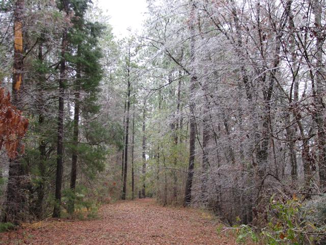

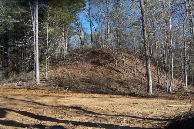

I have a fairly large berm on my land. The US Army had it built in 1942 as part of a rifle range. This one is the 300 yard shooting position of Rifle Range #4. Every hundred yards there is a berm to keep the soldiers perfectly lelel when target practicing. I've removed the impact berm and the 100 yard one so far, and have started on the 200 yard one. I'm keeping the one in the pictures.
It's 600 feet long, 20 feet wide at the top and in places, 45 above the ground below. It's perfectly flat and goes straight out into the trees. It's the weirdest thing, but also very unique.
Eddie
