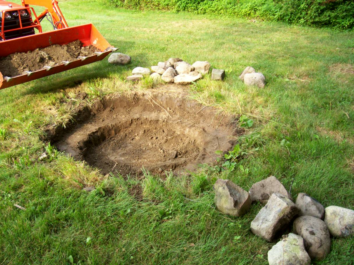

Just a quick little project. I love sitting around a camp fire with friends and a cold 1. I decided to Photo document my style of pit. I build water gardens and coi ponds so my fire pits are in the same style of building

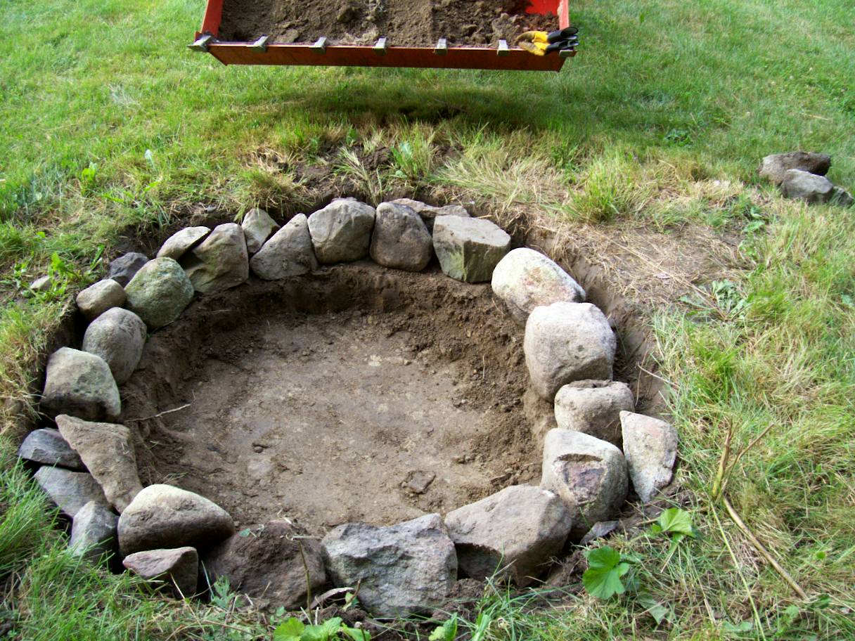

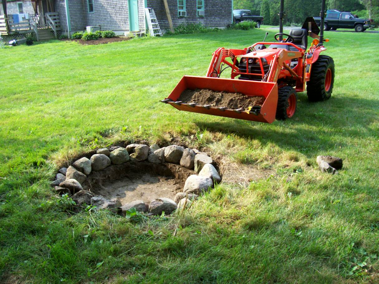

I like to have 1 set of stones below the ground so I remove material the size of the overall area. Then I come in about 8 to 12 inches and dig out the bottom of the pit about 8 to 12 inches deep. Then I set the lower set of stones on the shelf and then trim away any excess material in the hole

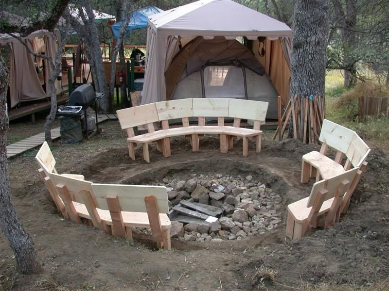

That's a worthwhile project that the whole family will enjoy. There's nothing quite like sitting around the campfire and enjoying yourself. Those are great photos too. I recently added a pit just like yours to my campground. Also made some benches to sit around it. Hope you don't mind me sharing one picture...
   / Building a backyard Fire Pit
3RRL said:
Timber,
Thank you, thats a great camp you have and I would never mind anyone adding pictures and ideas to a thread. I have found you a very interesting person yourself. Your projects have been very fascinating, You have a good head. I have viewed a great many of your threads. It is my pleasure to meet you.
