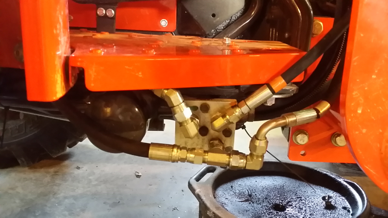

I am in the process of piecing together a 3rd function for my l3200. Ordered from surplus center a d03 solenoid valve and subplate. The valve itself is rated for 10gpm and tractor can only supply 6.5gpm. Looking at the subplate it only has about 1/4" holes. Seems like it will be restrictive right there and slow everything down and I don't need the cycle times to be any slower on the backhoe. Should I return the d03 stuff and bump it to d05 so I have the flow? Fremont industrial supply has the d05. Any advice? Thanks

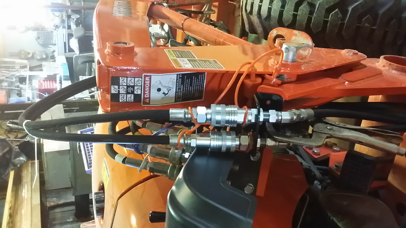

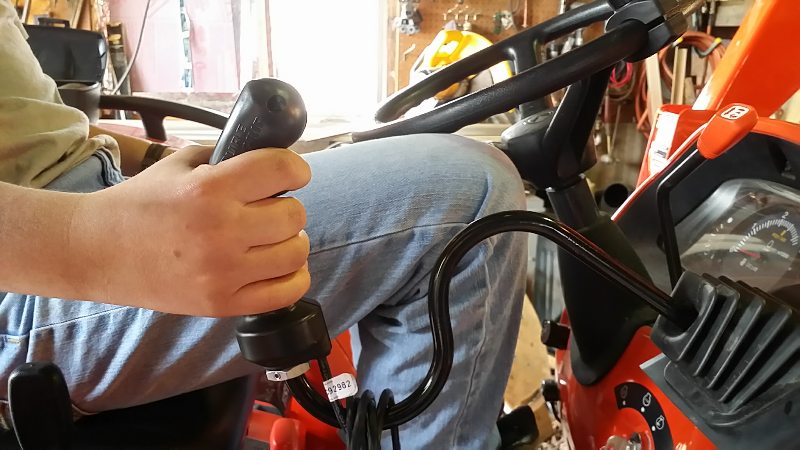

Does he not have a website? Didn't find it when I searched it. I'm going to try the valve I got and see if anything slows or see if I have heat at the valve. I was looking at the backhoe last night and all of the cylinders have 1/4" hoses attached to them so I don't think it's going to slow the operation down and it says for up to 10gpm so I shouldn't have a problem. I ended up getting a John deere joystick I'm going to see how that works out.
What subplate did you order? This one has SAE -06 (3/8") holes: https://www.surpluscenter.com/Hydra...STATION-DO3-SUBPLATE-OPEN-CENTER-9-5883-1.axd
In fact I don't see one with -04 (1/4") holes.
   / Building a 3rd function kit
That's the one I ordered. The holes measure 1/4 but it accepts the sae 6 fittings

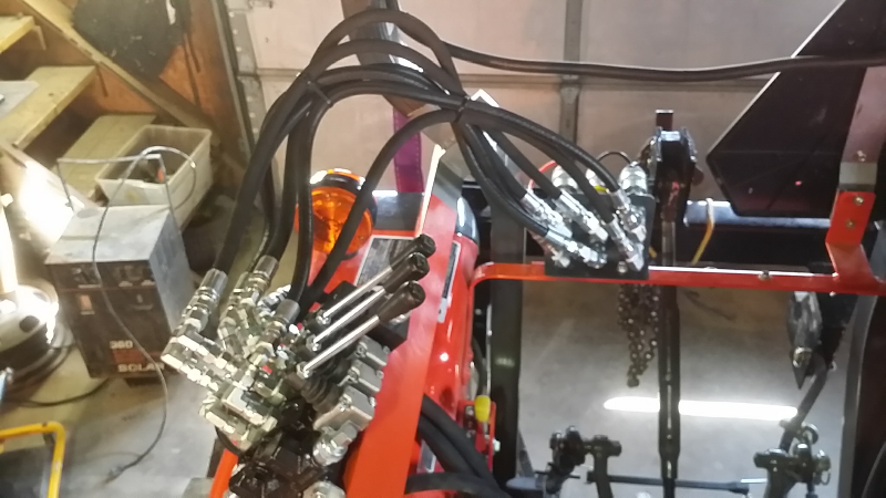

Good looking, daughter, tractor and placement of your valves. With my stiff neck I need everything in front of me pretty much. the BXs have limited space along the dash area. I am even thinking of replacing the original FEL joy stick with a sectional set of valves for both front and back with solenoids and switches on the handles. Joy stick for the FEL and another for the rear remotes T & T. It is a design in progress.
