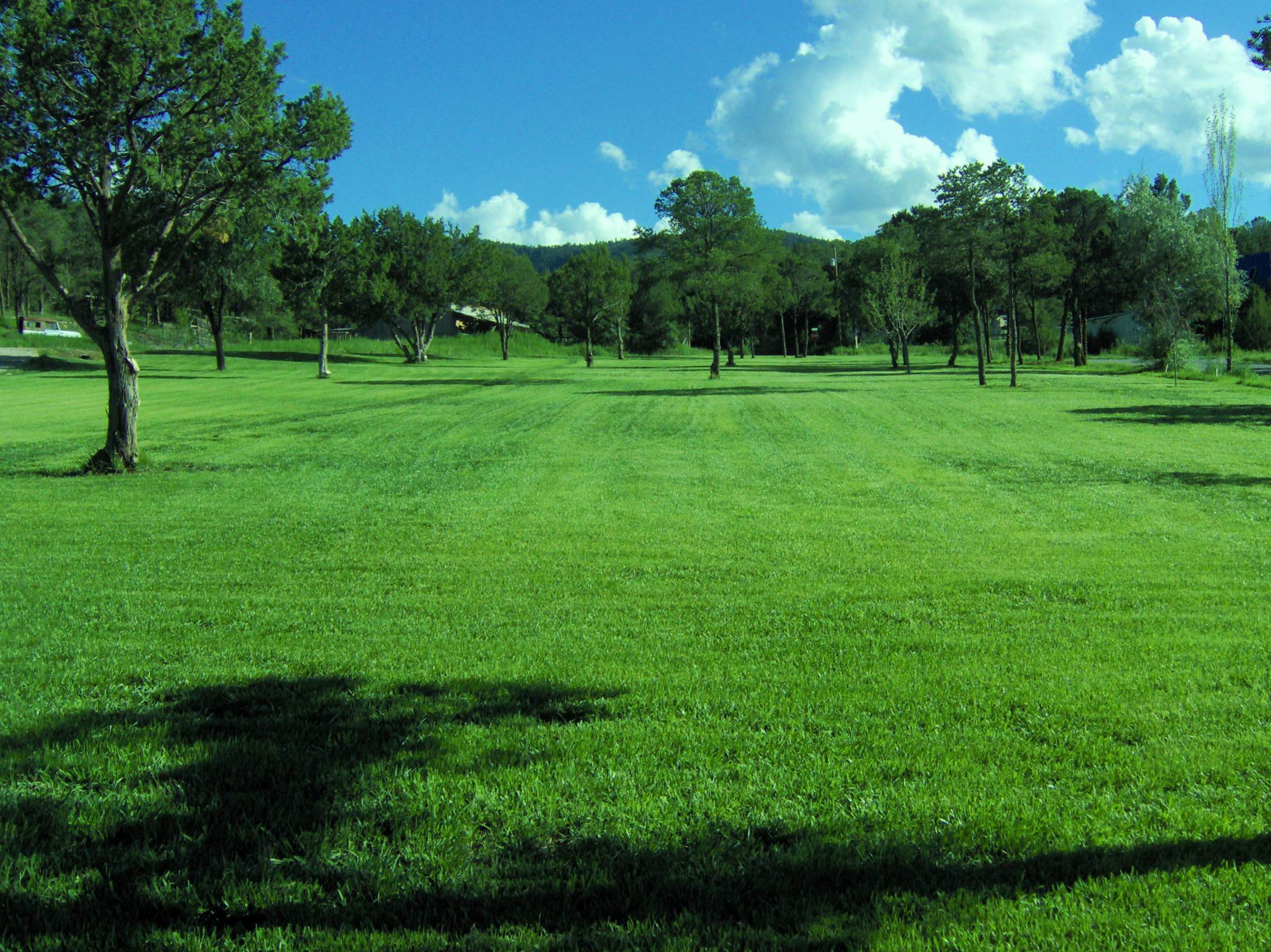

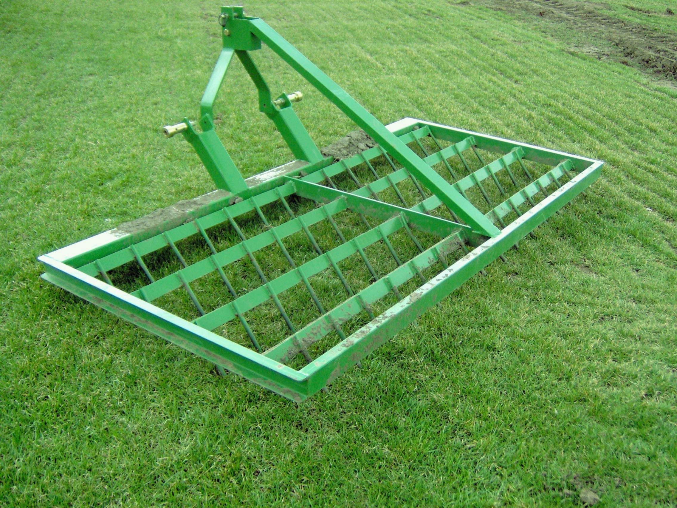

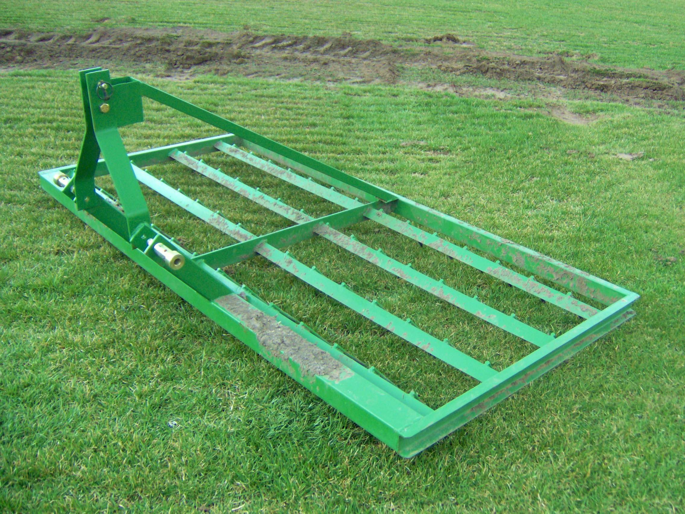

For seed bed prep and broadcast seed covering I prefer using a spike tooth harrow. Much less movement of the seed for a more uniform stand. Here is one I built for about $250 with an 8' width. I used 5/8" sucker rod for the teeth with staggered spacing. In the first two pictures notice the grass is growing well in the small ridges. The last picture shows the grass filled in uniformly in the spring.

Funny that your second attachment with the pictures of spike tooth harrows has my home built unit in it. I see a China company has picked up the image and is trying to market it. If you look closely at the pin connections you can see that I had attempted to make it swivel and originally had chains running to the rear. That did not work because the forward motion would cause the rear to tilt up. I welded up the joint and added the bracing and used it to finish my lawn. If I were to rework it from scratch the pin/swivel joints should be close to the ground for a straight pull. Then the harrow section could float correctly.
