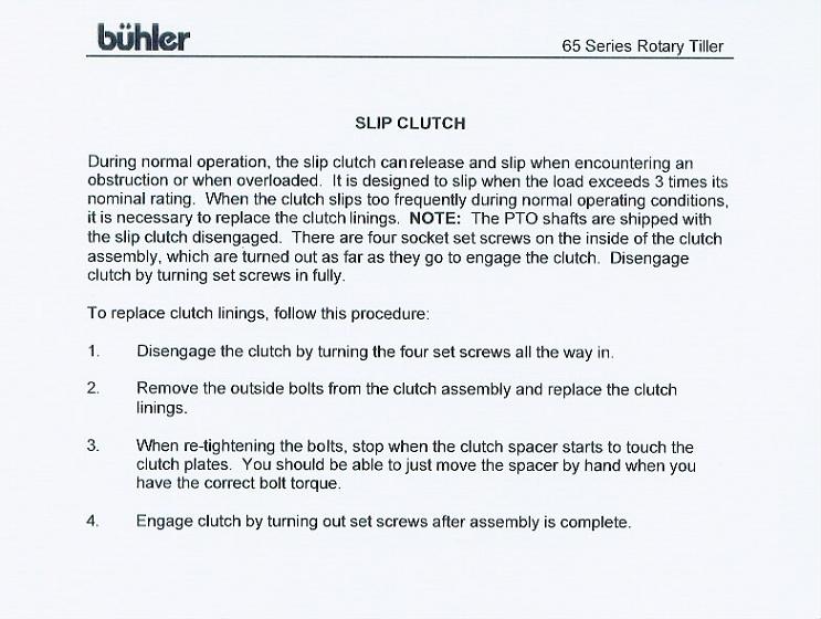

Also I did start tilling with it but noticed it was slipping alot on the slip clutch. Reading the manual again for a different series I see you are suppose to turn 4 allen screws all the way out. These were not, did I hurt the slip clutch at all? I ran it for about 20 minutes going not very deep but on the surface. Anyway when I finally figured out something was wrong you can smell the burning and also there was some smoke coming out of it.

I got the slip clutch working. I did find the 4 allen screws and turned them all the way out. Tiller worked great for about an hour and then I must have hit something. That drive line is the same for the next series up which I can get the manual off the web for that one so I will download it and use it until I can get the right one. Still can't get the unit to slide over. I think if maybe I loosen the U bolts and then maybe do some tilling with them loose maybe if any paint is holding it, it should break away.
I must have hit a solid rock because now alls I hear is a rattling noise. The PTO shaft turns but the tines don't. I can move the tines by hand so I am hoping there is just a shear pin in there?

Yep it is the chain. Broke a link right in half. So my question is did I turn the allen screws out to far???? The manual says to take them all the way out, as far as you can go??? So that is what I did. There is some maintenance you can do on the clutch but it does not talk about the allen screws in the maintenance. I probably should go through the maintenance even though it is a new machine. Well my dealer said he set everything up too??? Don't think he did.

<font color="blue"> So my question is did I turn the allen screws out to far???? </font>
Murph,
I would expect so. First you had slippage...then you turned the screws all the way out and you had no slippage, but hit a rock and broke the chain...
To me this would indicate that the correct setting would be somewhere in between...
   / Buhler Tiller Y60SD
I guess if I would have gotten a complete manual with it I wouldn't be asking these questions. What manual I could get off the internet only says to turn all the way out.
Page from manual is attached. Doesn't really say much about the adjustment here.
