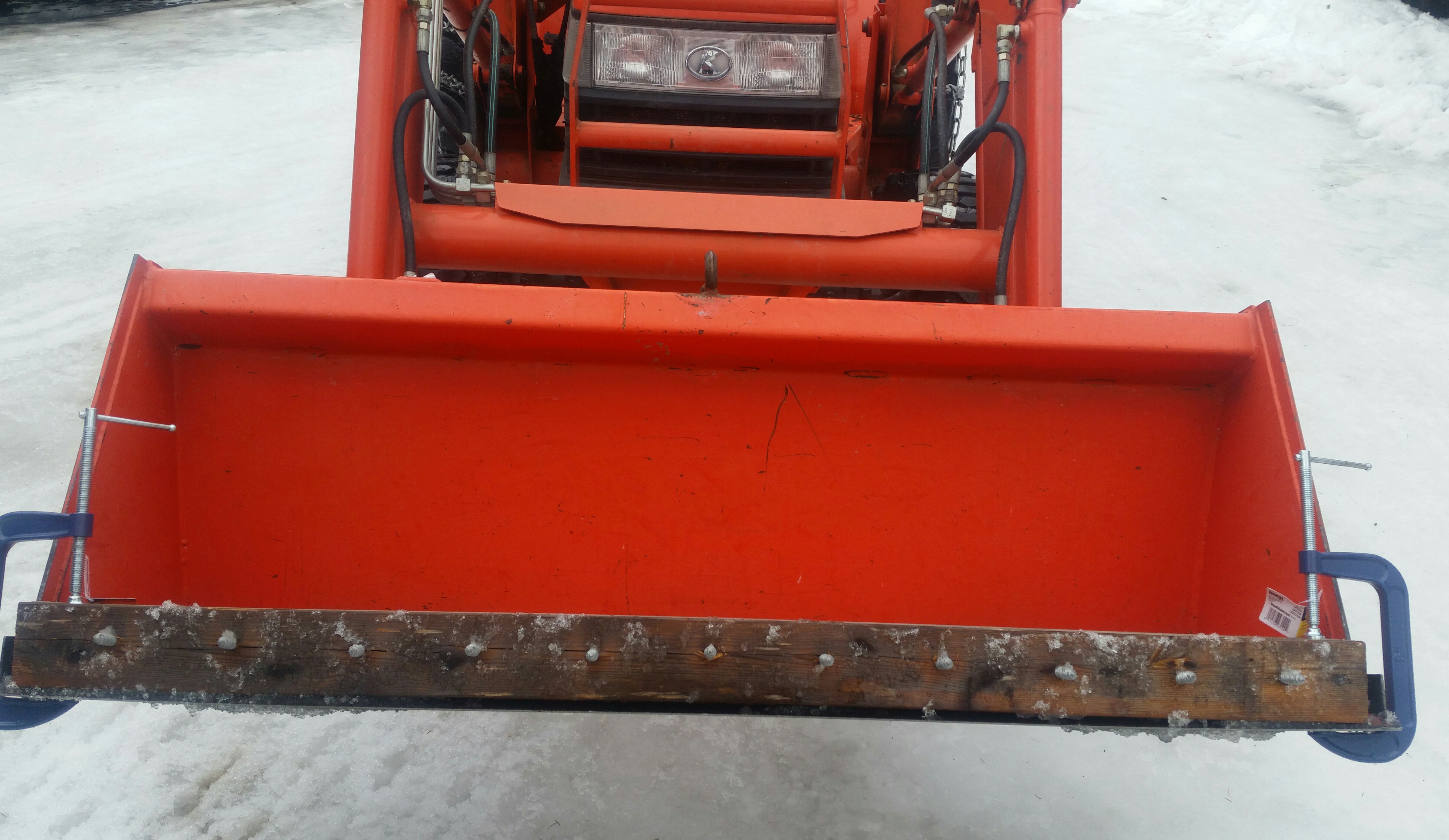

Firstly, I am new to the forum so I realize this is likely an old idea. I couldn't find anything similar but my 'search' skills might need refining.
Also, I'm not sure if this qualifies as a 'build' as there is precious little building involved.
But, it works.
It's my simple, cheap solution to the slippery wet ice we get on our gravel road from freezing rain, winter thaws, and now the spring melt.

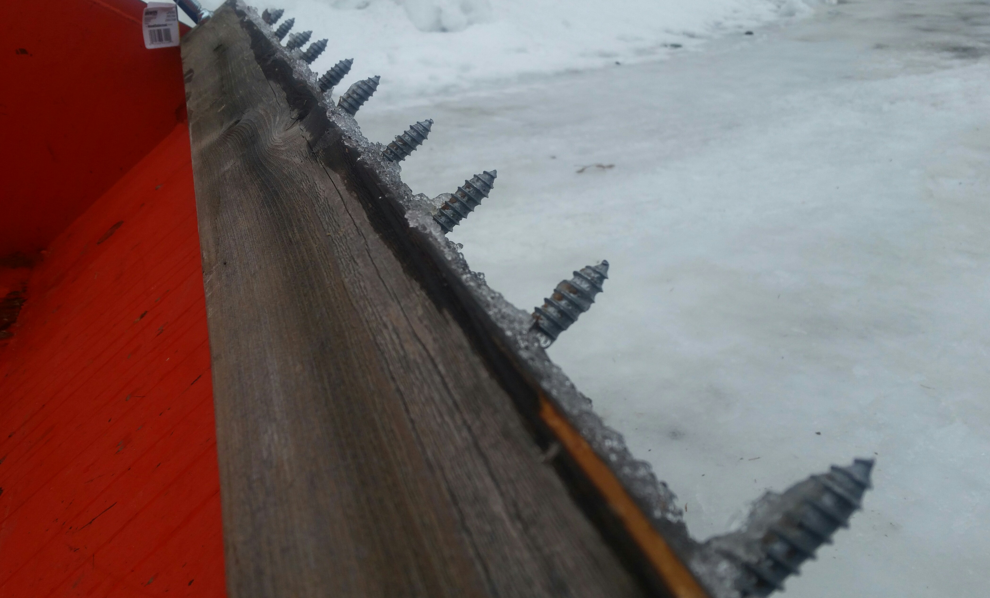

Materials: One 4X4. Two 6" C-clamps. A handful of 1/2 X 5" lag screws.
Incredibly technical and detailed instructions: Insert lag screws through 4X4. Clamp to bucket.
Operation: for me it works best if I tip the bucket 'almost' vertical, then drag backwards in the float position.
I am a little surprised the C-clamps are adequate (note that I didn't even take the tags off so I could return them) but, so far, they hold just fine.
So, Mr. Moneybags, go buy your fancy-pants tooth bar or hoity-toity harrow attachment if you must. But for the 2 or 3 times a year I need to not slip on my *** or pull a car out of the snowbank, this little fix does the trick.

UPDATE: It worked great on "soft" ice, when the temp was at or near melting (and really, that's what creates the problem,) but, dissatisfied with success, I had to try it on colder, harder ice out of curiosity. As expected, the clamps were not up to the task of holding the 4x4 at the edge of the FEL against the downward pressure. So I simply chopped up the remainder of the wood to create a couple of 90 degree braces against the back of the bucket. Again, nothing fancy, but there it is if you need a quick solution to create some texture on smooth ice.

Eric, in your pictures you show the location of the lag bolts pointing up. You also mentioned you use the implement while backing up. That means you have your bucket rolled all the way over, which extends your curl cylinders fully. You can destroy those cylinders doing that when the end brakes off!
You might clamp the 4x4 on the bucket so the bolts are facing down when the bucket is flat on the ground. Then just lift the bucket, but leave it level, and you back up...Then those cylinders will not be extended and subject to the shock load.
   / Budget Ice Scarifier #9
I would be weary of those lag bolts breaking. One of those in a tire will ruin your day. Do a search for a product called the ratchet rake. I think it'll give you some more ideas on how to improve your design.
