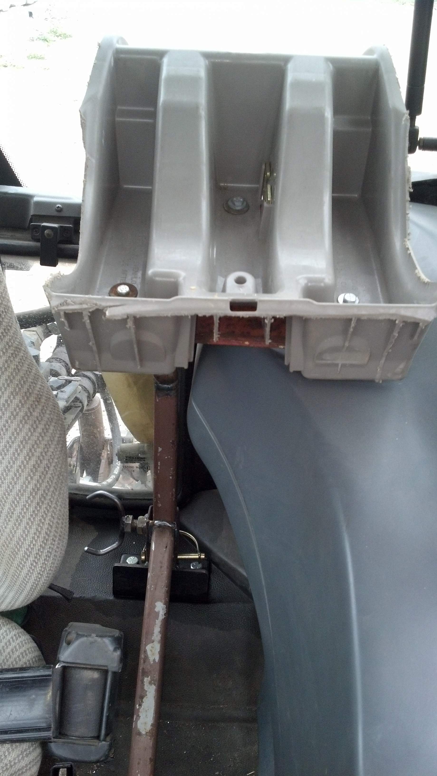

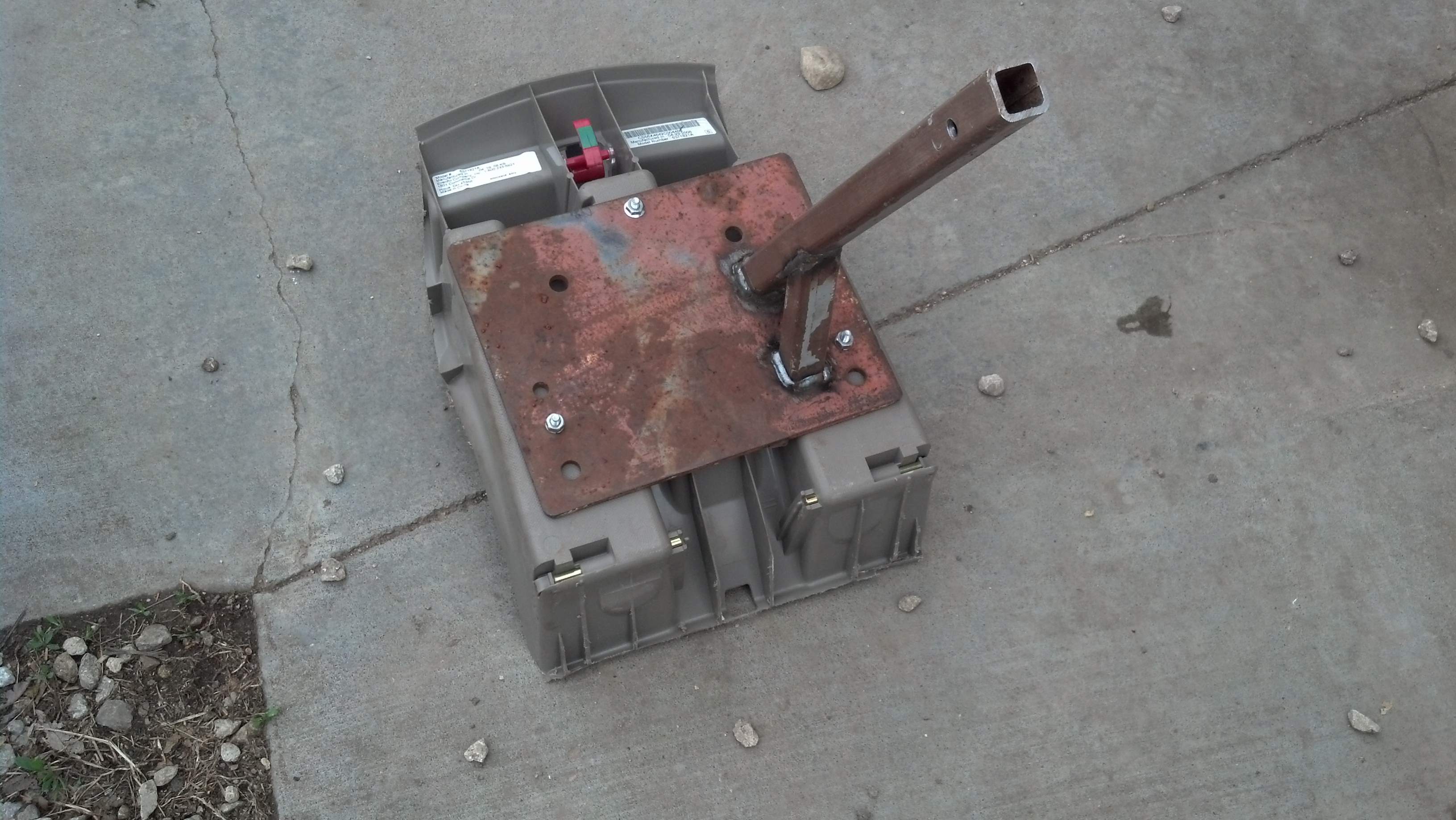

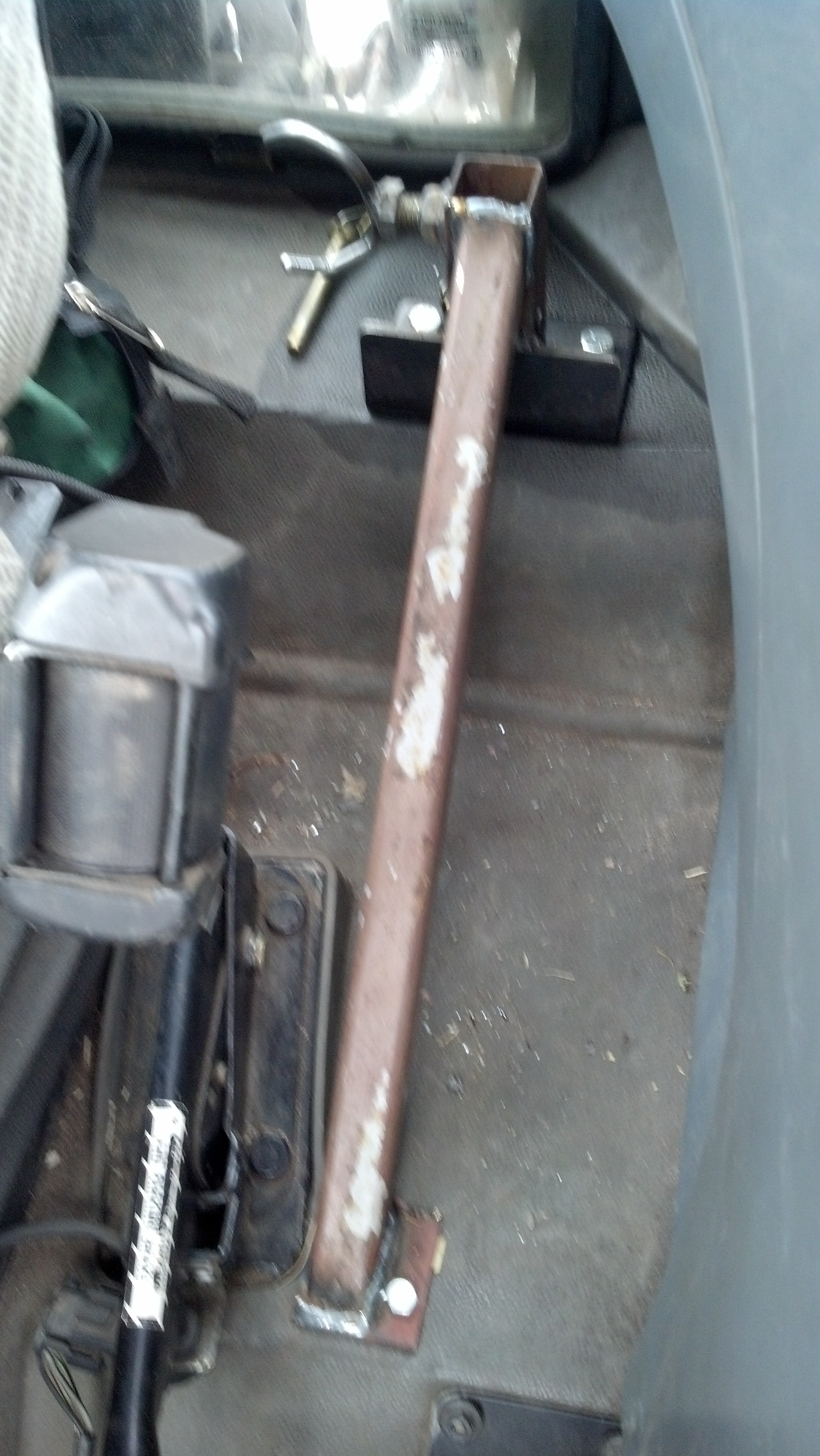

Here are some pictures of the seat brackets. I still need to paint it up. I also had to cut some of the plastic off the car seat base so it would not take up so much room. I was going to try and sand the cut edges so they look a little better.
