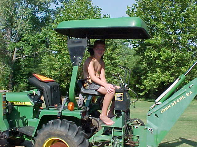

This Spring, I bought a canopy for my JD 855. I wanted a little protection from the scorching Summer sun that was soon to be upon me. My eldest is about 5'6" tall and kindly volunteered to model as driver while I took pictures.
This picture is taken with canopy in "standard" position.

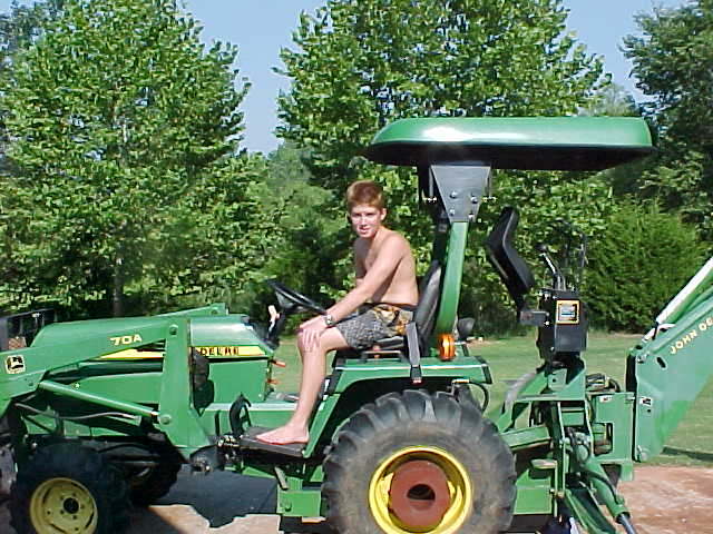

Most of my tractor time in the hot Summer sun is spent mowing with my MMM deck. The "standard" canopy position is fine for open yard, but can limit how close you can get to trees with branches at canopy level.
Also, I have a backhoe attachment that would be even more of a joy to use with a bit of sun protection. But as you can see, the canopy offers little headroom for backhoe work in "standard" position.

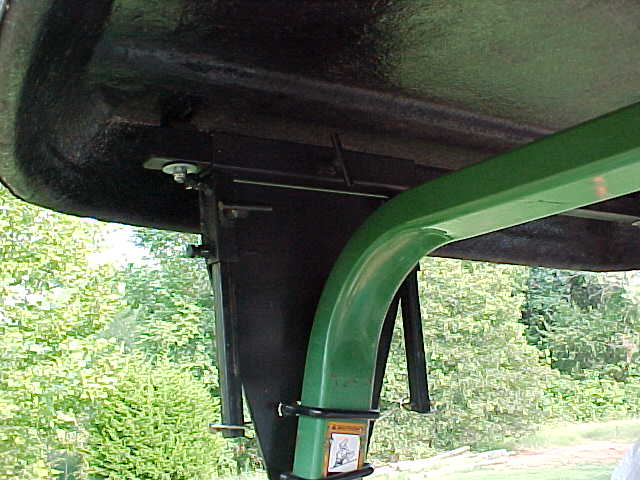

Here's a picture of what's under the canopy. The slider is attached at each end to the canopy, and is the original piece of square tubing that came in the Bucktop installation kit.
There is a stationary, short piece of square tubing that just fits over the slider. It is horizontal in the picture and has a T-bolt at it's midpoint that is tightened by hand. It will hold the slider in place at whatever position (forward to aft) that you wish. It is not illuminated well in this picture, but you will see it better later.

This is a better shot of the T-bolt and stationary slider guide tubing. The T-bolt on the smaller vertical tubing (riser guide) secures one of the risers. Other than the sliders, which came with the Bucktop installation kit, all the other hardware was made from scraps that were collecting dust and occasional shakes of the head from my better half. The riser tubing was a sloppy fit in the next size bigger that I had available to guide it up and down. My solution was the bolts with lock nuts at each end of the riser guides to snug-up the fit (left side of picture).
