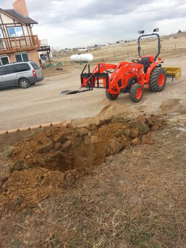

It's pretty pathetic compared to a backhoe, but at 10% of the price isn't to bad. Your machine might be a bit light to drive it into the ground. But if its sandy rather than our hard clay you might be fine.
My L3200 was light but got the job done. 15 minutes to dig a hole for a live 6' Christmas tree. It works on my new L4060 as well. I got the pallet fork mount one rather than bucket mount. Better visibillity.IMG_20131224_130200.jpg

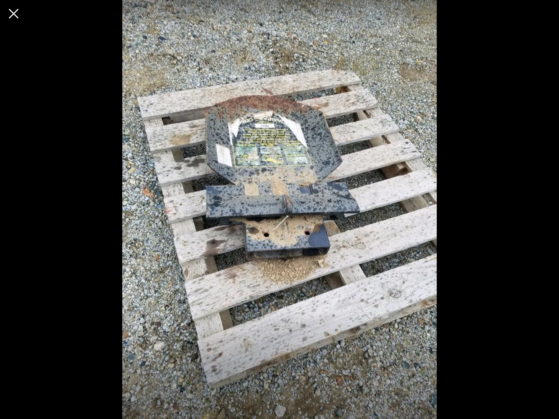

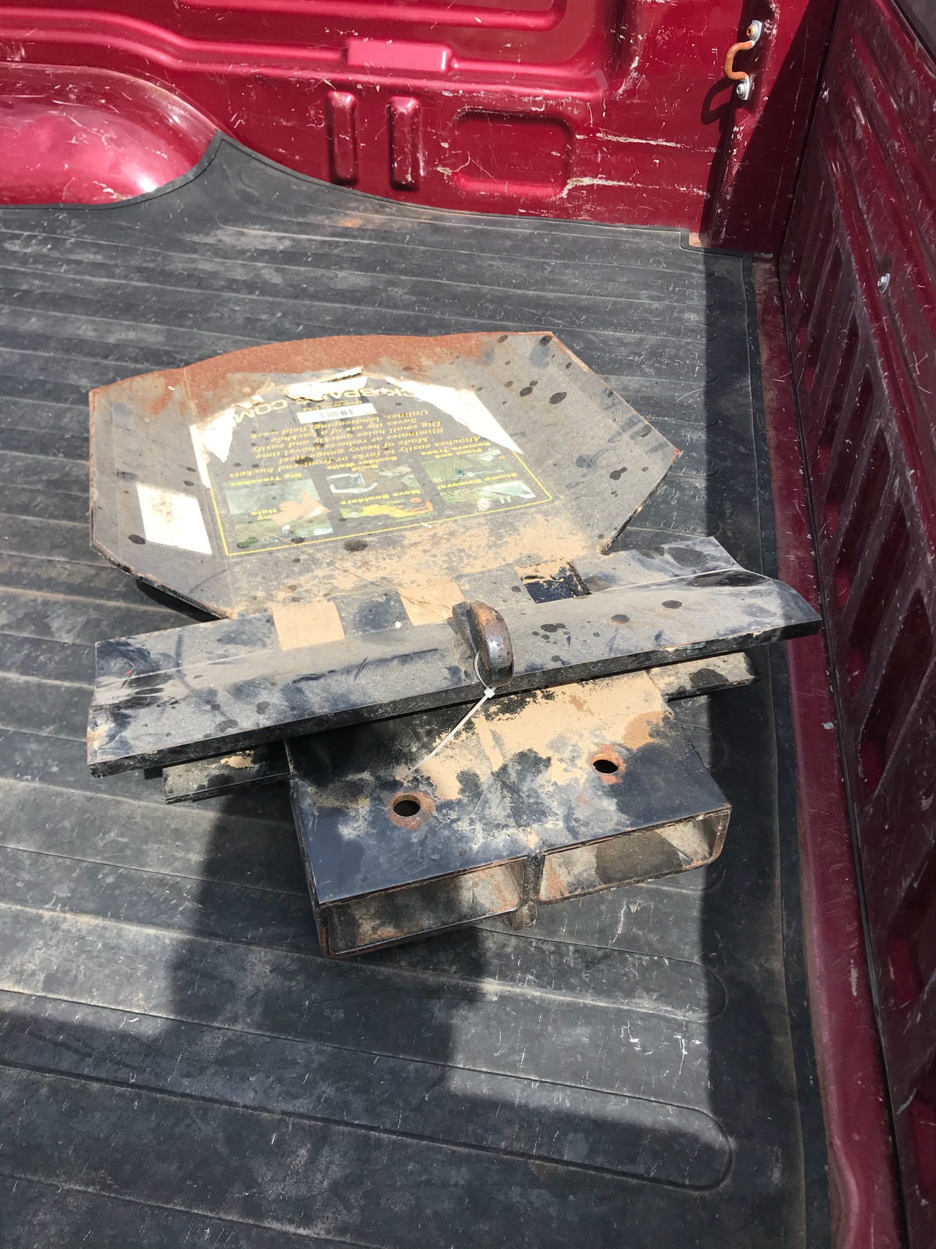

IMG_6710.JPG couldn’t pass it up for $75 bucks. Now to figure out the best way to secure it’s my bucket safely. Just gonna ease into it to see how it does.

Any pictures on how you hooked it up? I think I need to go get a section of chain and a binder?
