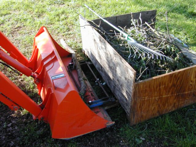

Just adapting "harv"'s brilliant idea of adding on to the loader bucket for those times when I have small prunings to pickup around the acreage.
Obviously made out of junk wood remnants: angled leading edge made out of 12" of a fruit bin side with 1.5" deep sheet metal cap on the edge; chain remnant lag screwed to center [pallet] runner so it can be dumped.
Cheers!
