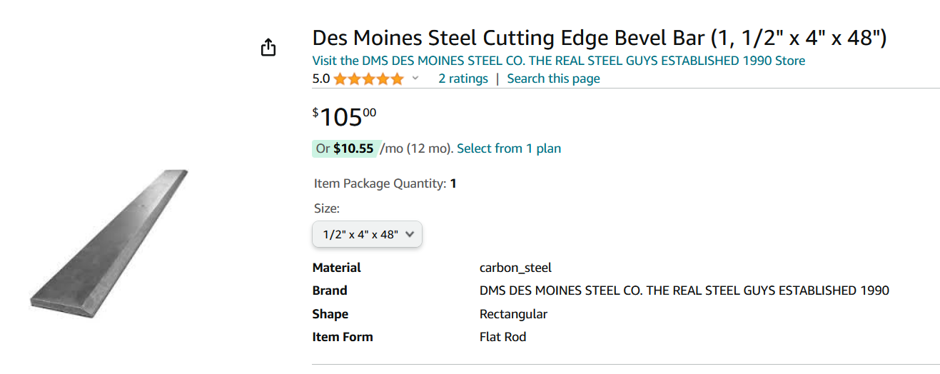

The wear edge is worn on my compact tractor bucket ( New Holland TC24D )
What type of steel do I need to repair it
   / Bucket repair #2
Amazon with freeshipping
   / Bucket repair #3
Many years ago (shortly after I got my tractor) the wear edge and bucket bottom was worn/bowed from heavy use. I had my welder replace the bottom and wear edge with armor plated steel and it's been straight and un-worn ever since.
   / Bucket repair #4
Where are you located?
Hunt for something like grader blade edges although they are pretty thick.
Apparently heat treated Boron steel.
Best to bolt on if possible.
