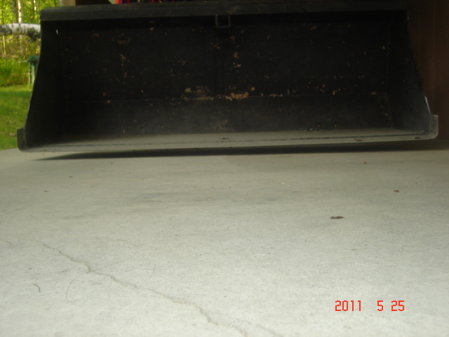

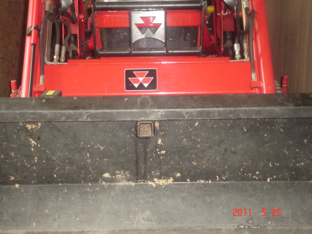

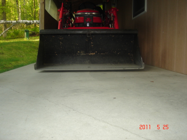

I've been convinced for some time that I have the same issue, and have gone through "the tires" route. Doesn't seem possible --they must use a jig, right??-- but when the brackets were welded to the back of the FEL, the right side bracket somehow ended up just a tad higher. Maybe.
Net result, the FEL sits just a bit lower on the right side, perhaps 5/16" to 3/8". I'm sure it's not my imagination. Makes back-dragging or "level-scooping" with the FEL a bit of a problem, as it always digs in a little more on the right.
Guess I'm not the only one who's been scratchin' my head!
So far I've just lived with it, but it is a minor aggravation at times. Unfortunately, I'm well past warranty at this point.
In the pics, the height difference is even noticeable when lining up the FEL with the red cross-bracket (pic #2); I really don't think it's in the arms, but rather the bucket itself.

Looks like the only adjustment, if it's that, is on the brackets that support the whole thing on the tractor- seven large bolts & locks. But they do look to be the same height on the frame, both with 1/16" clearance to the top edge of the frame. And, the bucket appears to be misaligned with the arms, which do appear to be level. I'll check that measurement as well.
I'll have to think on that some. Don't know, even, if there's any room for movement in the bolt holes in the frame, but that'll be worth a shot, at least. I'm still leaning toward the bucket brackets, which are welded on, being slightly different heights.

I dont agree with the few thousandths. You are talking parallel lines not angles. You will need the slop of half the height difference on each side of the anchor points to correct and I dont think you will find it in the anchor point holes. I think you are on the right track with the attachment point on the bucket welded wrong or one of the lift arms is shorter than the other.. From the photos, it looks like it is perfectly level with the frame cross brace.
