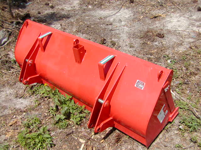

Mark,
I have used one like this for years. Put one on the bucket & one on a 3 point lift for the rear of the tractor. I started this way because I had an old 2-5/16 ball already welded to a piece of solid square steel with hole through it for pin. It came off of an old mobile home toter.
I normally leave the ball in the hitch of my goose neck trailer & can drive up to the trailer with front loader or rear hitch & hitch up without getting out of tractor, if no pin is needed.
Don't do hay any more but used to use bale spear on front & this type hitch on rear, pull the trailer to field, drop it, load with round bales, pick up one last bale with spear, back up to trailer, lift three point, & away we go to the hay shed. Never get out of the tractor to load or unload.
This is not very closeup, but notice the small cuts on the lower side. Makes it a lot easier to keep clean inside as well as not hold water.

   / Bucket mounted, class III, receiver hitch #4
That is slick!
Another idea stolen by wroughtn harv and in a couple of years I'll have someone look at that on my tractor and be convinced that I really am smart!!!!!
Seriously I've got two things welded all over everything I've got. One is reciever hitches and the other is floating D rings. You can never have too many of either or one in the wrong place.

   / Bucket mounted, class III, receiver hitch #9
Just looking at your picture of your receiver hitch here and notice that because of the angle of the bucket you had to cut the receiver at about 45 degrees. And unless you cut a square hole in your bucket, the hitch that your ball is on had better have the hole pretty close to the end or else the hole won't line-up for you. I'm not 100% sure but it seems like the holes on my hitch are 2-3" from the end and would bottom out before the holes lined up.
Of course, I'm sure you measured this long before you cut the receiver and I'm totally wrong, but I thought I'd just make a note of this for anyone thinking of mounting it on their bucket.

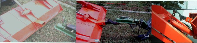

Mark, I mounted one on my BX2200 bota and it is one of the handiest additions I have done.
It is so handy to just drive up, pick up the trailer and put it where you need it.
I don't even have to pull the hitch out of the receiver if I think I will need it a little later, it doesn't bother any thing or get in the way .
Makes me wish I had hitches on my implements so I could move them as easy as a trailer.
