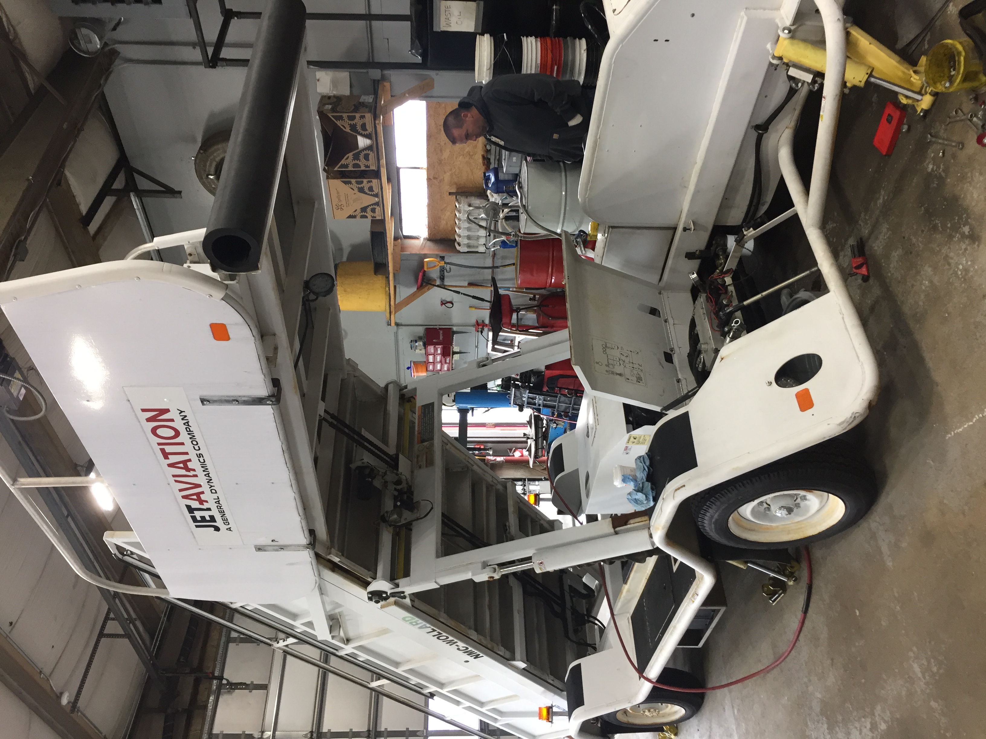

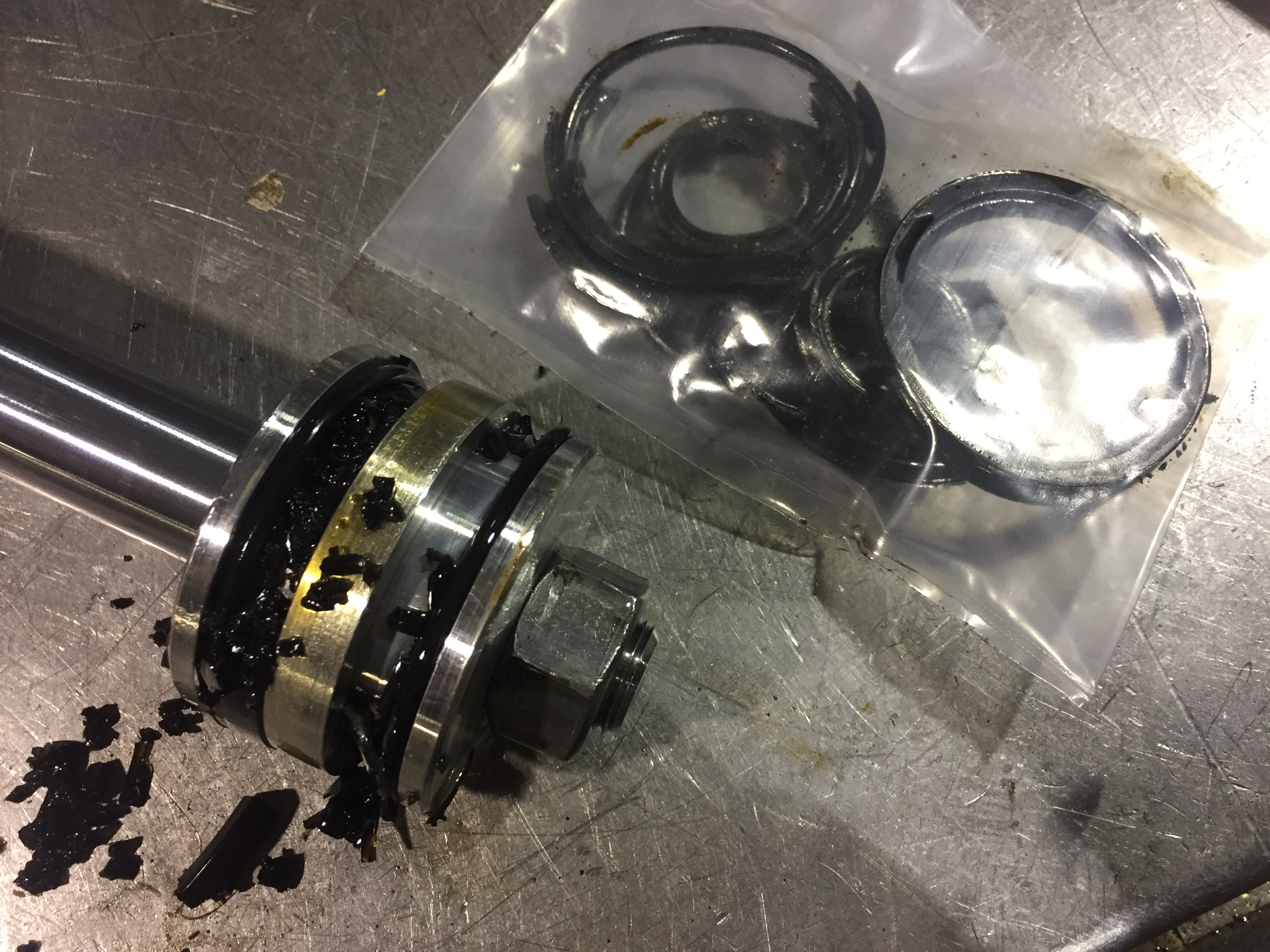

Here is a good example, this and 4 others with the same issue was diagnosed as a bad control valve, when the new control valve was installed the previous two mechanics gave up. It took me minutes to diagnose and and all 5 cylinders had completely rotten seals.
These were stabilizers on a mobile stairway truck at a local airstrip, the complaint was they were holding a load extended out under pressure but would settle down after they were retracted.
