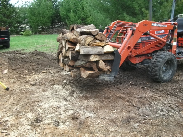

   / Bucket Load of Firewood; Weight.?? #8
How you stack it factors in also. I figure I can get almost a face cord in my 5' bucket.

I would figure about a tenth of a cord if they are 16" sticks. (4.5'X2'X1.33')
Green beech is about 5000# per cord so you have no more than 500#. The 300# to 400# guess by KennyG is probably just about right.
