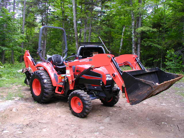

   / Bucket level rod indicator #2
HERES THE INDICATOR ON A WOODS FEL. THE BEND IN THE ROD INDICATES HORIZONTAL
Thanks Kevin,
I should have been more specific.The location I'm looking for is down near the bucket.
BTW, Nice machine you've got there.

   / Bucket level rod indicator #5
I have the 1012 loader and am very pleased so far. Unfortunately, I haven't had alot of time to play with it. I am researching now hooking up aux. hydraulics to the FEL for things like a 4-1 bucket or grapple
