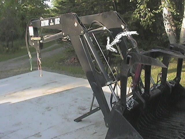

I have the C50-HL loader, which is fine, but it has taken me all this time to notice that it doesn't have a bucket level indicator. Should it have ?
Does anyone else have this loader WITHOUT a bucket level indicator ?

Humpolec is OEM for my Zetor. Pix of the rod attached. It is sized for the standard bucket but I usually have my rock/grapple bucket on it.

the bucket level indicator on mine is a piece of bent sheet metal that almost rubs the metal rod in Barry's picture - I set the bucket level and wrapped a loop of electrical tape around the rod to mark the spot where the sheet metal hit it. Not real high tech, but works pretty well.
You may actually have the level indicator on your loader arm, just need to loosen the bolt, rotate it 90 degrees, then tighten the bolt.
