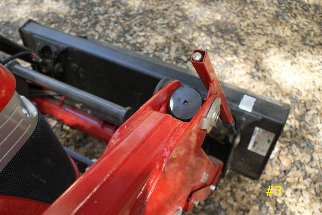

did a quick search did not find answers, but I did not dig into it much.
anyone know of an indicator for DL100 loader?

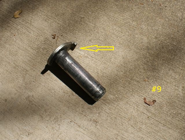

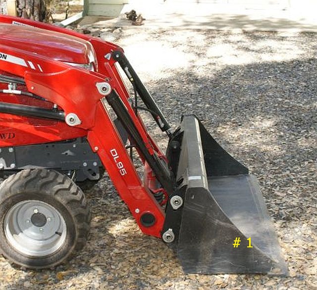

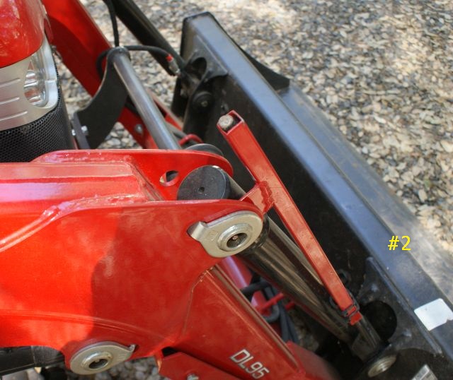

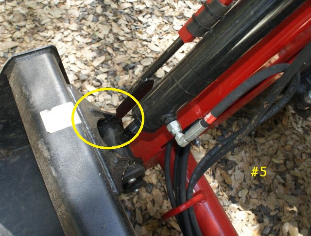

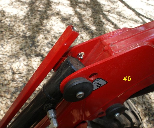

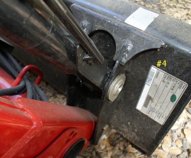

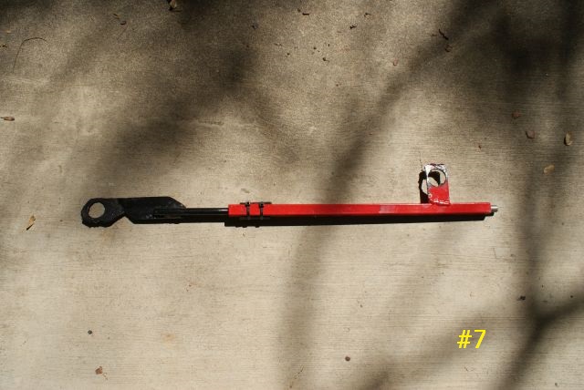

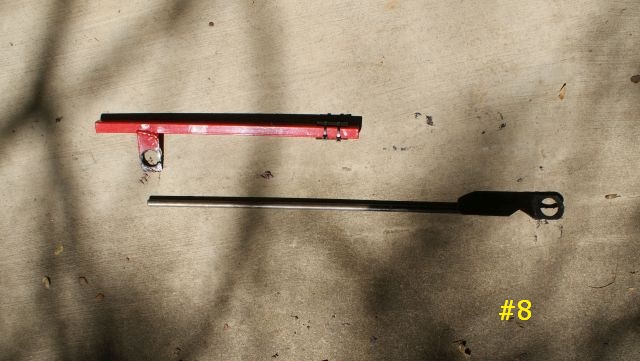

I have the ones for my DL 95 posted in several places, concept should work on DL 100.... Might be in the "Customization" portion of forum, was posted a year or two ago....
But....
Essentially with this rod and tube design when end of rod is even with end of tube the bucket is "level" (flat on ground) [pic #2 & #6]... And yes I know round peg in square hole.... But square tube was all I had that fit the rod well.... And all was scrap pile parts... Maybe spend $1 on MIG wire and electricity....
Dale
