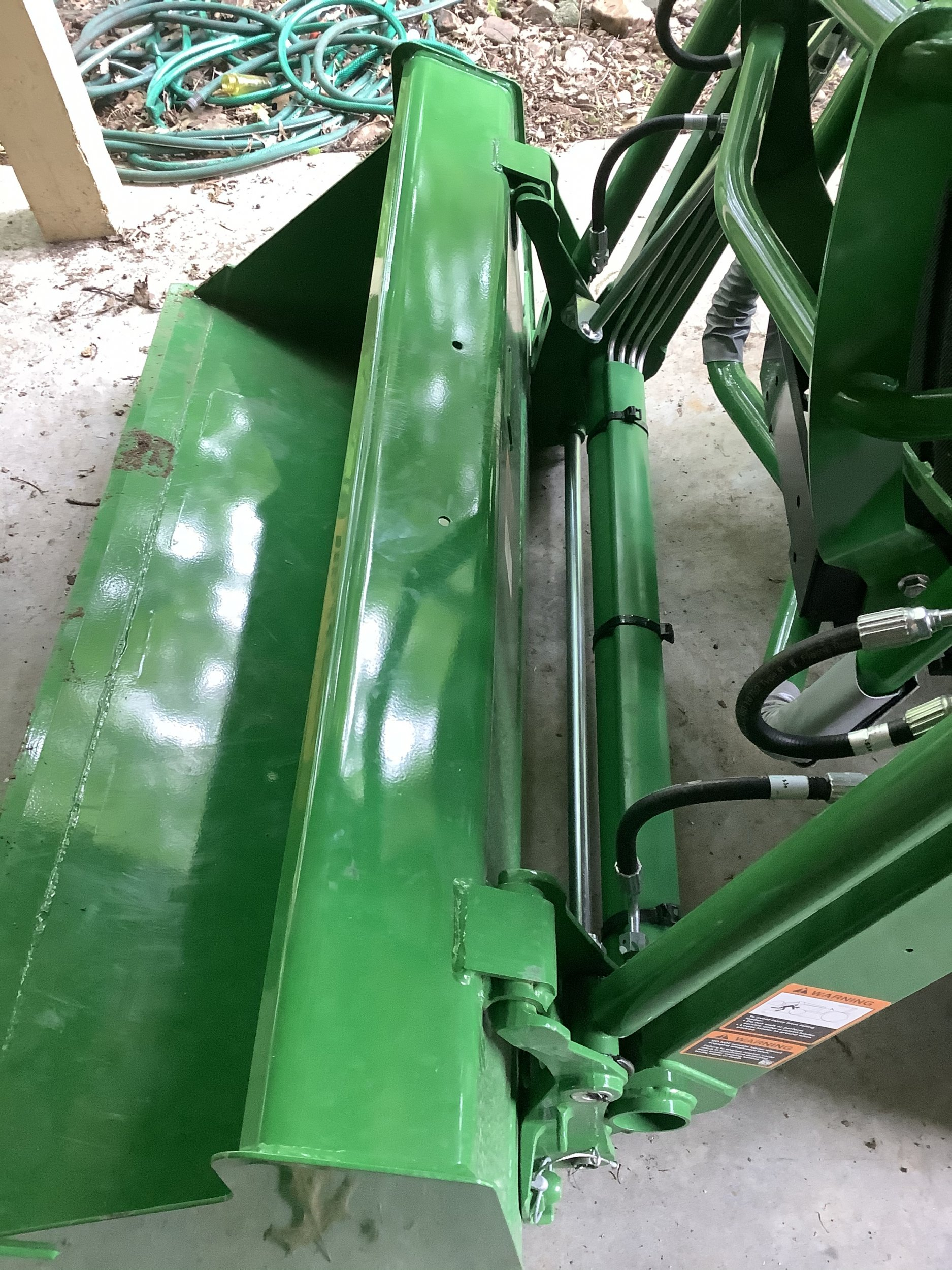

I have two holes on top of my bucket. Came this way new. Do these have a specific purpose?

Does not look like the heavy duty bucket, so I wouldn't place hooks there without some reinforcement added on the underside.
No idea why.

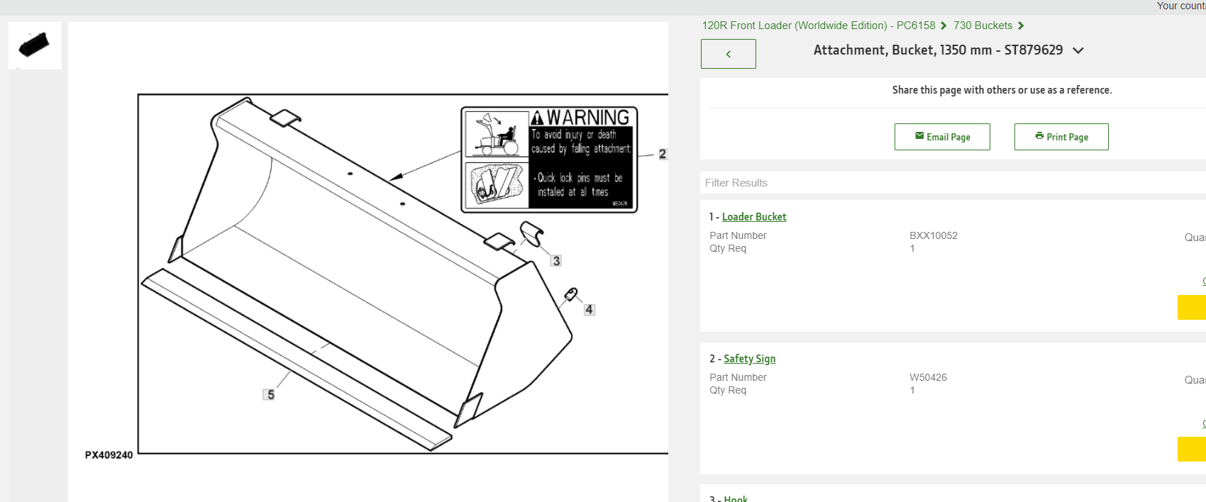

It appears from viewing 120R PC to be factory made holes.

Interesting .... I’m curious what the purpose is? Is there something designed to mount there? The holes are painted on the inside.

Perhaps it's for some type of fixture locating holes used during manufacturing for robotic bending-welding.
Could be as simple as a point to attach a stout angle iron for a center hook for owners that don't weld or want to mess up the paint. 🤔

They are used to bolt the bucket to the loader when they ship them from the factory. We have an XL pate that uses them in addition to drilling two or four more to mount a hook or receiver hitch.
