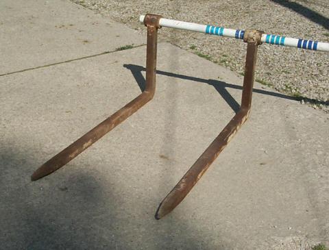

Would forks like this work for you? They mount on a 2" pipe. There solid steel. Weigh 75 Lbs. each. My thoughts would be to weld tabs for a three point set up. Or fabricate some brackets to mount across the top of a bucket that would cradle a 2" pipe. I Picked them up from a scrap dealer for $50.
See attachment.
Don
