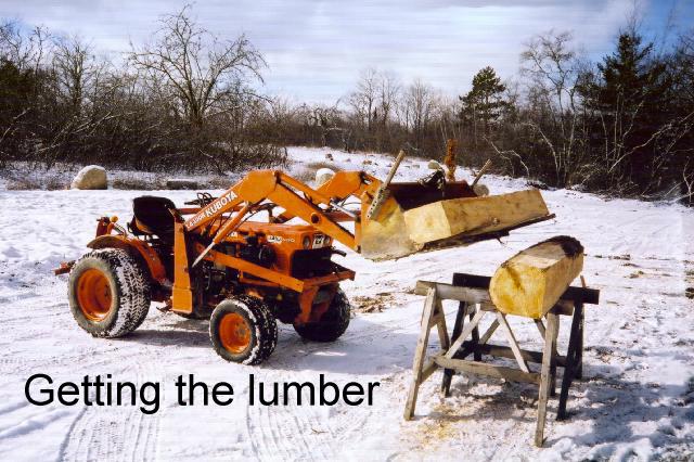

I have some homebuilt forks for my 16 HP Kubota B7100. They are truck springs bolted to reinforced portions of the bucket. They serve me well. They come in handy for lifting logs within the weight limits and have even been used to spade a garden. They also work well for removing stumps.:D
