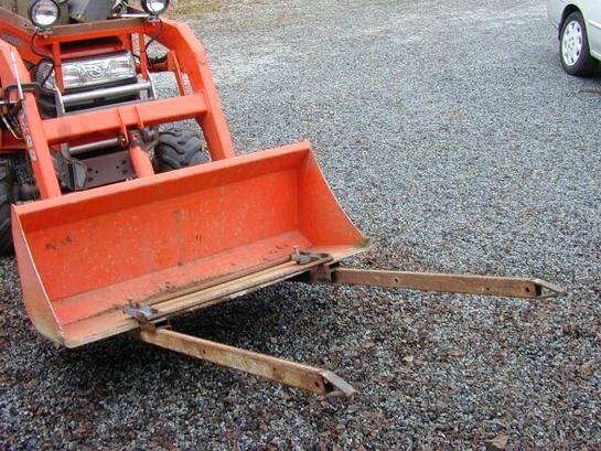

And, if you want to know what you can "get away with" as opposed to what looks cool and extra beefy ... here's my, literally globbed together bucket forks. They are 1" x 2" 16 ga tubing. I "just needed them for one job" ... that was 2 years ago. They only weigh about 20#, lift anything the BX can and even withstand being rammed into the dirt. Ugly, but impressive performance.
