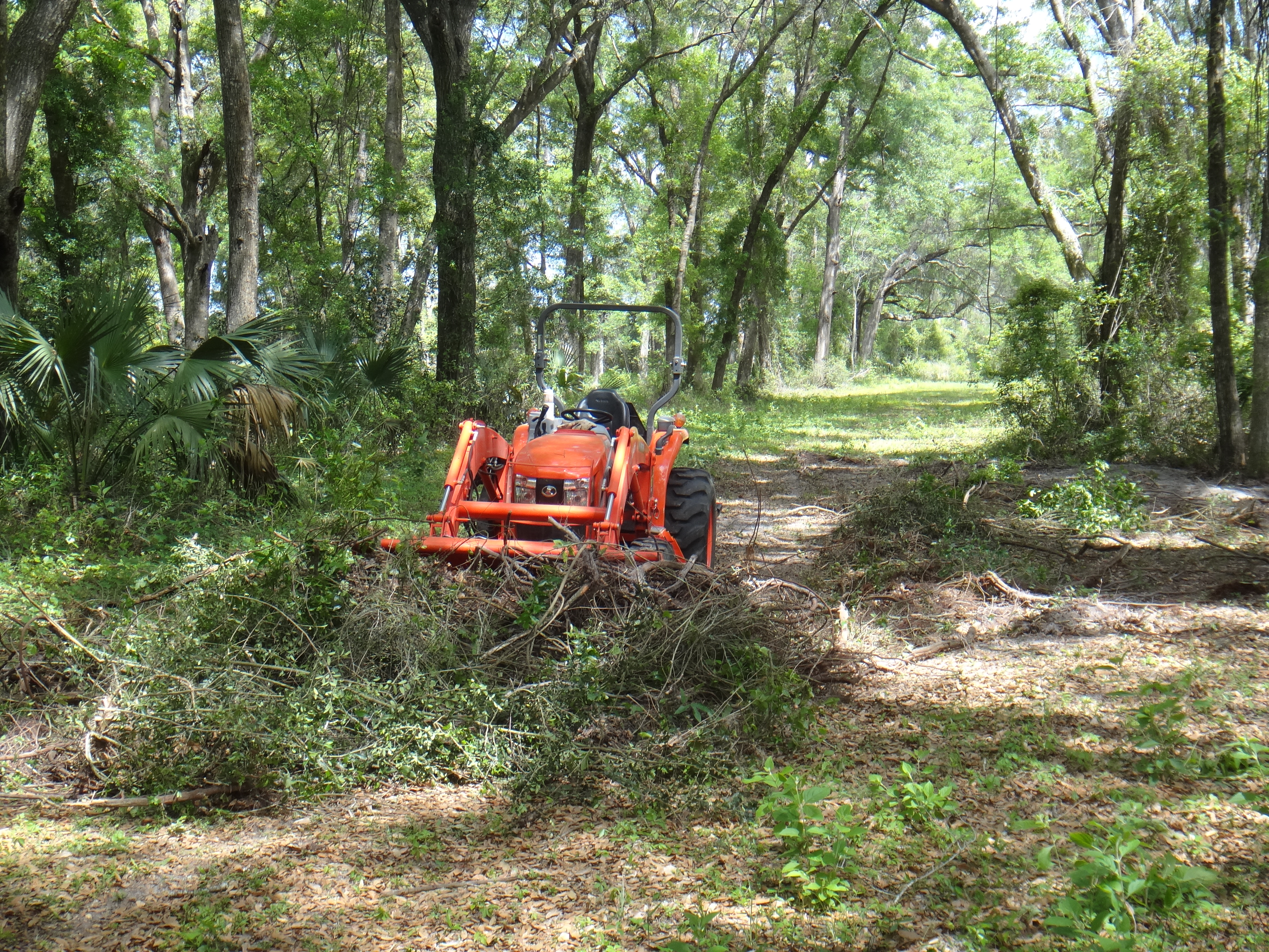

If you ever used a grapple you would wonder why you never bought one years ago. Cleaning up brush is a breeze I can tilt the grapple down as far as it will go and keep the prongs right at ground level move along slow and it will pick up almost everything in its path then close the grapple pick it up and go.haul logs or whatever there is so many uses for a grapple saves tons of back breaking work I will never ever be without one ever again.
I put a grapple on my tractor a few years ago...hands don the most useful implement I have. Used it this past weekend to pick up all the piles of branches and drop them at the fire. It's so easy and fast..it's like cheating.

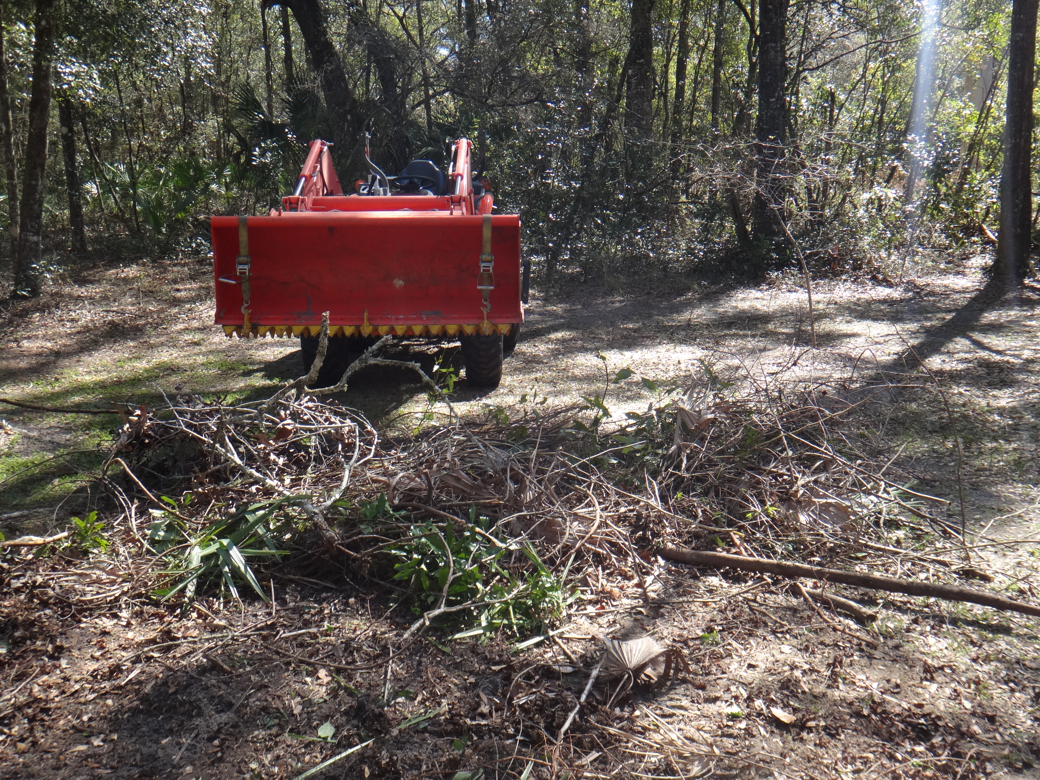

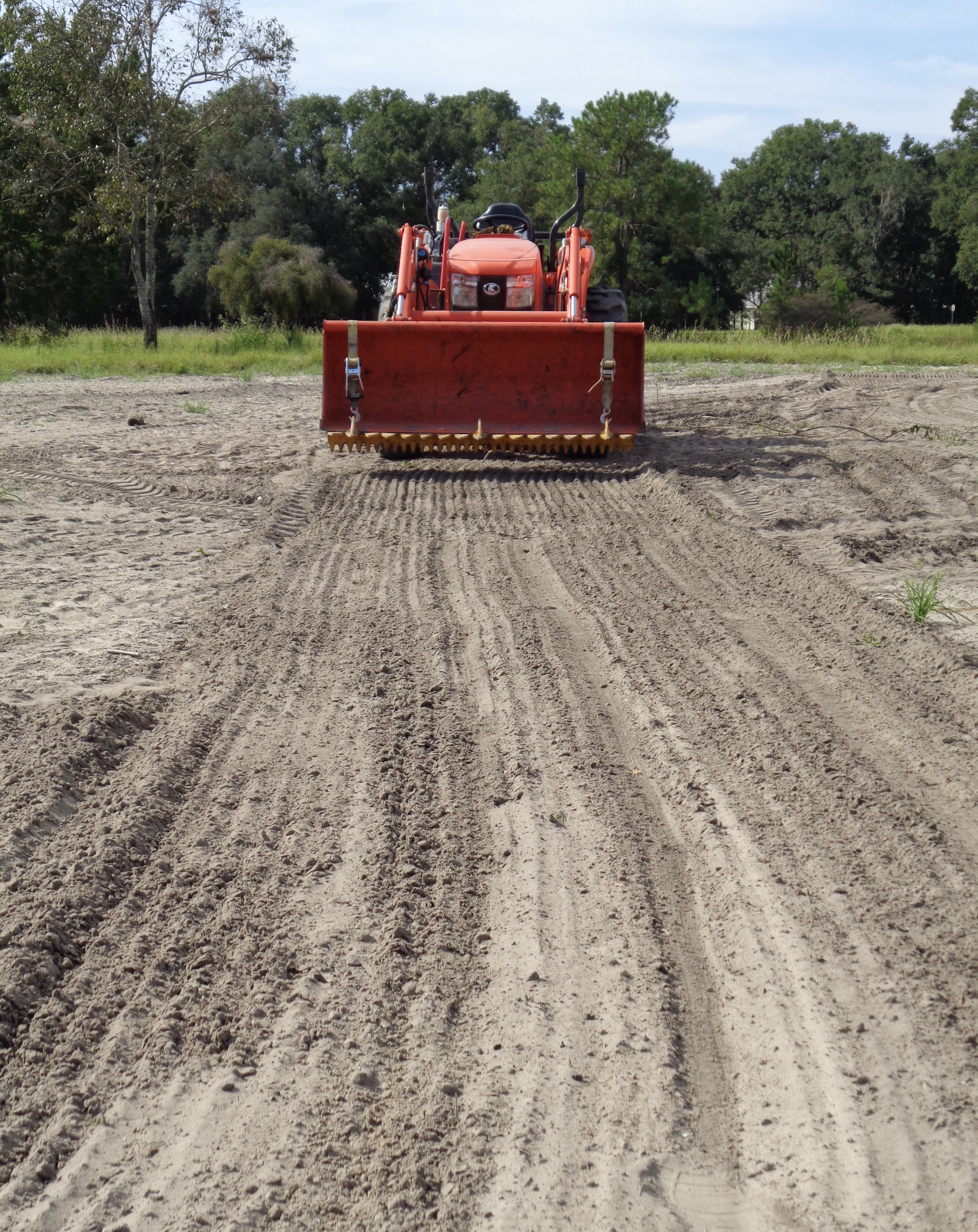

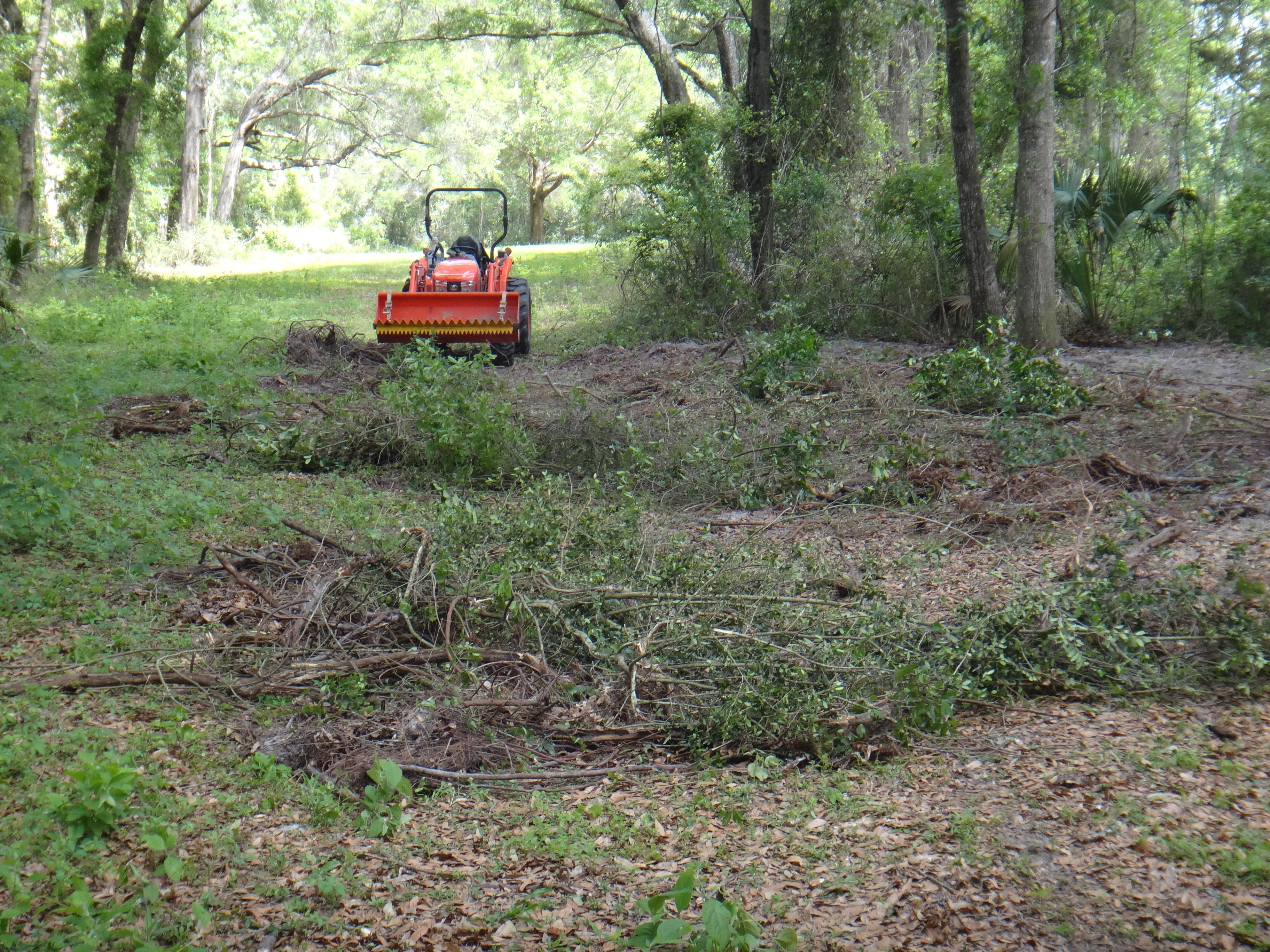

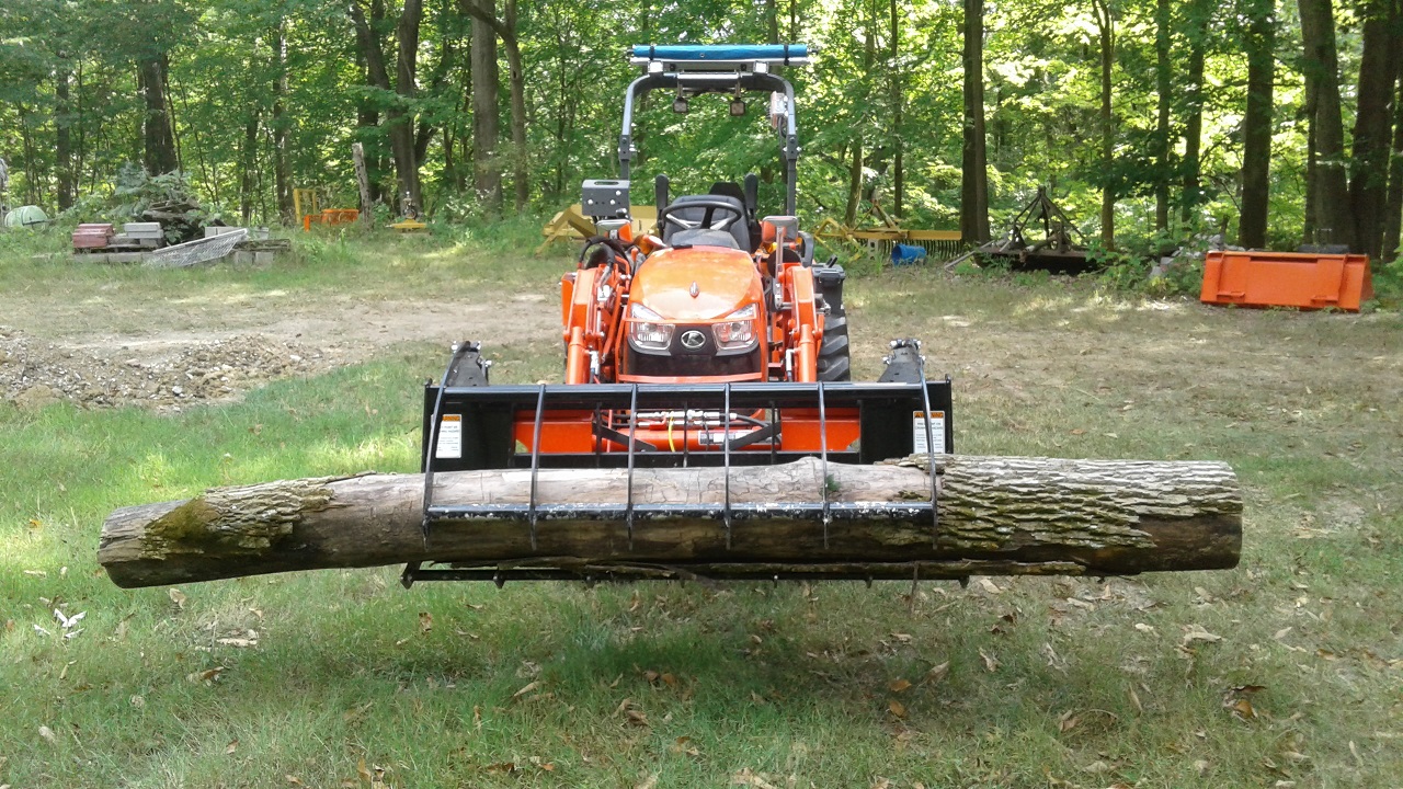

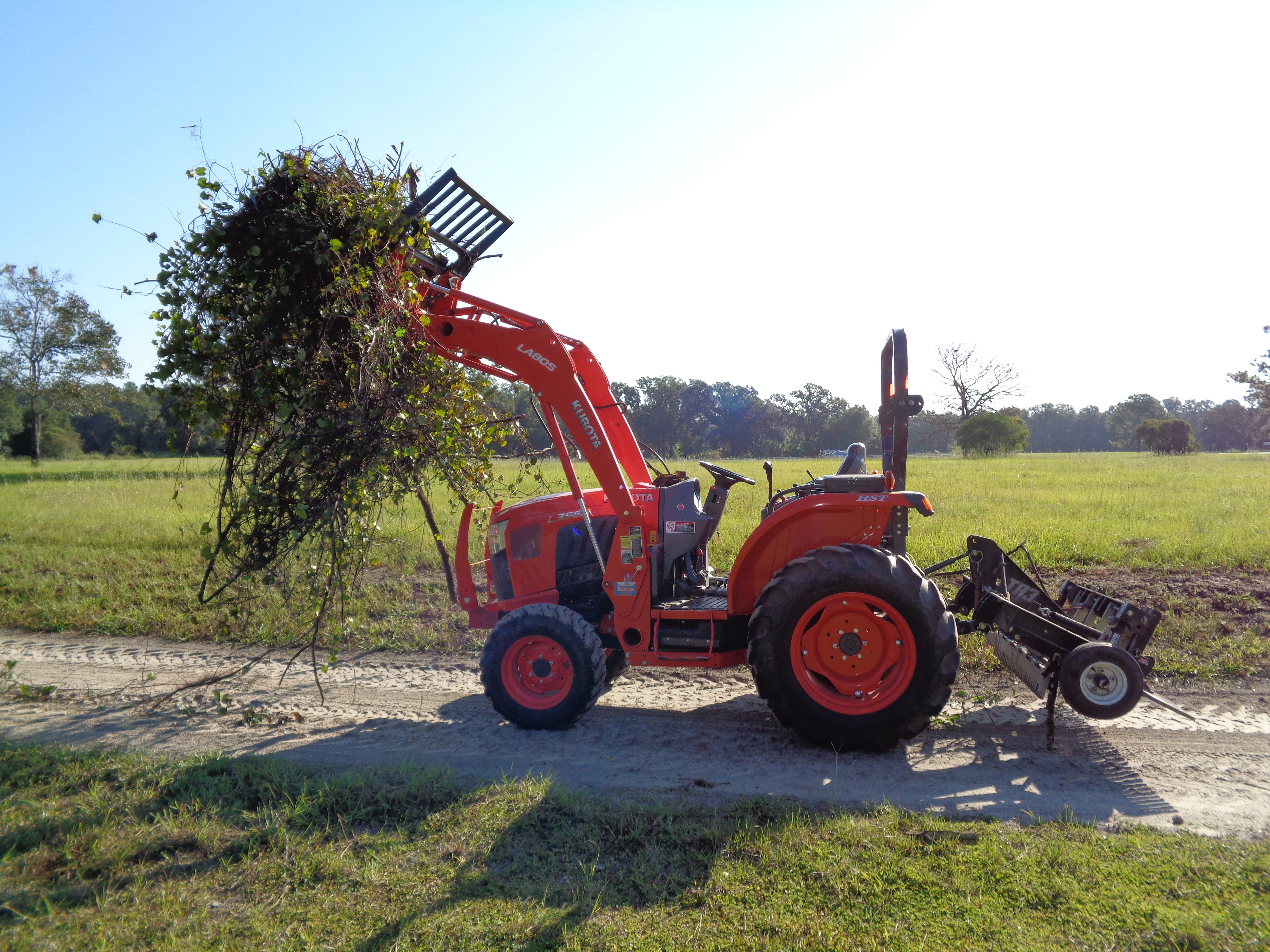

+1 for the grapple. If you were picking up split and cut firewood a rock bucket would work nicely. Never tried one on brush. Bradco makes this style of bucket.

For that little stuff you need something that will slide under and pick up the debris when you curl and lift. There is one picture on this thread that would be perfect for what you want. Old leaf Springs welded onto a carrier that attaches to the bucket will also work. Or, bolt the springs to the bucket. You can also use them to pick up logs. Make sure you have some bars on the back top of the bucket so logs can’t roll back and sit on your lap.
