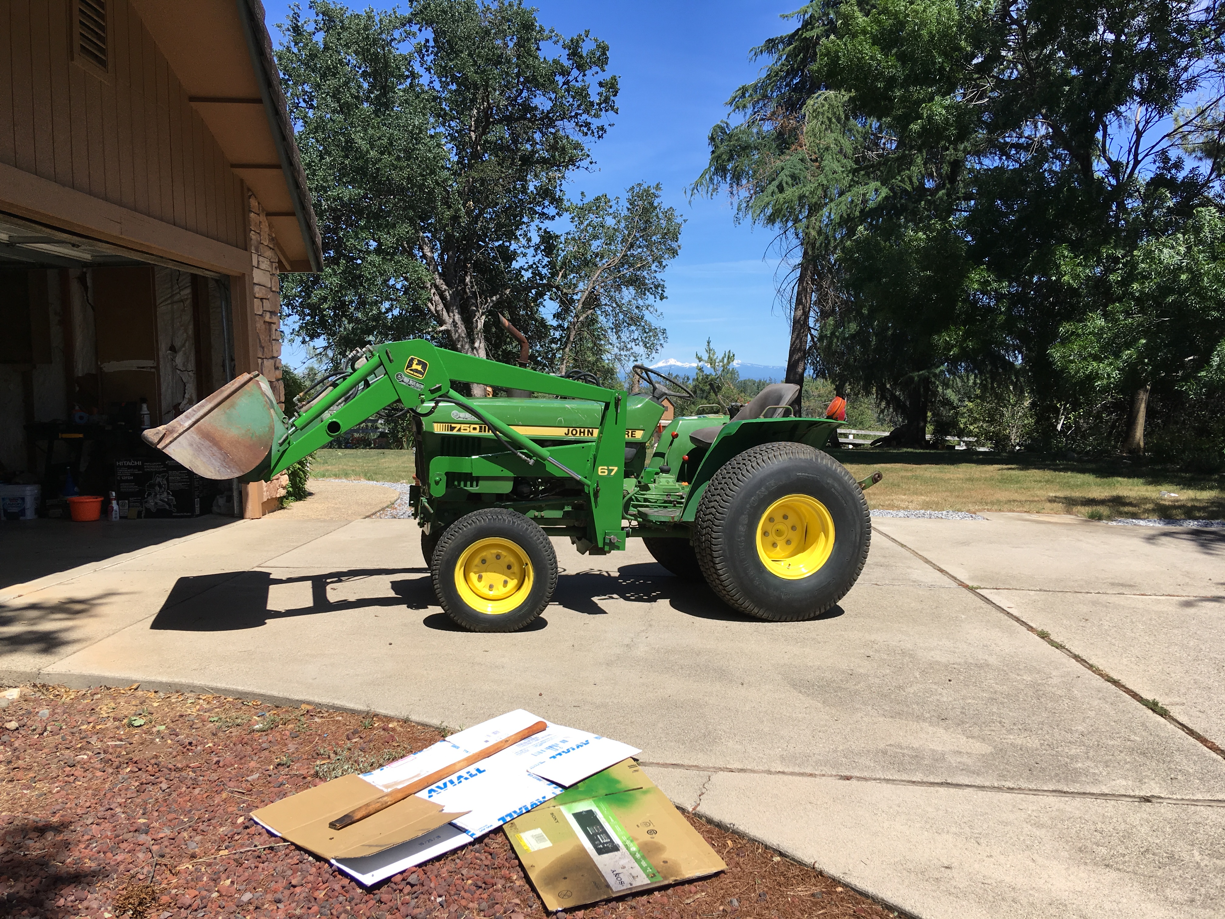

There are a gaggle of posts about this somewhere here but I did not find it.
Noted my new to me JD750 bucket dropping while brush hogging after parking noted fluid leak at left boom lift cylinder. Removed it and brought it to my shop and resealed it and reinstalled. Drained fluid, cleaned filter and cycled system, bucket and curl both sag, no external leaks, system weak will not lift front of tractor.
Next step, rebuild other three cylinders, or go after control valve? Thoughts?
The new actuator looked so good with new paint I spent the rest of the weekend painting the whole FEL

Probably the first thing to do is get a pressure gauge and start checking pressures to see why the loader is weak. How much is it drooping in say 5 minutes?
   / Bucket droop
Mr.4720, Drop significant. will drop a couple feet in five minutes. May consider putting a heavy load in bucket, raise bucket and shut off tractor and see if I can hear internal leakage with a stethoscope.
The rebuild kit I received from JD had a really hard seal for the inner piston, I struggled getting this in place as it was so stiff, it had an "o"ring in the back of the seal that kept popping out. We where able to message it back in place, hope it did not get cut in process.
That is Mount Lassen in back ground.

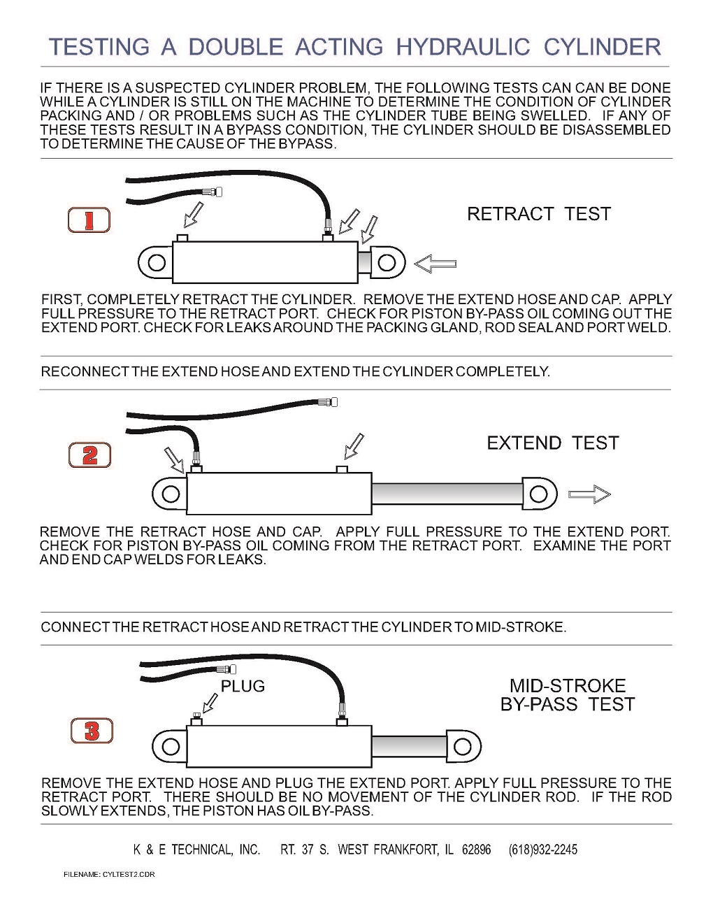

The relief valve in the loader valve is not in the loader circuit when the loader controls are in the middle or neutral position so it is not going to be the cause of all your issues. Same for the main relief valve.
I have posted a procedure for checking the double acting cylinders which others have found helpful.
Rule out the bucket control valve by swapping lift arm hoses for bucket hoses. If the problem remains with the bucket drooping, then the problem is not in the valve.
Dave M7040
