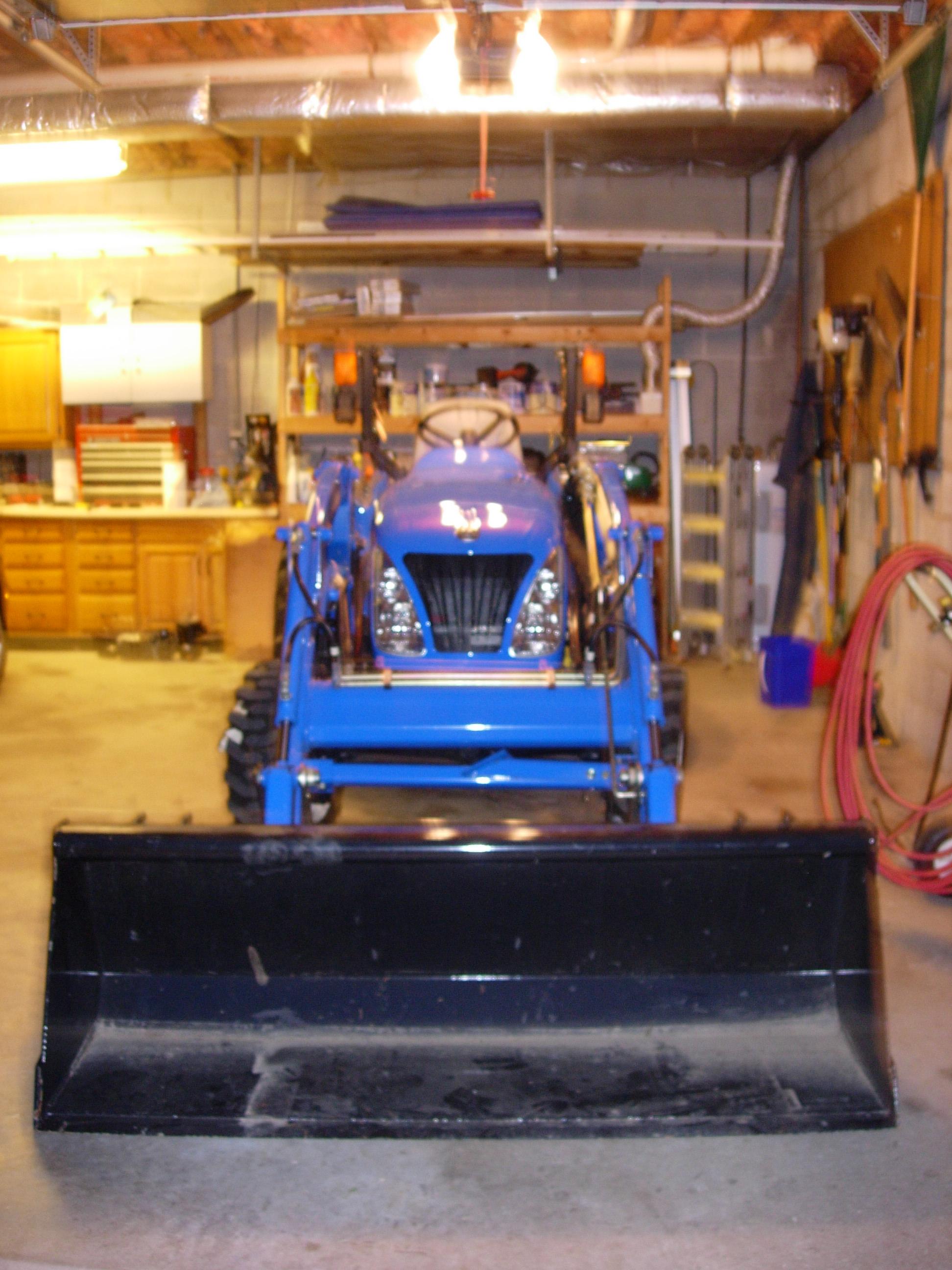

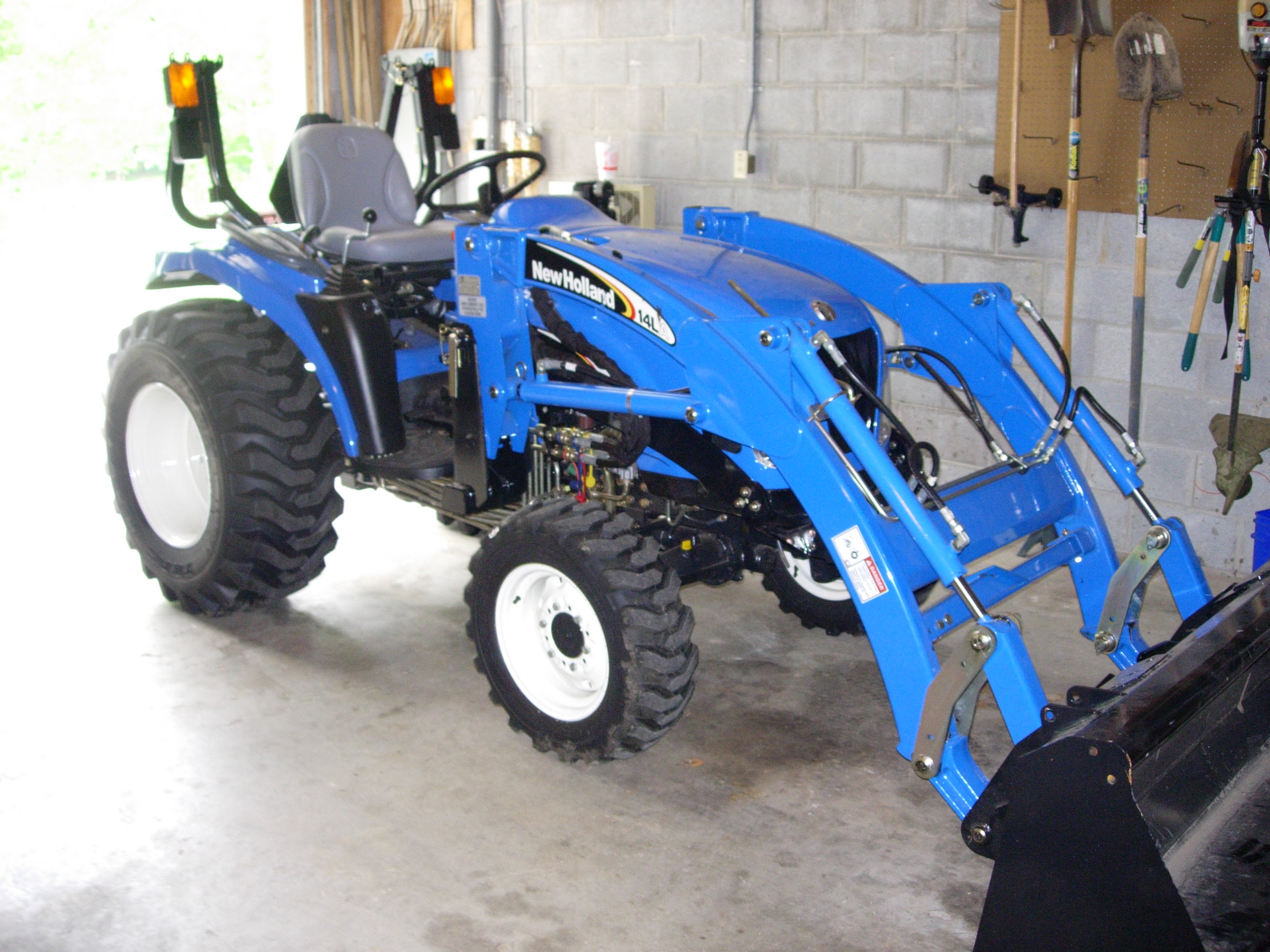

Ok, So I finally broke down and pulled the tigger on a tractor. Though I wanted to justify the larger frame 35/40/45 series, after demoing a 35 on my property, (2.5 ac fairly hilly) the TC34DA just made more sense. Really happy with the choice. Additional goodies are the 14LA loader w/quick attach and a 60" RFM.
Usually, I ascribe to the bigger is better mentality, but when I scaled back chassis size, I decided to go from a 72" RFM to a 60" RFM - but in hindsight think I should have stayed w/the larger to cut further outside of the wheels.
Question now is the bucket size. I think/thought I wanted a 60" HD bucket for the loader (scaling back again), but the tractor already had the 68" HD bucket, so the dealer went ahead and delivered it with the larger bucket until the 60" comes in. After about 2 weeks of use, I'm questioning the desire for the 60" bucket.
Would love to hear your personal preferences/pros/cons to either choice???

Pics in advance ... cause I know your gonna ask...
   / Bucket Choices 68" or 60"
68" Bucket

Personally, if your tractor handles the 68" bucket, I'd stick with that. You'll have more capacity for less dense material that does not exceed your lifting capability when that bucket is full. Your comment about working around buildings and such is a good one. Another thing to keep in mind is when you dig with the bucket, you want the path wider than the rest of your tractor so you can drive into and through or out of it. Maybe wide enough to accomodate anything you've got on the 3pt as well. From the photos, it appears like either bucket will do that, I think, but you'll have to clarify it.
