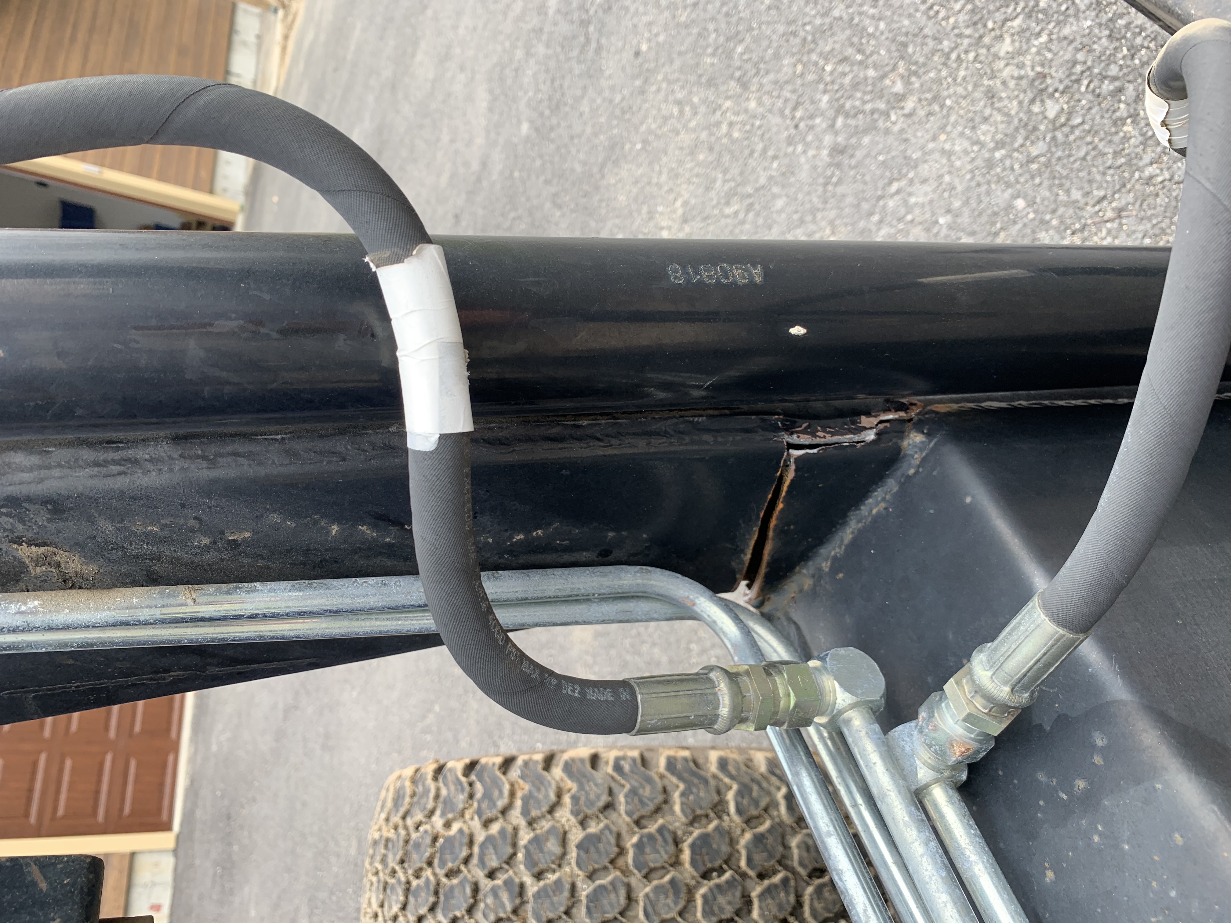

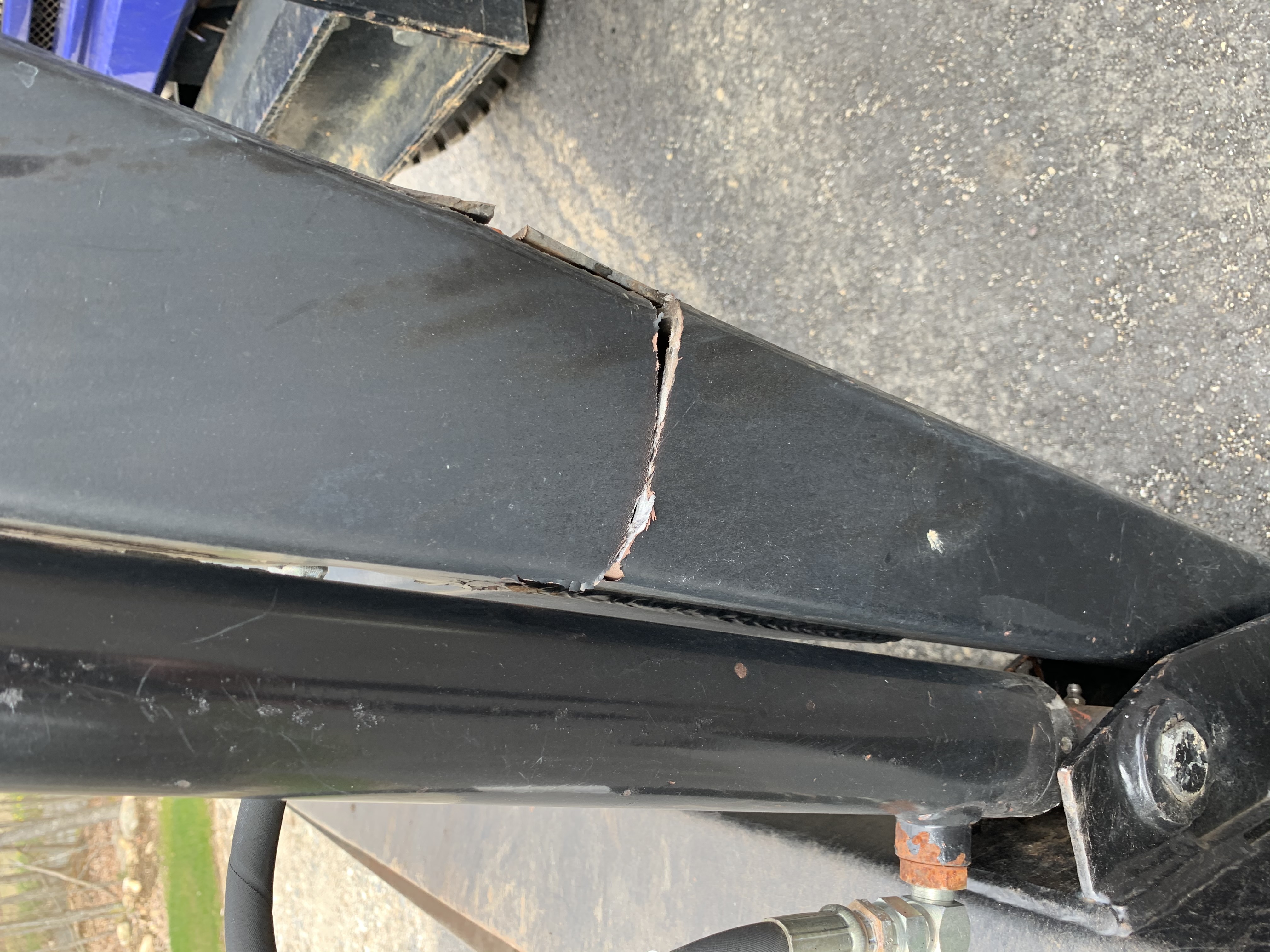

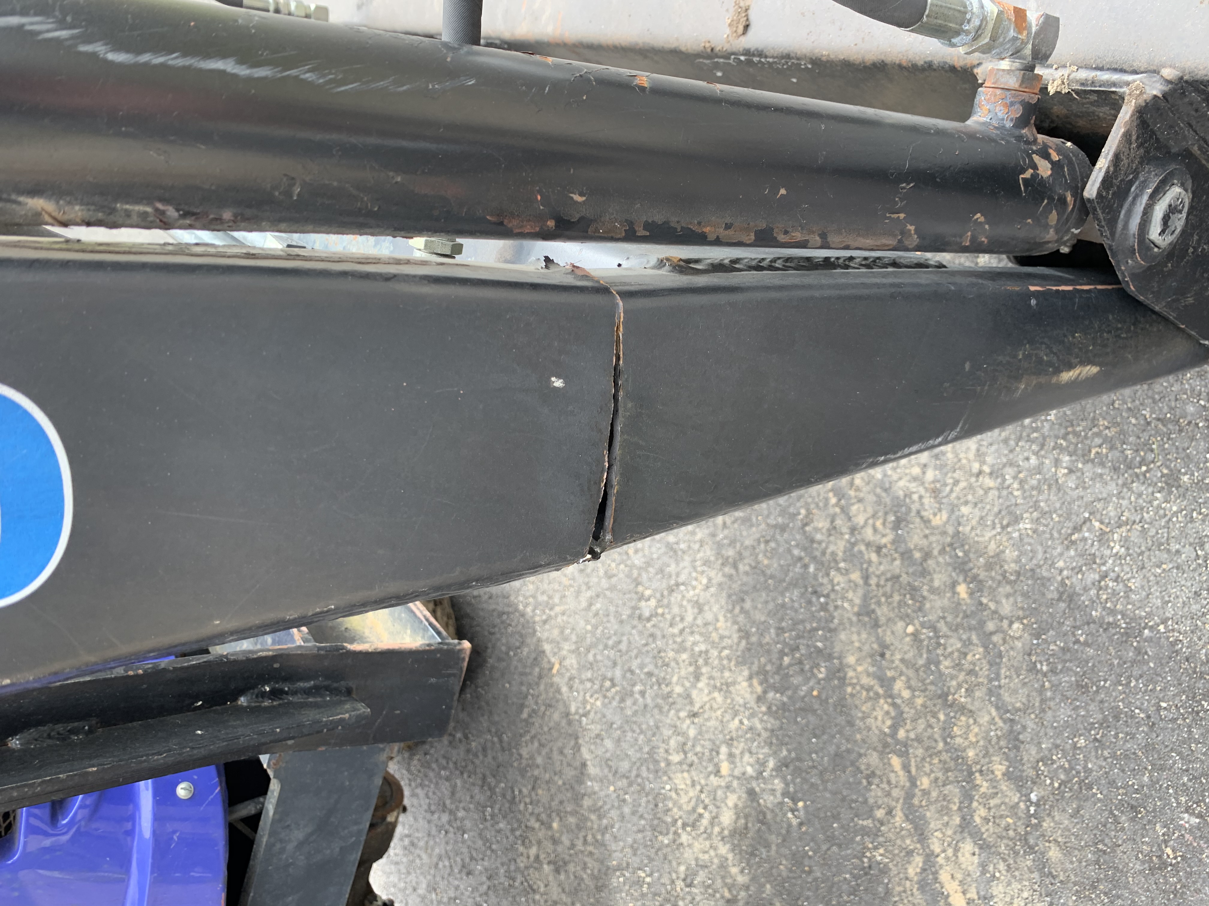

As you can see, the bucket arms broke on my Long 5140 front loader. Same spot both sides. What's my next move? See if someone can weld them? Replace them completely? Scrap the whole thing (hydraulics work fine)?

It's repairable. I would grind some fillets for the weld, bent it back straight, weld and then add some fish plates to reinforce the area. Coat of paint and it's good again.

A few years ago I would have welded that back for you, and assure you it wouldn`t part again. By looking at you pictures, it looks strange that it parted so clean and straight, its as though its been welded together and the weld has failed. Yep, `V` it out, reweld, and if there is room, add a strengthened flat, it will be stronger than new.

High stress concentration in that area apparently with that crossmember between the arms since it looks to have started the crack right at the crossmember, probably started from the heat of welding the crossmember in coupled with the constant bending driving around with a load in the bucket right at that spot.
I agree with everyone else though, a competent welder that lines everything back up, vee's it out, welds it back up and fish plates the three accessible sides (doesn't look like there's room on the cylinder side) with the cylinders loose should be stronger than new.

I can picture a twisting that was concentrated at the end of where the crossmember is attached. Without being able to have equal loading on the FEL, as one side has more weight on it the box formed by the crossmember and loader arms tries to twist. That box shape stays fairly rigid and the flex takes place at the upper connection of the cross member / loader arm. Each time this happens it slightly stresses that metal.

Good advice given and- definitely agree with fish plating the outside of the lift arms,
also you may want to drill a small hole at the bottom of each arm.
Zoom into the far right side of your bottom/last picture.
It appears the tube is swollen, a sign water has intruded and frozen at some point, causing distortion of the welded tube.
My Ford 3000 loader did that and drilling small holes allowed the water to drain which stopped the distortion/damage when freezing.

That's been failing for a while and just recently let go. You can see the rust in the break on the right side, everything else is clean. That's an easy fix. The price for the mobile welder isn't bad at all. Way cheaper than a whole new loader. As others have said, V it out, tack it straight, burn it in. Grind welds flush, fishplate. I like rounded off fishplates with a hole in the center so I can plug weld it. You get more weld surface that way which makes it stronger. Never had one fail doing it like that.

Common stress point on loaders, I repaired one of my buddy's, 1986 Kubota 2850 with Woods Du-Al 105 loader. Many years of being used beyond design ratings (read: heavy abuse by many, including myself!) lead to the left arm breaking off like this one posted, I repaired as described, welded where broke, plated over welded seam, added gusset in corner from horizontal member to loader arm, and returned to service. The other side had been broken also, and repaired previously.
$500-$600 for a competent welder to come to you and make quality repairs is reasonable in my book. I would prefer the repairs take place with the loader still on the tractor, to ensure correct alignment and no twisted frame issues.
