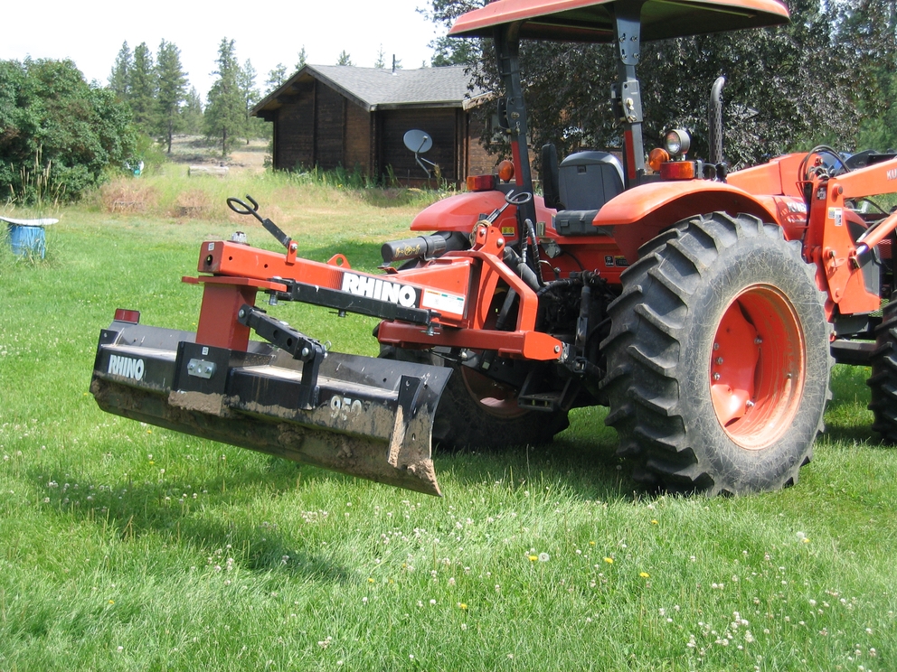

I've owned/used two brands of rear blade. Both were excellent quality. Land Pride and Rhino. When I upgraded to my Kubota M6040 I went with a MUCH heavier Rhino rear blade.
Just a matter of choice. I found that the lighter Land Pride just was not capable of cutting into my concrete-like driveway. So I went with Rhino. Different brand - MUCH heavier blade.
