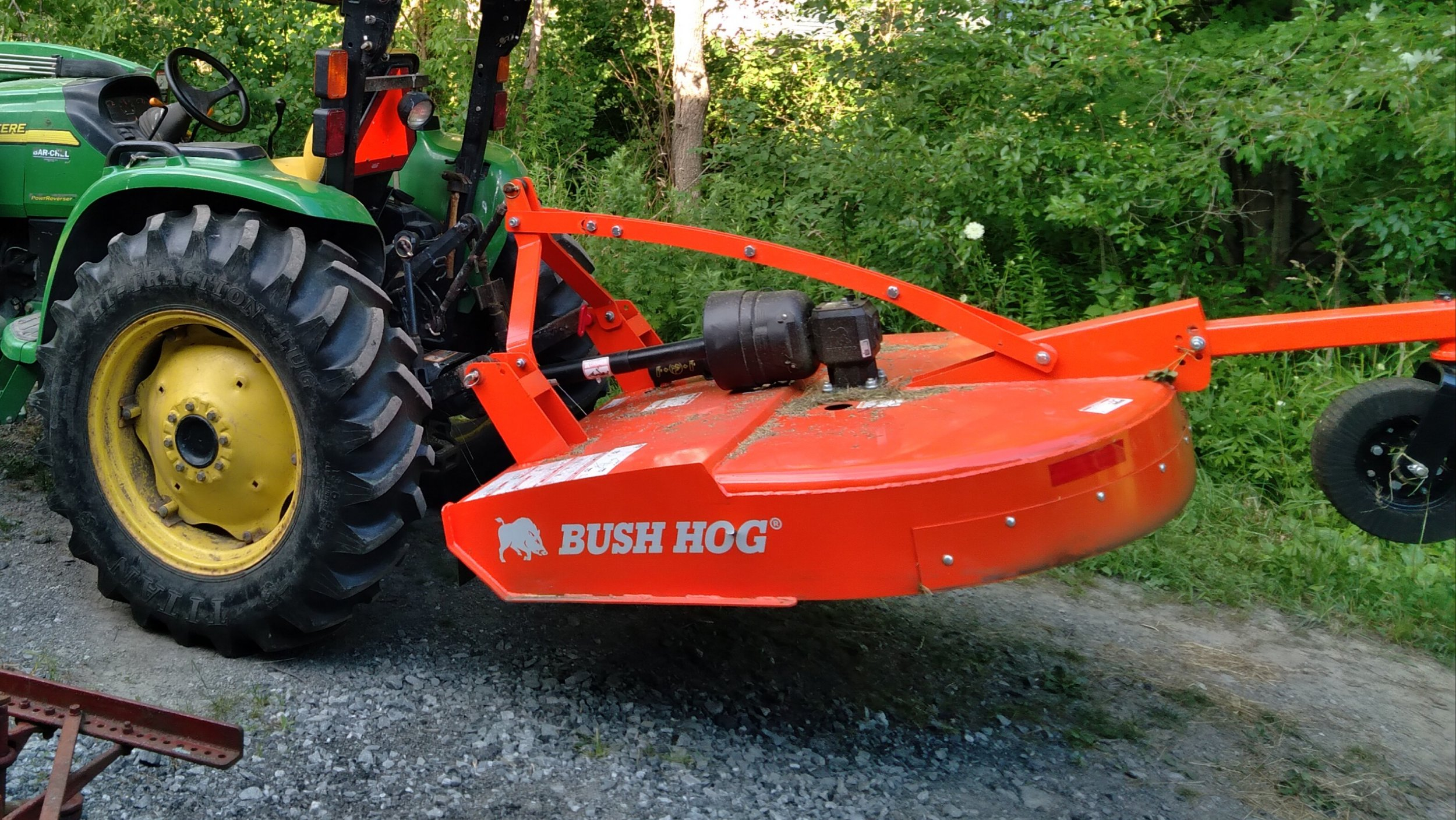

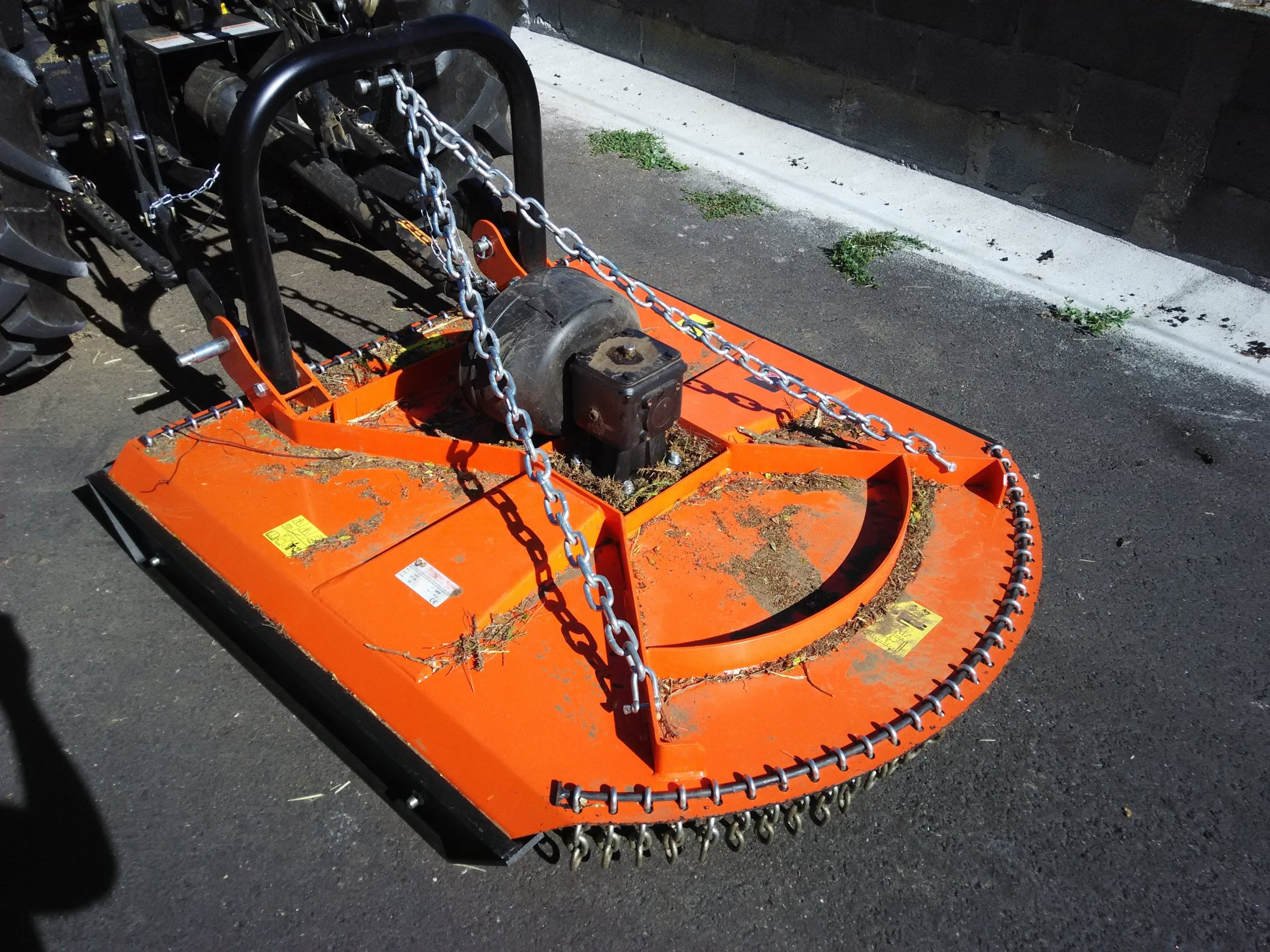

I have a John Deere 4520 with a 6' Woods BB72 mower on the back. I've been mowing fields for more than 20 years and have Never had this problem. Whenever I mow a field, that mower leaves clumps of cut grass. I had a 6' Bush Hog that I used and readily liked until the slip clutch didn't slip once and it got completely destroyed. That never left clumps like this Woods does. I'm mowing in the same gear, doing everything The same but getting clumps. Should I remove that plate in the back to let the cut stuff out? This really bugs me. Any ideas?
   / Brush hogging #2
Try making sure the rear is ~1" higher than the front first, but removing that plate would let the grass fly if needed.
   / Brush hogging #3
When was the last time the blades were sharpened?
Is the mower tail wheel in continuous light contact with the ground, or bouncing in and out of ground contact, discharging on the lifts?
The deck of your Woods mower may be somewhat deeper than the deck of your previous mower. Try making the rear of the mower 2" higher than the front of the mower.
   / Brush hogging #4
Mower higher in back than front (1-2”) - if that doesn’t work,
Then remove the plate!
You may need to change the top link attachment point on the tractor end to facilitate getting the mower higher in the rear.
I have a BB84 and it will leave clumps if the rear plate it installed on the back. Same with my landpride RCR1872. The cutter can't discharge the material fast enough so it balls it up and spits it out in clumps. Remove the plate and you should have the result you are looking for.
   / Brush hogging #10
I agree with the others on taking that plate on the back of the mower. It doesn't even make sense to me why would they use a plate on an area where the material needs to come out..
If you see that it's throwing stuff way too far or to the point of being too dangerous, build a chain skirt for it.
