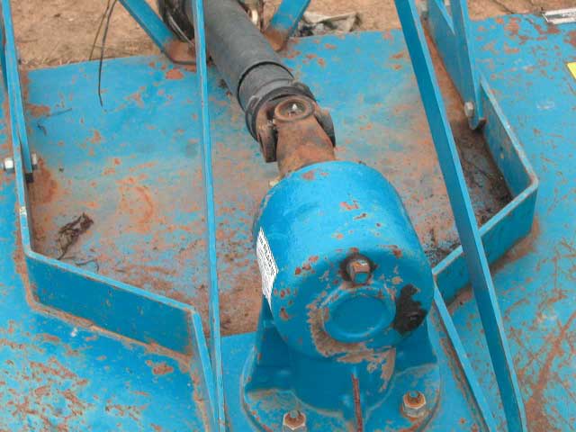

1952 Ford 8N
Just got an old brush hog. Unscrewed a square bolt to check for oil and didn't see any. Not sure how much oil to add and what type of oil? It is a Ford 951 5' brush hog. Looks like there is a small hole below and to the right of the bolt where oil has come out of in the past...is that the fill line?

Yes.
Put gear oil (85/90 or 85/140 or similar) into the top hole till it comes out the bottom/fill line hole.
When it starts to come out the fill line hole the gearbox is full.
Try not to overfill by to much or you run the chance of pushing a seal out when the gearbox gets hot..

I'll add that the top plug is often not just a plain plug, but has a venting mechanism. This allows pressure to escape without blowing the seals.
/ Brush Hog Lube #5
Yep.. But I've seen cheap ones that used a simple fixed plug.. and I've also seen a vent cap plug up.. so try not to count on it.. or at least service the vent cap in a can of mineran spirits to clean it, when you do your annual tractor maintenance..

How do you drain old oil out of the thing? Soundguy you have a 951, correct?

Hydraulic fluid is a very thin oil compared to gear oil, so personally, I would not consider using it in a brush hog gear box.

You can either tilt it over and let it drain ( use boom pole or FEL ) Or you can use a battery water suction buld to suck the oil out... or similar device.
That 951 is a superior machine. i ran 85/140 lube in mine.

Right now I don't have any means to drain the existing lube. Do some people just top it off every so often and call it good? Could I get by with this for awhile until I have a means to drain it?
/ Brush Hog Lube #13
As long as it does not look contaminated.. I'd just top off and go.
Water contamination will show up as an emulsion.. like a milky look.
Dirt contamination would be obvious.
Run a clean rod it there and draw it out and look at the oil. If it looks like 'good' clean oil.. fill to the correct level and go.
