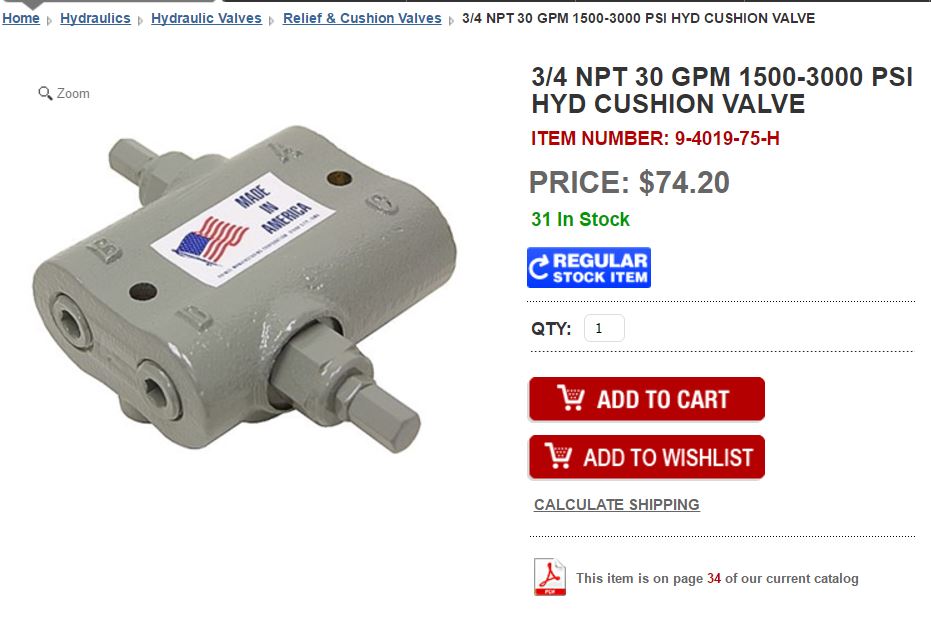

   / Brush Hog conversion from PTO to Hydraulic #9
And don't forget the cushion valve: 3/4 NPT 3 GPM 15-3 PSI HYD CUSHION VALVE | Relief & Cushion Valves | Hydraulic Valves | Hydraulics | www.surpluscenter.com
