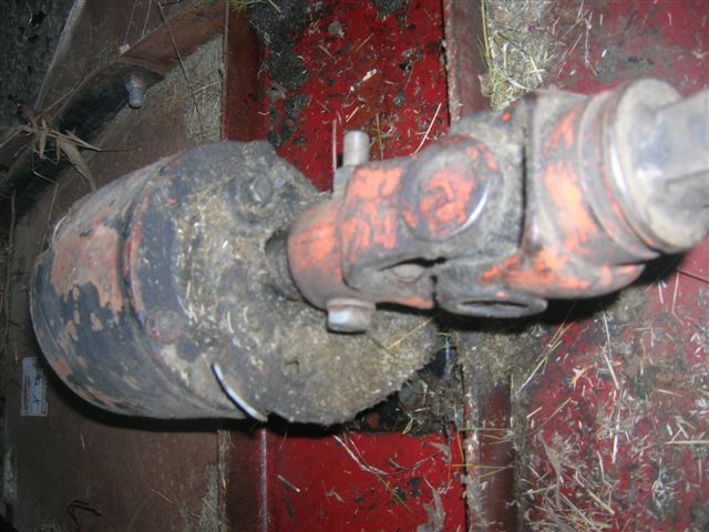

I have a older brush hog that I bought used a while back. I used it to cut and it worked fine. I got it out yestersay to cut a path to move some cows through and about half way through it I noticed it was not cutting good. I inspected it and the drive shaft was spinning fast but the blades were just barely turning. I am thinking I stripped a gear, but I have heard that some hogs have a "slip clutch" type device. Could this be the case and I need to "reset" it some how?

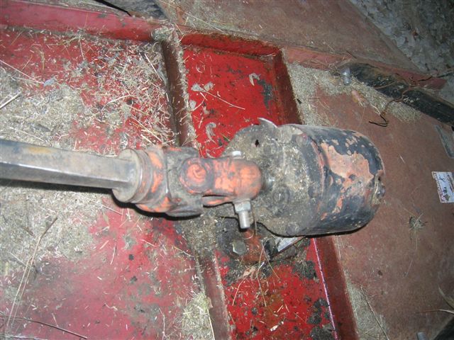

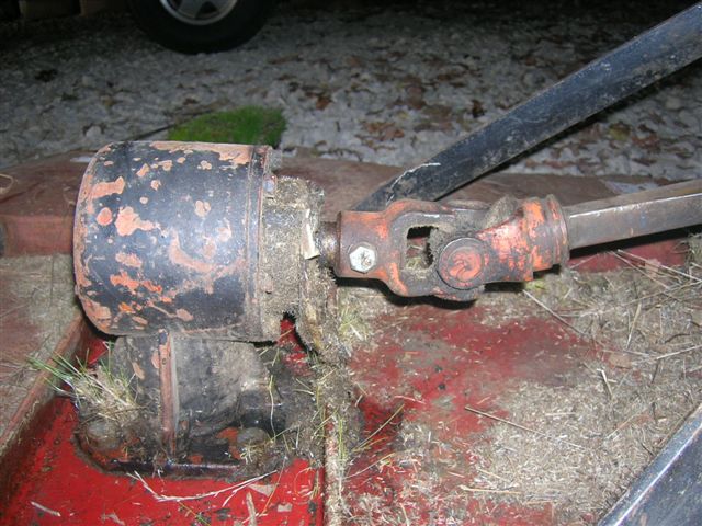

   / Brush Hog Broke???
Here are some pics of the setup...
   / Brush Hog Broke??? #9
No slip clutch there. Is the input shaft on the gear box turning with the driveshaft? (Round shaft that points forward from gearbox and connects to PTO shaft) If it is, and there's nothing turning under the mower, you might have gear box troubles. That shear bolt looks rather substantial. Good chance the gears went south instead of the shearbolt breaking. It may just be an optical illusion, but it LOOKS like there's a little twist in the PTO shaft. That would indicate that the mower has seen a fair amount of "torture". What sort of tractor are you using? (How much horsepower are you turning loose on the gearbox?)
   / Brush Hog Broke??? #10
I agree with Farmjunk. Also I would replace that driveshaft. They don't tend to lenghten and shorten when torgued or bent. Could cause you some expensive damage to the tractor when picking the unit up and down.
