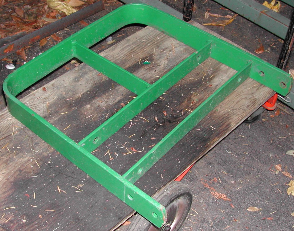

Does anyone know if a brush guard or hood guard can be bought for the 790. I looks to me like it is part of the loader package. I cll Deere and they could not find that one came as an accessory for the 790. Any help would be appreciated.

Don't have a loader, just wanted guard to protect machine from sappling, etc.

Someone just posted a pretty nice looking one made from parts of a forklift guard. He used the weight bracket that bolts to the front of the 790 as a base. I'm not sure if the guard on the newer loaders stays with the tractor or the loader. Can you weld, or have access to a welder-buddy?

Check Hood Guard (770 790) Code BW15350 $210.00 with your dealer

HEIGAR:
The JDs mount their brushguards to the FEL frames, but they can be
purchased separately. This photo is of one that goes with the 420 or
430 FEL, the series that came after the 60/70 series and before the
200x/300x/400x series.
I bought it with the intention of modifiying it for a non-JD tractor, but
I started from scratch instead. Anyway, without a FEL, you will have to
customize some backets to mount a brush guard. PM me if you want
this guard in JD green (cheap).
