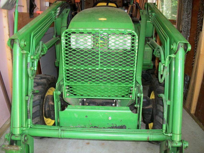

Had my first mishap with my 855. Needless to say, after the cost of getting everything back to the way it should be, is there a brush guard that fits an 855? Or should I get someone to fabricate one for me?

Added a heavy mesh screen to the guard that came with the 4300. That screen was added after punching a stick through the light mesh dust screen from the factory. Missed going through to the oil and coolant radiators.

A whole lot like beenthere. I had a young fellow weld this up on the existing OEM brush guard. It's expanded metal. It folds so I can open the hood.
