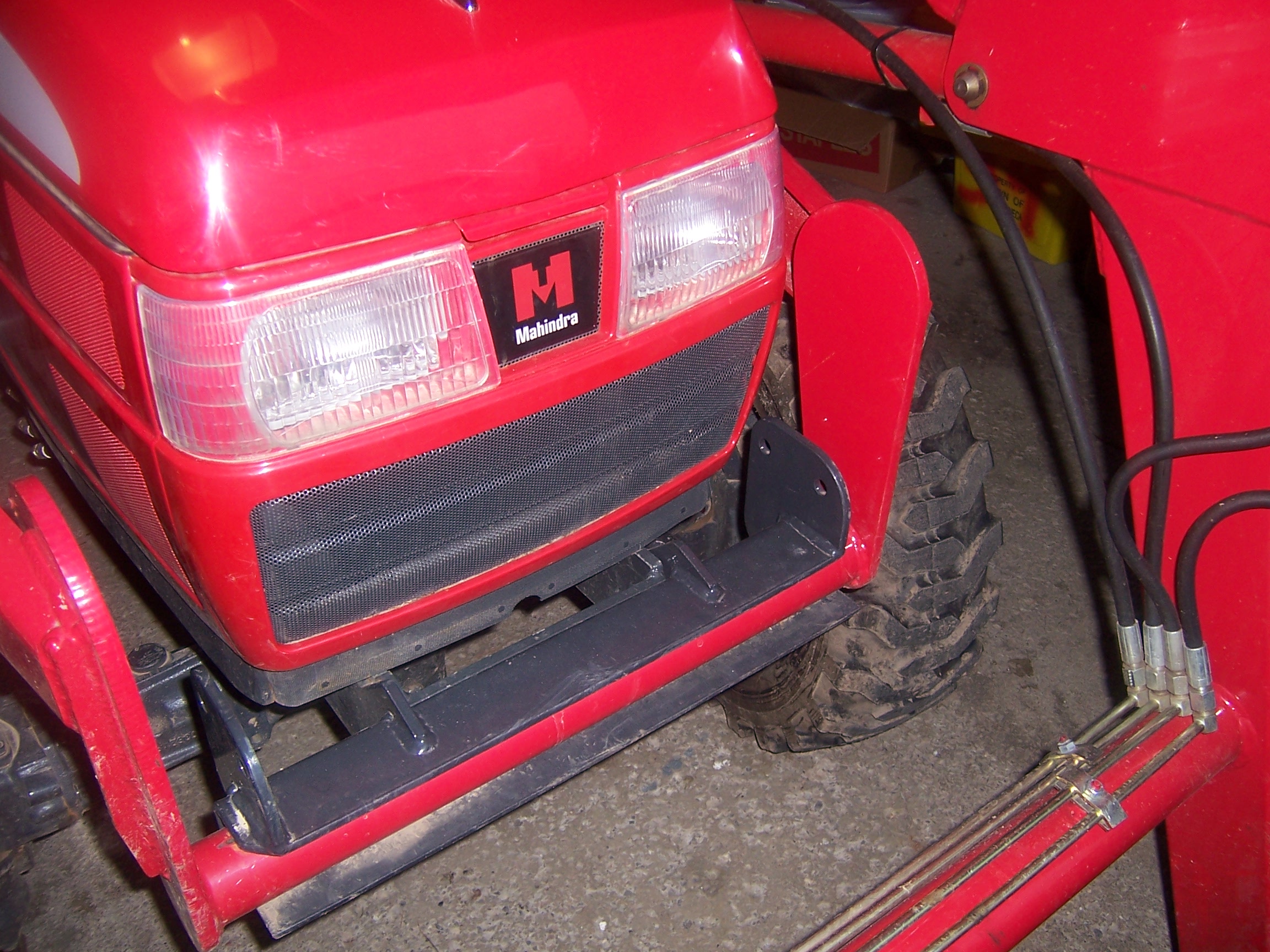

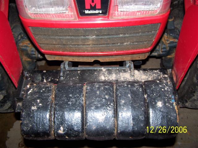

My 2004 2615HST front bracket did not come with the extra tabs welded on for mounting a brush guard.
A friends 06 2615HST did come with the tabs to bolt on a brush guard.
I did however weld on some brackets to support some extra front weight (see pic). Those weights stick out 11" in front of the front support bracket and my loader clears with no problem.
If you are handy you could build your own that would clear.

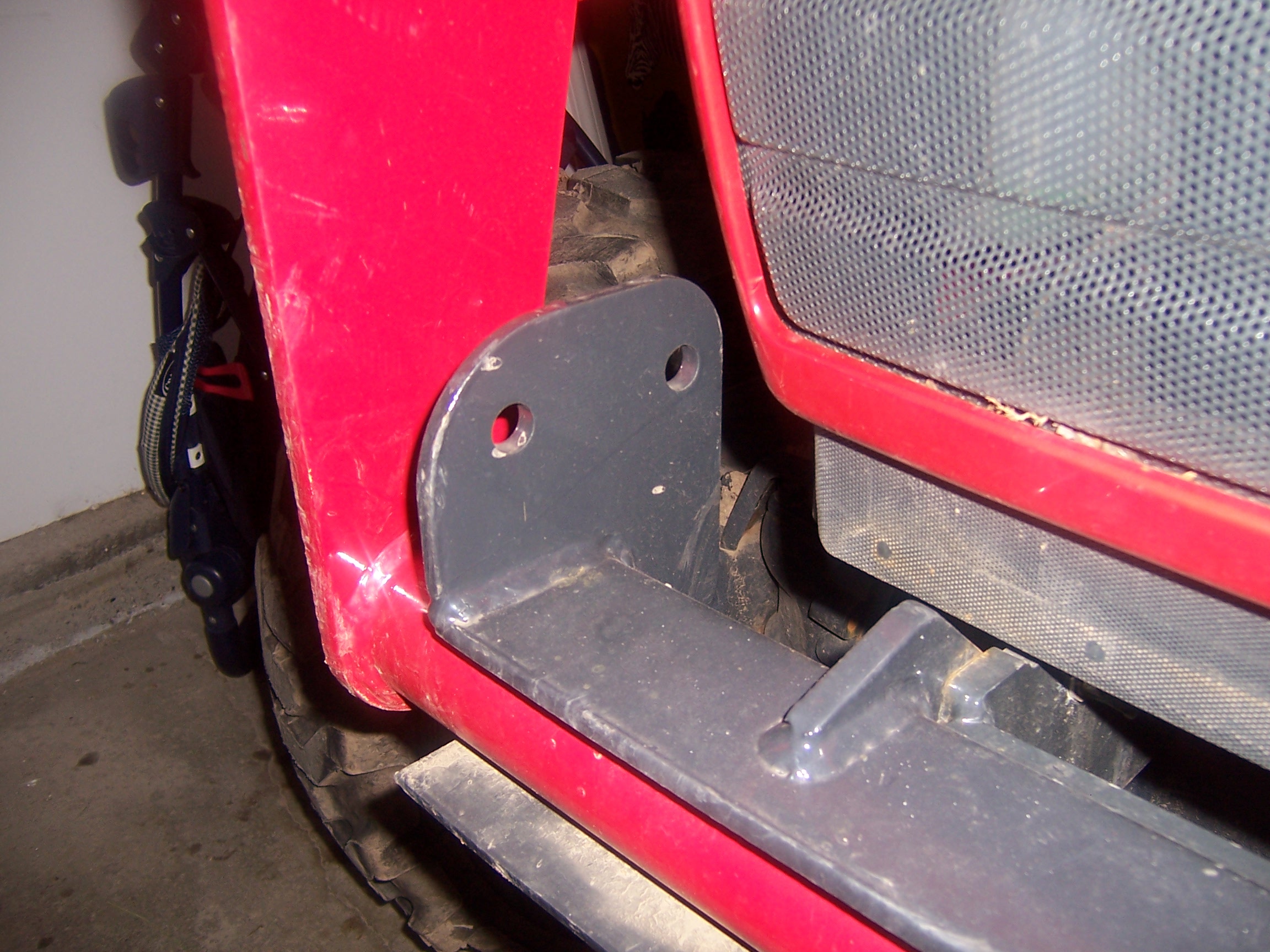

Here is a pic of what i have. Wondering if these are the tabs you would bolt to?

Yes, those would be the tabs you bolt the brush guard to, whether you buy or build. My 04 did not come with those tabs. If you look close in my previous pic you won't see them.
   / Brush guard for 2615 #7
1590-2039 is the part number for the grill guard you need.
