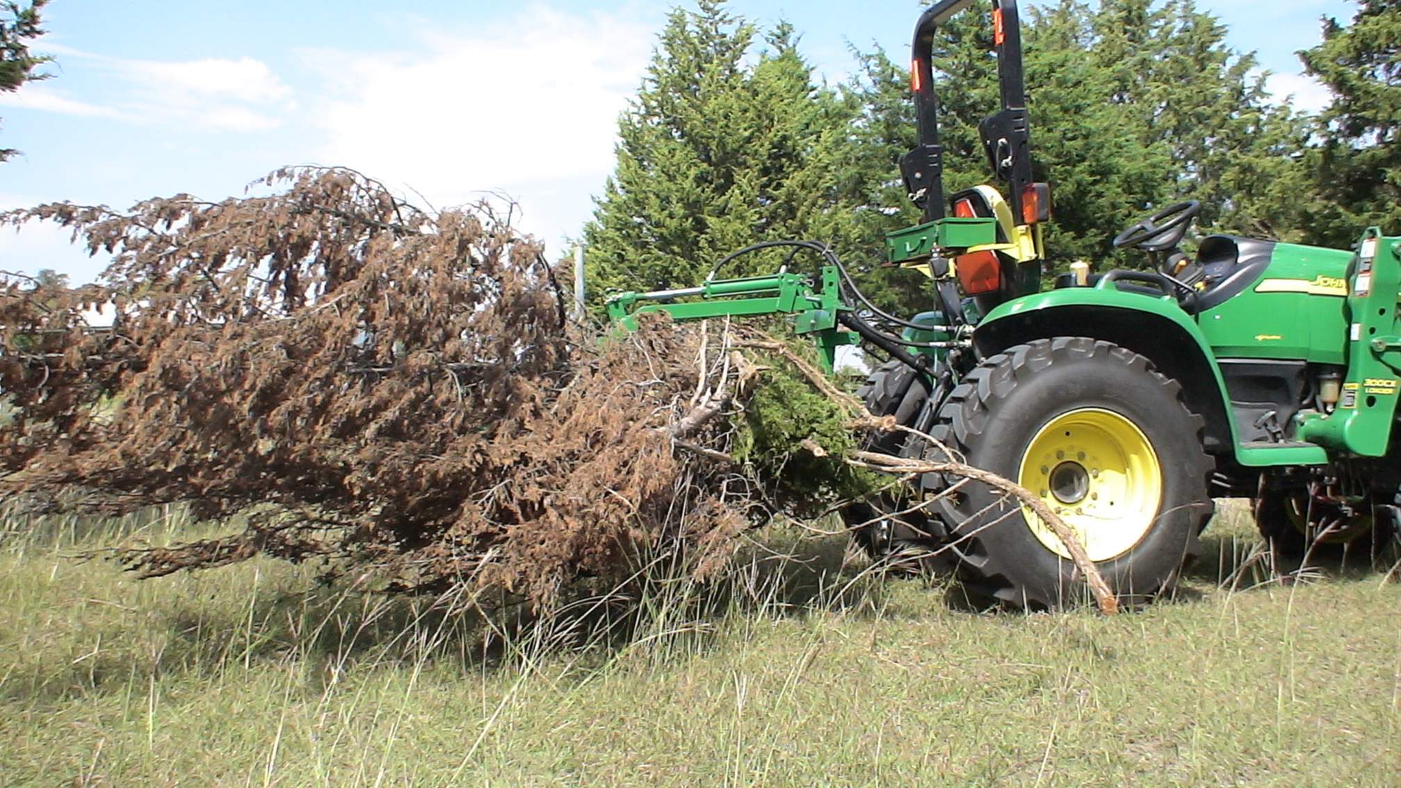

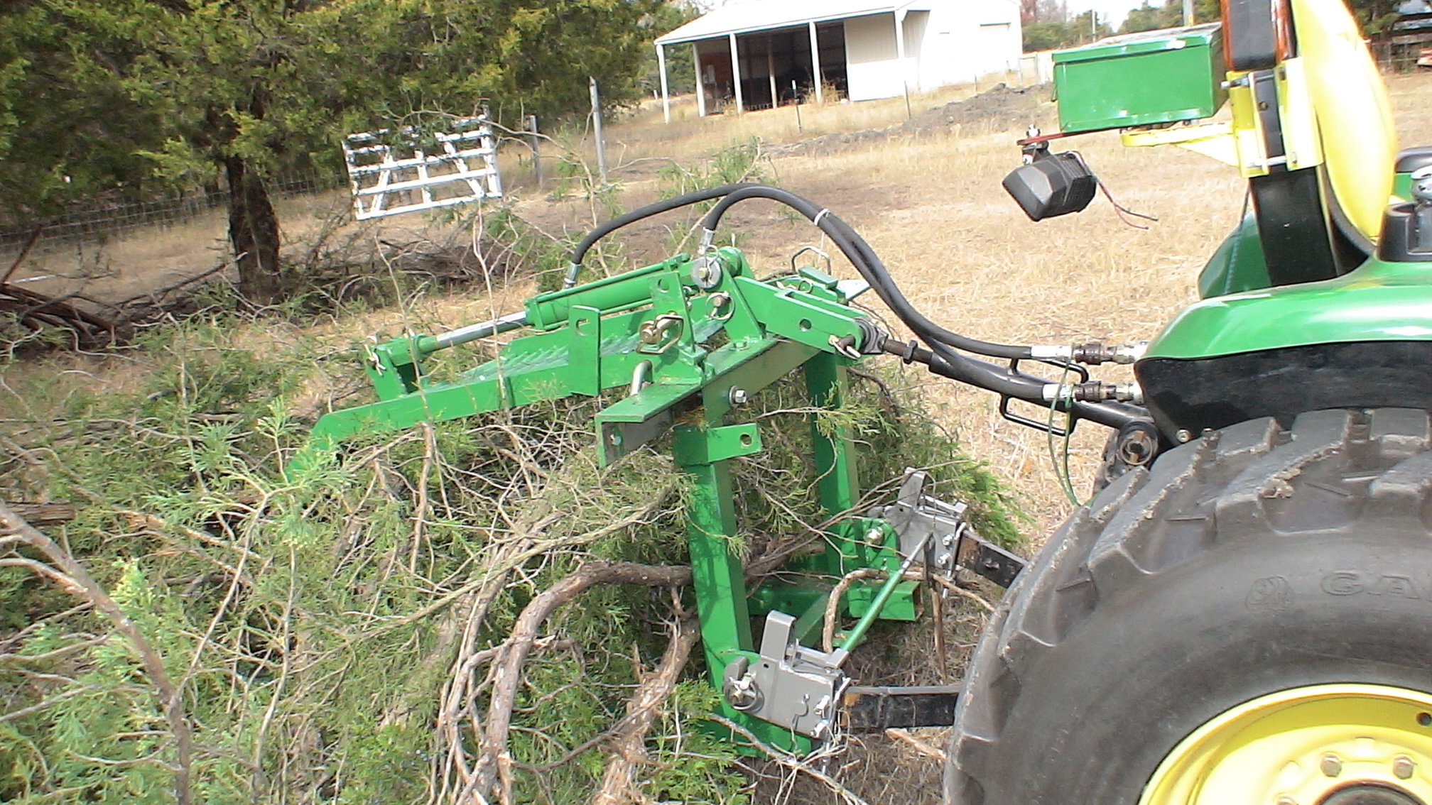

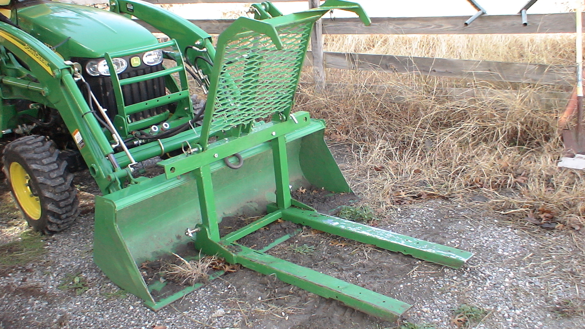

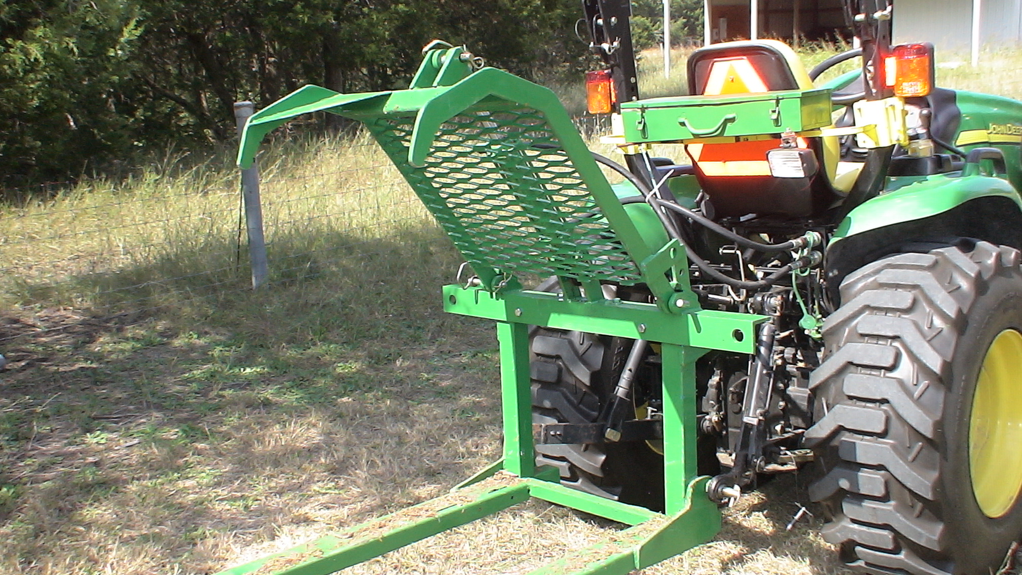

Here one I build on to my forks, can use it on loader or 3pt.
