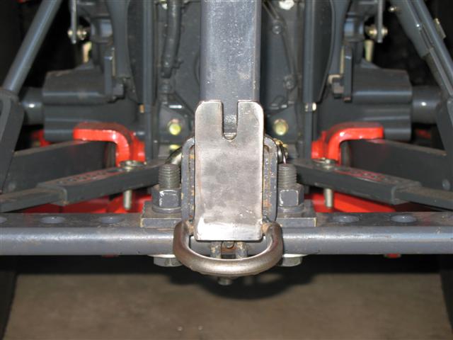

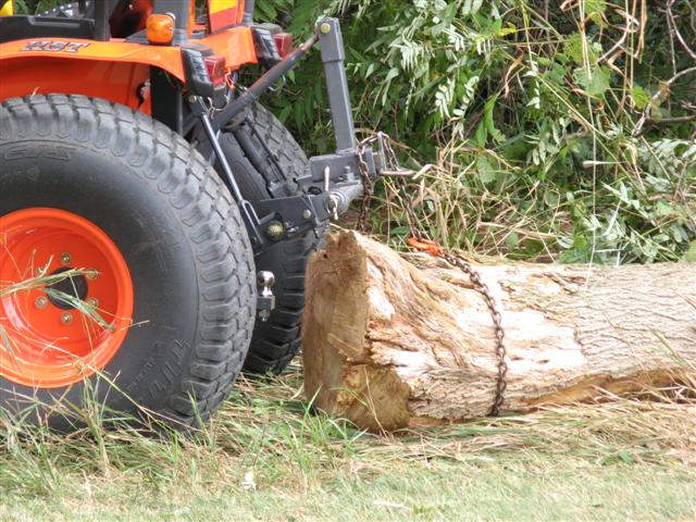

For pulling brush I use a 5/16" chain and the logging hitch I made for my 3PT receiver hitch. Gets all the slack out of the chain and allows for a close hookup to lift whatever I pull.

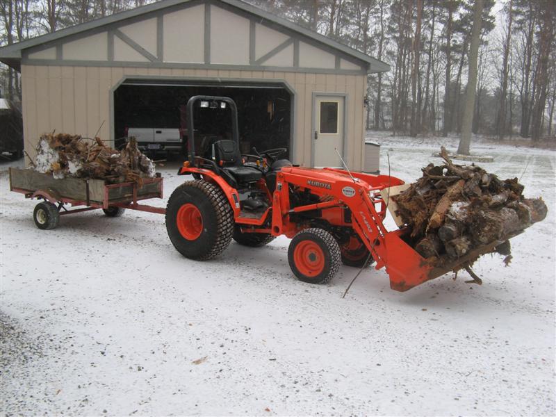

For pushing brush and loading it I recently made these brush forks for my loader. Really adds a lot of capacity for lightweight, bulky materials. I have been using it to clear out the deadfalls from my woods this winter. Turns the loader in a much more usefull tool for that kind of work. Good luck.

sweet set up on the forks, could ya give me some close up pics of those when you get a chance and size of material. good plan !!!!

Thanks. In the Kubota O@O section I have a post called "Brushfork Mod for my B3030". It is on page 3 right now. A couple of clarifications to the materials list is (1) The size of the steel tube along the back of the bucket. It is 1.5" X 3". (2) The actual lenght of the 4" channel is 38.5" from the tube. That makes the forks protrude from the bucket 24". If you have any more questions feel free to ask. Hope it helps. Ice storms sure do make a mess.
