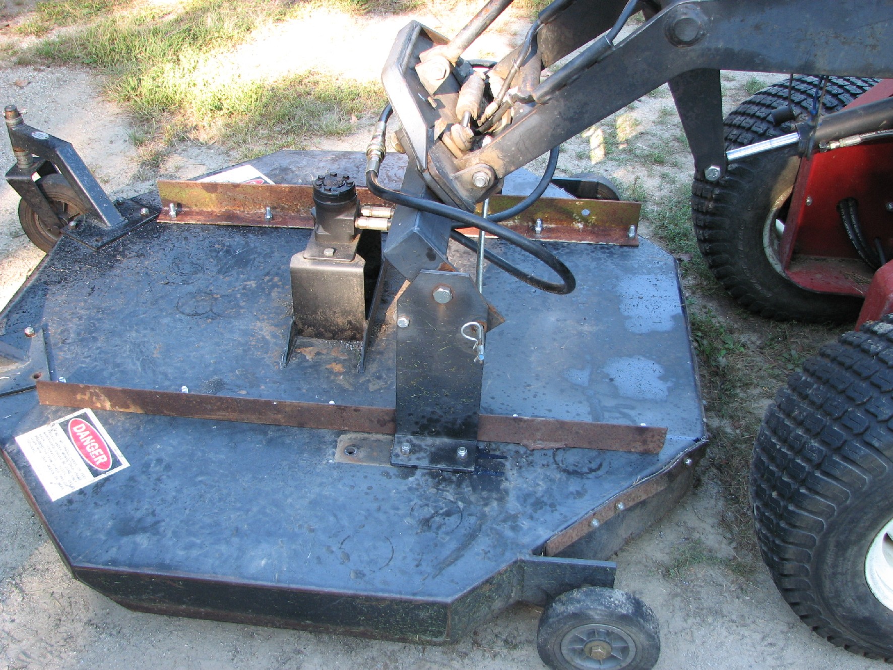

I am thinking about a 48 Brush Cutter for my PT425.
I have seen a homemade guard mounted on the back which seems like a VERY GOOD idea!
So, I have two questions:
1 - What has been the groups experience with things shooting out the back of the bush cutter?
And
2 - Have you mounted a rear guard/deflector on the Brush Cutter?
Thanks

I once threw a baseball sized rock out the back while I was articulated and it bounced off the back tire and hit me in the ankle. I wasn’t injured but it hurt like ****. I made a guard on one brush hog from a piece of thick rubber conveyor belt.

Most large debris shoots back out the front, in my experience. I've shot softball sized rocks an easy 50 yards with force. Large pieces of wood, too. If you keep the deck down on the ground, on the wheels, what mostly comes out the rear is clippings and sticks. Lots of sticks. It'll pack up the front of the tractor, get behind the FEL lift rams, down the center tunnel where the hoses feed through, and into the wheel motor boxes, the left side more than the right side due to rotation of the blades.
I don't see a need for a guard on the rear of the deck and I would most likely damage it. A rubber shield over the hoses on the front of the machine to keep the debris off the hoses and out of the tunnel would be most useful.
As for lifting the deck up high and dropping it down onto brush, yes, I do it. But it seems extremely dangerous. More times than not, I'll shut off the deck, and then just use it's weight to crush down bushes and shrubs, then back away, lower the deck to a safer height, fire it back up and destroy Destroy DESTROY!!!! :laughing:
I have seen your guard and reinforcement. I think they are both good ideas that I may just do when the brush-cutter is new. Or if I can get one used.
