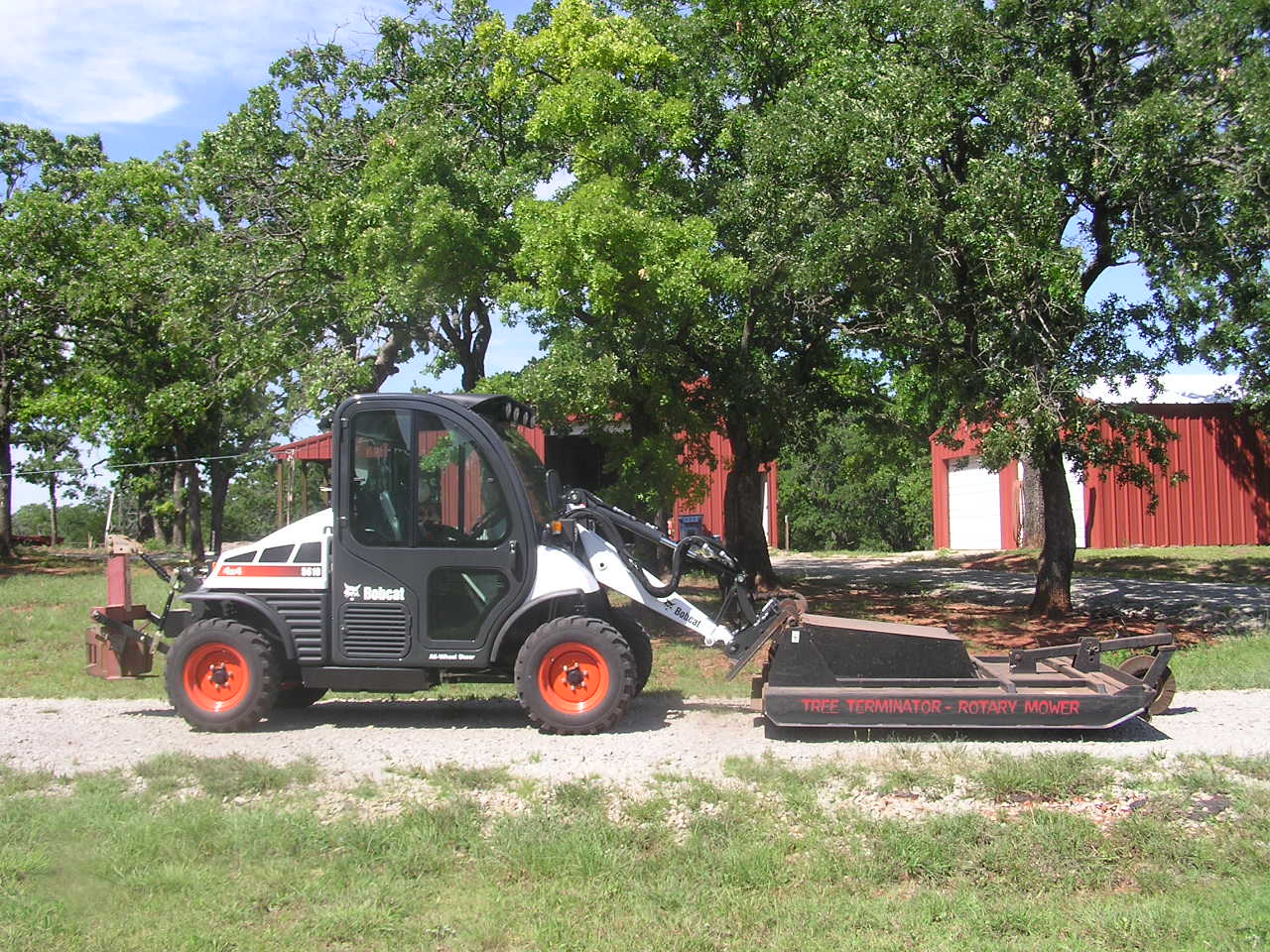

Ours is standard flow and does not have a case drain: Tree Terminator Rotary Mower - Grace Manufacturing (skid steer mower)

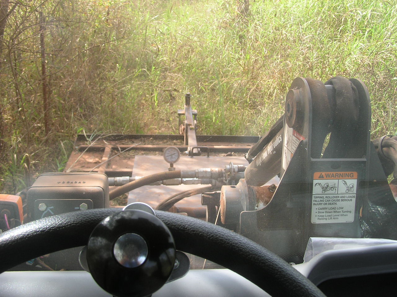

I put a pressure gauge on a tee with connectors:
Can see it from the seat:
It was interesting to watch, but I can hear the pressure relief at the hydraulic motor open if going too fast when it gets into thick brush.
