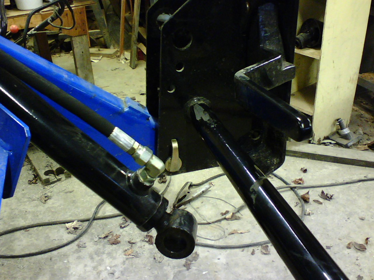

This is definatly ME Not a warranty issue. Put a toothbar on my bucket and a Thumb Grapple. I had just finished a brush pile move and was poking at a pile of dirt that had been under the brush pile for about 10 years. Backing out with I noticed the QA on one side had popped out. Although I had never had that happen in 11 years with my 1320 I though oh well I did not latch it. Wrong. Little more than hop off and relatch. BENT.

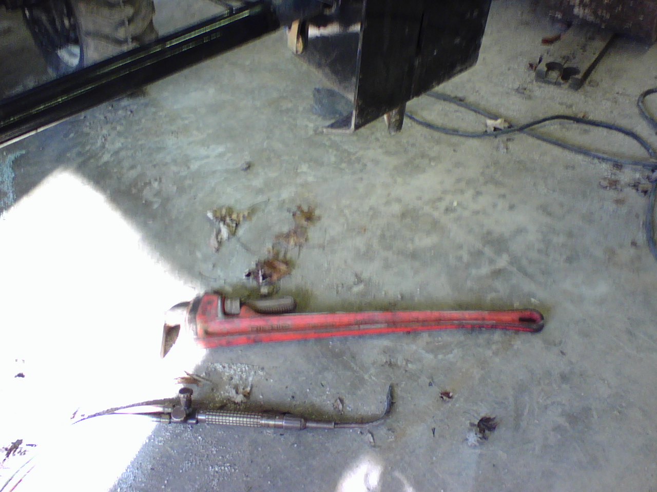

The torque tube that connects one side of the QA mechanism to the same mechanism on the other side does not quite make it. It took a while to figuire out which side twisted. From the tractor seat the left side was twisted back about 1/2 inch. You can see it in one picture and in the other you can see where the paint popped off the tube. I blocked the good side and used the curl hydraulics to pull the other side back. Forgot to save the picture in my cell. After a couple of back and forths and running the revs up I got it all straight bit of course it won't stay there. I put a 3' pipe wrench on the tube to try and kick it a little . Forget it. So now I am typing while I think a littel more. I am thinking about heating the tube with a torch, oxy A, and then applying a little hyd pressure. Then maybe welding some beefy cross tubes in place. If I screw the whole thing up I can just get a new QA fron Direct Attach.:(

I read posts for a while thinking and I think before I heat up the tube I am going to bounce it back and forth with the hydraulics . Maybe it will inch over.
I meant it was bent forward. The QA popped out on the right and the left one took the whole load.
SO blocking the right side short of full stroke allowed the left cyclinder to pull it back. Just have to kept it there.
Looked at Attach Direct over $1000. Guess Iam going to fix this puppy. I had taken the cylinder off to see if I could get something on it to bend it . Forget it.
I will post picture of the blocking tomorrow

Fixed Blocked it, Heated it up Started Tractor Curled. Ran up RPM curled some more. 3 times perfect. The tube is hot rolled steel. I could tell from the scale under the paint. I don't think heating and cooling makes any difference. I think the comments in another post about two cylinders and do they run even was hanging arouns in my sub concious (?) . I had to stop to help my wife with apple sauce making but I will get some paint on the tube later today. Also I am still thinking about adding a tube . I have some 2 x 3 tubing around that would add some stiffness with out a lot of weight. But maybe I will just make sure the latches are set.:) :) :) :)
Andy the Tach all was what I had on my 1320 for 11 years. Never had a problem. But then 34 HP is A LOT more than 20 HP
Notice the bent blocks Aluminum thats what I had around that fit. Whats the use of hydraulics if you can't make it work for you. Plus I am by myself ,makes it hard to hold three things in place at the same time. Would have been nice to have someone holding the tape maesure while I was curling.

Neighbor down the road damaged the QA on his TN70D and we couldn't get it realigned with a torch. We finally cut the tube in the center reattached the QA to his bucket to hold it square re-welded the cut and then strengthened the tube with heavy angle iron. It's worked well since.
I always lift the attachment to be sure the QA pins extend down through the QA plates before putting the attachment to work. It is possible that mud or even a stone will prevent the correct mating which will put undue stress on the whole QA assembly.
