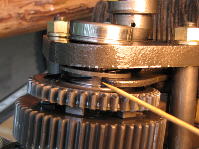

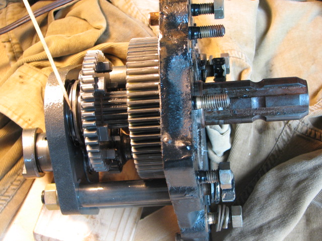

Well i pulled apart the PTO today; the only thing broken or damaged i can see so far is that a thin metal ring (a keeper ring of some sort?) was spread/broken/twisted and out of place (see photo # 2635).
The whole PTO shaft had slid forward (toward front of tractor), apparently because the forward bearing (near top center in the photo) had slid out of its bore in the casting. You can see the forward bearing out, slanted and above the plane of the casting near top of the photo (sliding forward equals sliding "up" in this picture).
There is a groove in the outer race of this forward bearing. Seems like it might be for a circlip that would prevent the bearing sliding forward this way, but no circlip was present, nor did any appear to be lying in the transmission housing.
The split/twisted metal ring (near the point of the bamboo skewer) seems too thin to have been a keeper ring-- too thin for the width of groove in the bearing. (The groove is visible near the bottom edge of the bearing, above the plane of the casting in the photo.
In photo #2645, I have slid the bearing back partially into its bore, and the point of the bamboo skewer is resting in the groove.
In photo 2642 is the receiver cap with seal (looking at inside face of cap). When the shaft slid forward during the incident, fluid leaked around it past this seal.

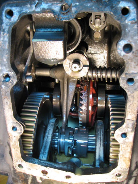

Photo 2632 is inside of the transmission, after removal of the PTO unit

1) if there should be a circlip for that groove, or if not, how is the PTO shaft held from sliding forward through the bore as it did.
2) what are the function and proper location of the existing damaged thin ring
3) what else, if anything, i should check. (The bearings, gears, shafts, and everything else i can see looks undamaged and untouched.)

You are pointing at the retaining ring from the bearing. Have to wonder why it came out. Any big impacts on the pto? May be an H6207snr bearing. If the ring is to thin for the bearing it could only be from the bearing turning in the housing and wearing the ring down. I can't tell from your pictures if it has turned in the housing. I'm assuming not if you believe it to be ok. I would examine the bearing and ring closely and make a decision of whether it needs replacing or not. The ring is what keeps the bearing from going forward. By the way, that is an excellent picture of the differential lock, very interesting.

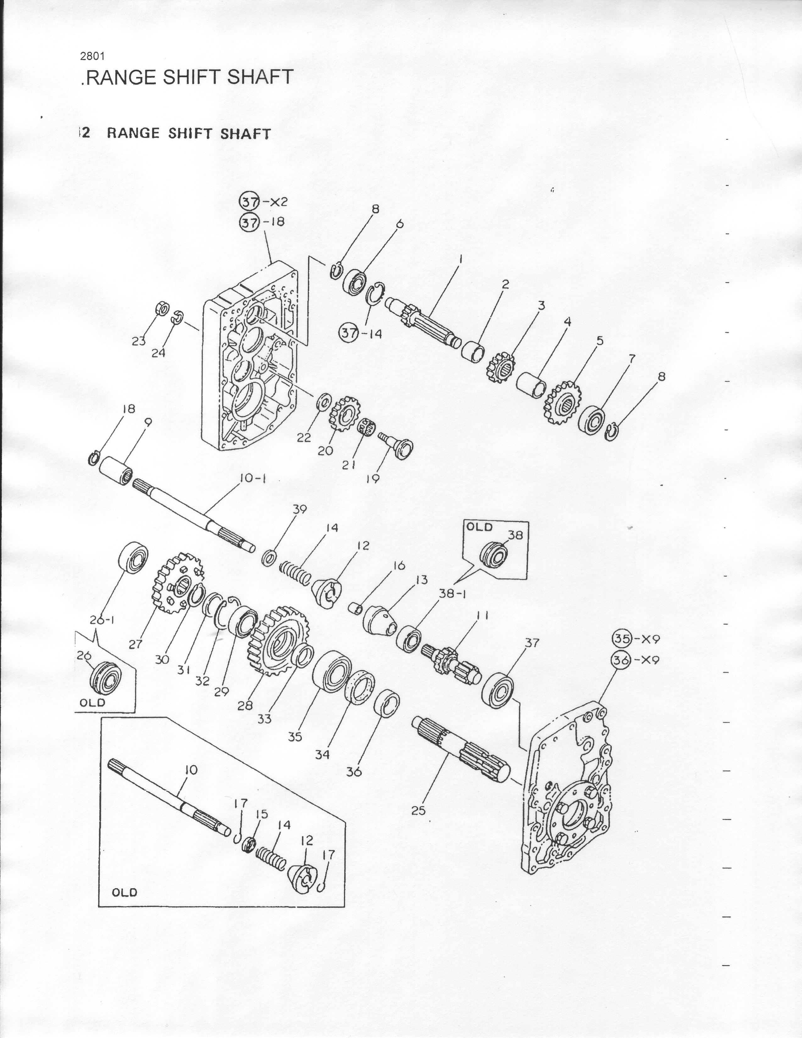

Maybe this will help.

Since you have it all apart I would change both the front and the rear bearings so that you will know you are good at both ends.
