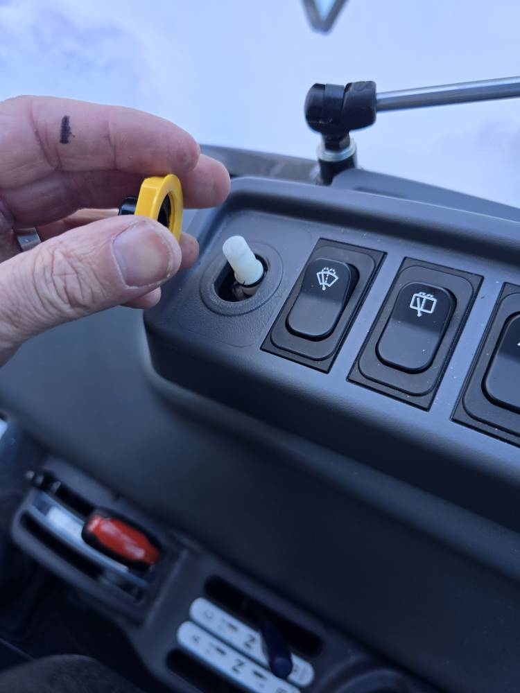

My PTO button broke the other day. Is this a common problem? Seems like a poor design. You shut off the PTO by slapping the PTO button but if you do that when it is cold the button breaks. Cheap plastic junk.
Is there a more rugged option?

Yep mine broke on my NS4710.

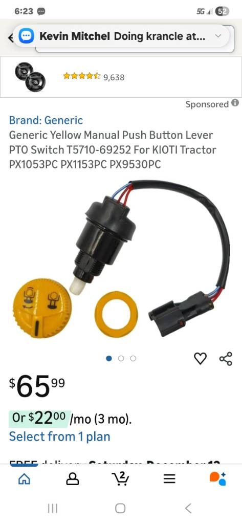

I think i am going to convert to this type. Cheaper and probably won't break so easy.
/ Broken PTO button
I ordered this yesterday. Its way cheaper, not cheap plastic, and the same diameter.

Search Starlight Tractor Parts on eBay. He makes replacement parts

I've been using mine with the broken switch for 2 years now. Major PIA turning pto on and off by having to pinch that broken off nub. Haven't had time to replace it yet. I did get a new one from the dealer.
Not a fan of these type of switches. Wish it was a simple rocking switch. No idea why it has to be this type. Absolutely no benefit.

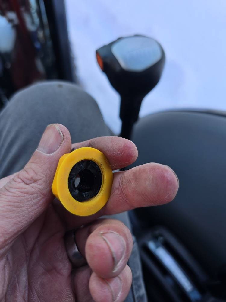

Is there a more rugged option?View attachment 4509459View attachment 4509460View attachment 4509461
I just fixed mine. The switch worked but the ring would not hold the switch in place. I took the switch into the hardware store and matched it up with a 7/8" snap ring. I also got a bushing, I think a 1" bushing for added support. I cost about $2 for the fix. Remove the 3 screws securing the gray plastic tray, hold the pto switch in place. Put the bushing or flat washer in place then place the snap ring on it with snap ring pliers. It works great.
