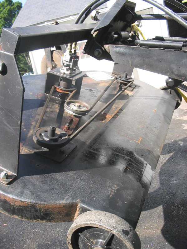

Got the new belt from PT. Does anyone have a picture or diagram of how it is wound around the pulleys?
Thanks
   / Broken Mower Belt #6
Maybe this look at the 60" finish mower for my 2001 PT-425 will help...
