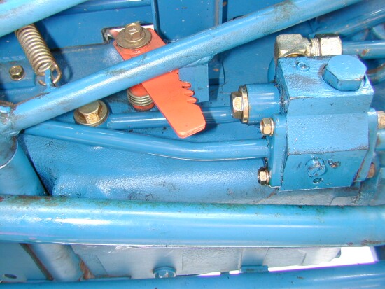

Not a good tractor day today. Couldn't get my mowing job done today (actually couldn't even start it), as promised. Had front flat due to a nail /forums/images/graemlins/mad.gif /forums/images/graemlins/mad.gif, tubed tire to boot /forums/images/graemlins/mad.gif /forums/images/graemlins/mad.gif. Then right after I fixed the flat, I had another hydraulic leak /forums/images/graemlins/crazy.gif. Fixed a loose fitting last night.
Attached is a photo of the tube that is broke. It is the pipe that runs behind the the parking brake pawl. The left side (as seen in the photo) is leaking right at the point where it is welded to the "banjo" (where the bolt goes through). The other end attaches to the hydraulic block to the the right of the parking pawl. I'm lucky in that it is just a return line to the sump. What happen was last night I noticed a leak on my trailer. So I traced it to a loose return line from my loader control valve to the manifold block. So I tightened it. In doing so I also noticed that the bracket that holds the block in place was loose, tightened that too. Cleaned it all up and looked like a good fix. So I figured the vibs must cause the tube to crack. At first I thought it was the seal was bad on the banjo fitting. But it was odd because the more I tightened it the more it leaked!
So... is there a temporary fix? I would like to J-B weld it but I can't keep it dry long enough to apply it. Are there any other ideas? I WILL be ordering one right off tomorrow, but looks like a special order part. It would really be nice to use the tractor while I'm waiting.

Close up of the crack. That is with the bolt snug, not tight. With it tight the crack is larger which makes it leak faster.

For a temp fix, (Only on a No pressure line) try this epoxy… you can pick up at any WalMart (different brand name) in the Marine accessories section… a tube costs about ~ $3-4 ? (all different prices…as low as 50 cents)
Wire brush the area for better surface adhesion, knead the clay like epoxy substance and mold it into place… should be able to use ~ 1 or 2 hours, but I’d give it overnight… and maybe go over the surface again with another layer or two…
Pliable epoxy

Thanks for the help JM3. Unfortunately I couldn't find anything local (the nearest Walmart is 65 miles away). I did however order the new part. Should be at the dealer (right near the Walmart) by Teusday afternoon. Cost $60 for the pipe, $20 for priority shipping. Install should be easy, the hardest part will be catching the hydr. fluid.
/ Broken Hydraulic tube #10
Derek, if you have the part off, couldn't you get it welded/brazed for less than $80? ...just curious /forums/images/graemlins/confused.gif

I could have my father braze (I'm not good at brazing /forums/images/graemlins/crazy.gif) it without to much trouble. But I will loose most of hyd, fluid once the pipe is removed. So I just have it new and HOPE it doen't give me any trouble. If it does the old one will be fixed up and kept as a spare. For me having the tractor down is very inconvienent. I do work with the tractor on the side. So when I have do a job at the end of a long "regular" work day the last thing I want to do is repair before moonlighting

I suspect that's just a bad braze from the factory. Should be an easy fix.

Replace the tube last night. Wasn't that tough. Lost about 2 quarts of fluid during the replacement of the tube. New Holland must have changed the tone of the blue to a darker "fuller" blue? Hope I don't break too much more stuff or I'll have a 2 tone tractor /forums/images/graemlins/laugh.gif.
As you all know there are a lot odd buzzing, rattling, vibration happening when you are running the tractor. Well with this pipe fixed and the bracket tight for the hdyraulic manifold block, there is a missing noise among the other vibs, buzes, and rattles. Could have been loose for a long time.
